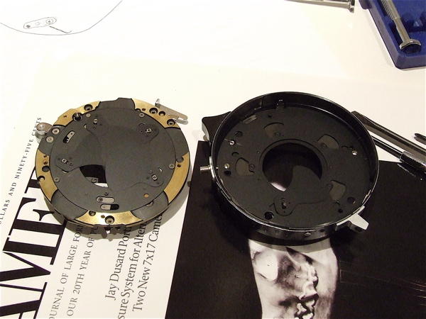

Just don't mess with them using sweaty fingers. I use fine pickups to hold them and move them around. Frequently, if I'm at the point where the blades are free in a repair, a stray fingerprint is the least of my worries. That is, the less manipulations of the blades, the better.
