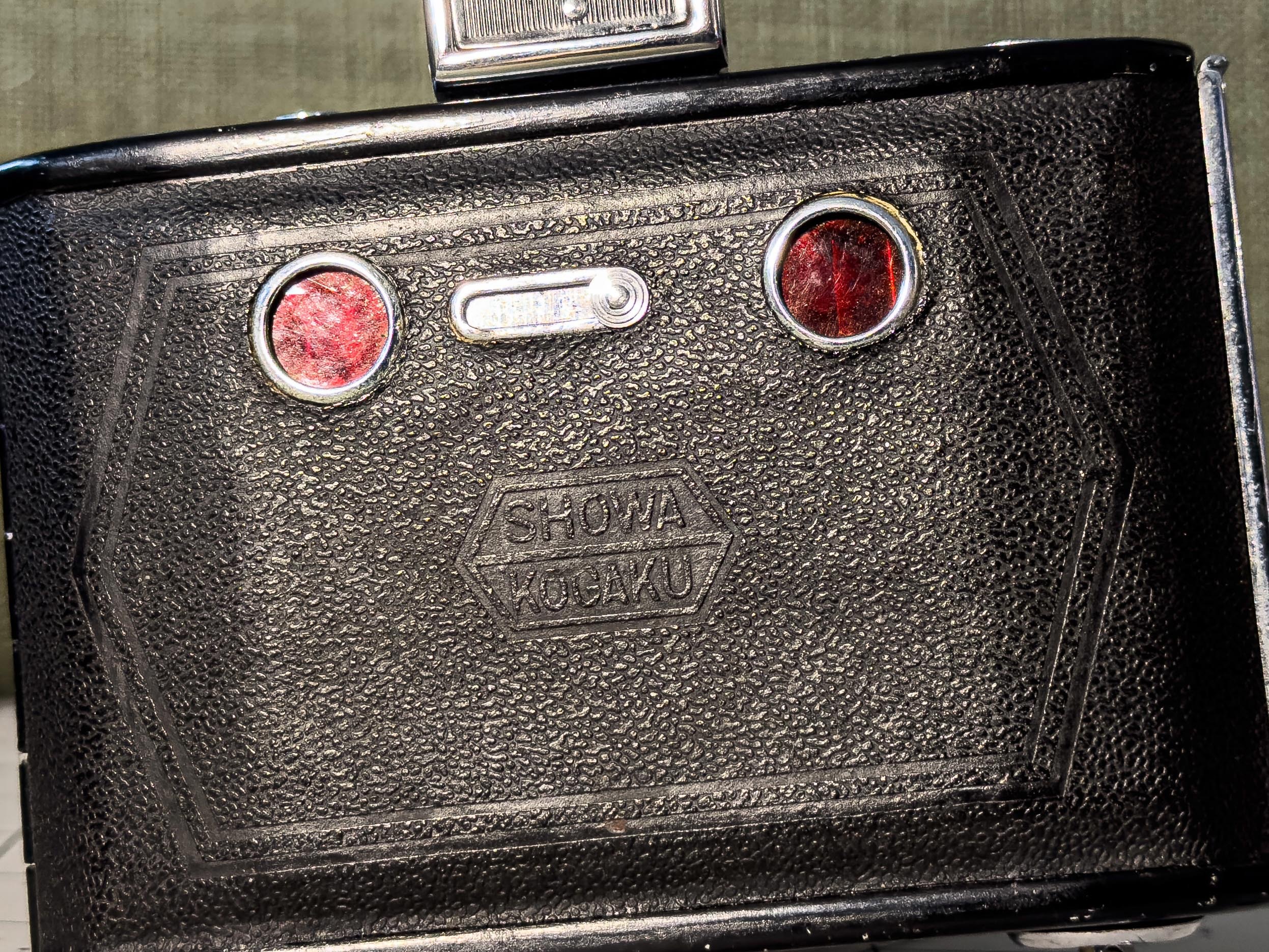

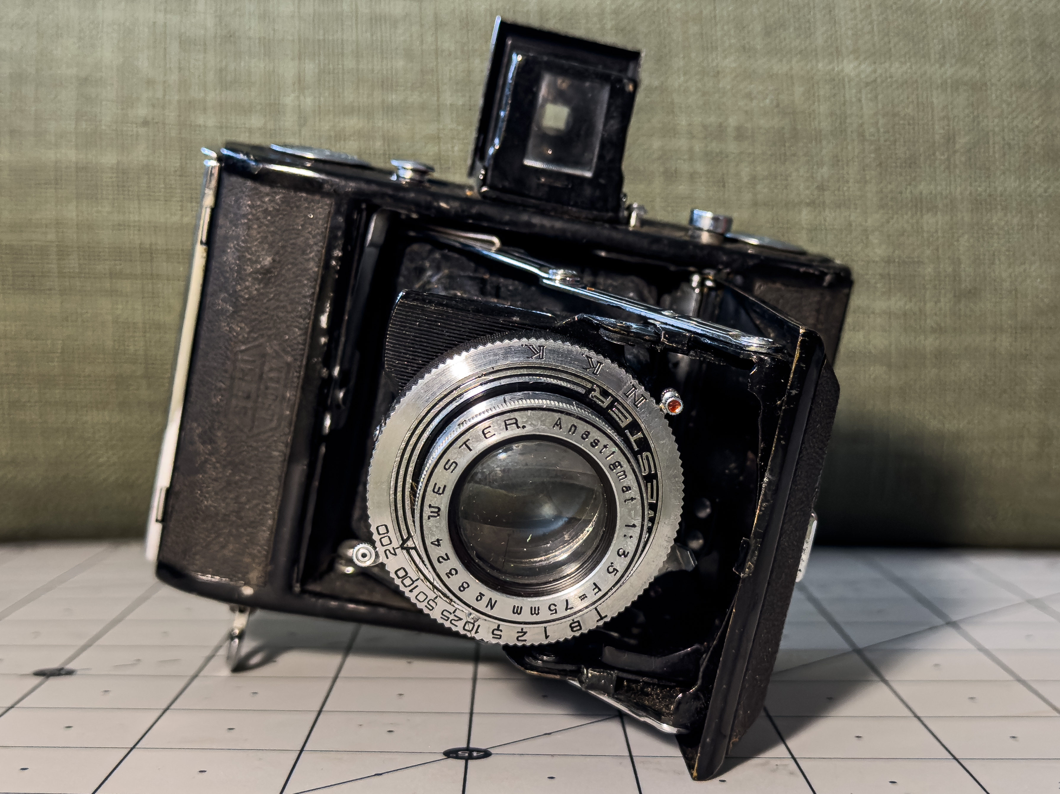

I was doing some reading today about an old occupied Japan camera that my great grandfather had.
It is a Shoya Kogaku Semi Leotax with a Wester 75mm Anastigmat lens.
I was hoping someone might be able to help me further identify it.
The Camera wiki claims that there are no known samples of the original model which had a manual film key and 2 red windows on the back. This one has these things and does not appear to be the newer version, as those only had one red window in the back.
Thank you!

I don't think this is the original, wartime model of the camera, in particular because in the photos of the camera posted at Flickr, it has a CPO stamp in the frame of the viewfinder.
Code:
https://www.flickr.com/photos/restlessreel/53500787885/in/datetaken/
The stamp is <シピオ> : that's 'CPO' rendered in Katakana characters
- see the wiki page
In fact that wiki page has a photo of exactly that stamp on a Semi Leotax.
That stamp means the camera is definitely from the period of US occupation of Japan, and the wiki page suggests 1948-9. You also see <CPO> and <EP> on other cameras. I have a Waltax Junior with <EP>, from maybe 1950-52.
Those stamps were to help control the different taxing of domestic and export goods in occupied Japan, apparently.
In addition, the wartime camera should have a Riese-Anastigmat for a lens; this one has a Wester.
I think the camera is from early in the post-War recovery of production. The great thing is that 120 film hasn't changed in seventy-five years.
I could not find this claim on Camera Wiki. Here's what they say:
The first Semi Leotax made after the war are identical to the wartime examples, except for the absence of the auto-stop device and for the different lens and shutter equipment. They notably have two red windows, and other older features, such as the attachment for a brilliant finder on the corner on the front standard, black paint on the finder's front part, the ⅜-inch tripod thread, and the older hexagonal SEMI LEOTAX logo on the leather.

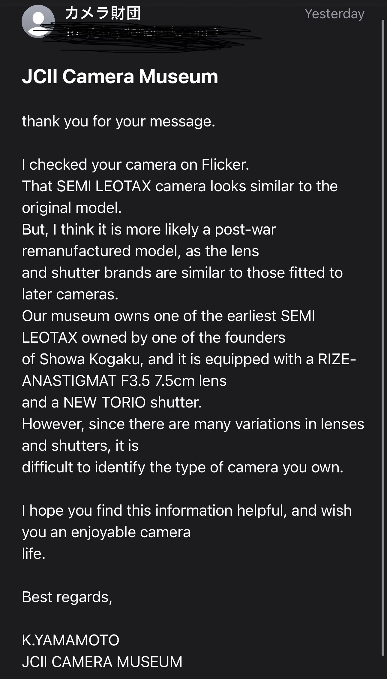

I wanted to share the response I got from the museum. I sent them a fax. And they emailed me back.

In my experience researching most early Japanese cameras, a definite maybe is about as close as I have been able to obtain.
Enjoy using your camera!
