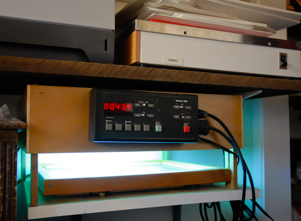

I made this under my workbench. It is a shelf attached to full extension drawer slides under five 30 watt Sylvania 350 Blacklights. They are run through an old school Graylab timer with a klaxon alarm. That thing will scare the hell out of you.
My current contact frame is not what is in the picture, that's just what I cobbled together for the maiden run. Presently I'm using two 24" x 24" sheets of 1/4 inch glass, held together with 8 large spring clamps.
Dead Link Removed
This is a 7 min. VanDyke on Bergger paper made in the unit.
Cyanotypes average around 20 mins and Platinum/Palladium prints are in the 45 min range.

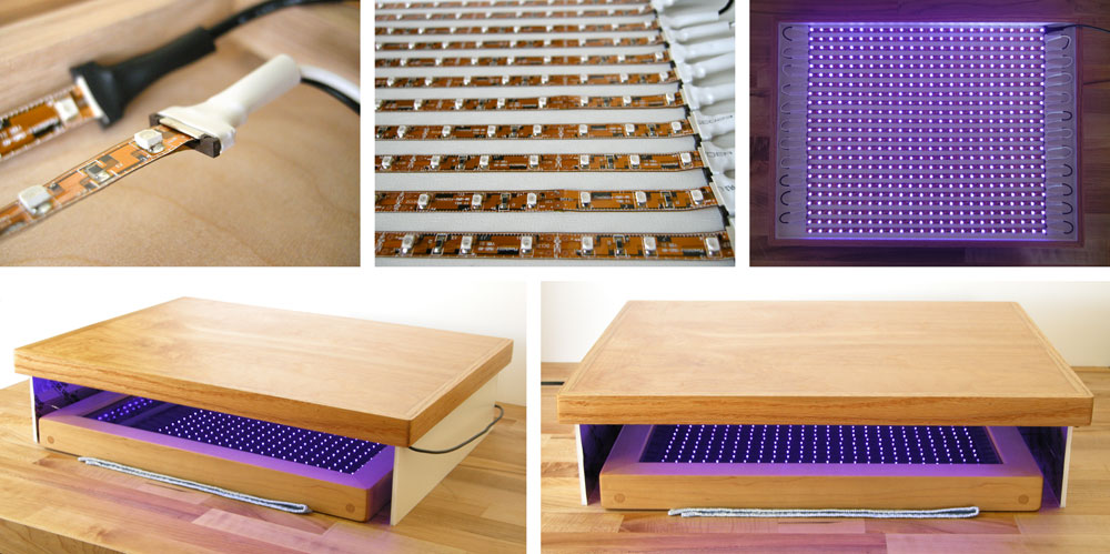

I've got something a bit different. I'm using multiple rows of UV LEDs in a 20"x15"x1.5" box I made. It runs on 12 volts DC via a wall adapter, so I didn't have to handle 120 volt AC household wiring. It's also lightweight--the side walls and back are white foam board lined with aluminum tape to (hopefully) reflect any stray light back to the print. The whole thing collapses down to fit in a drawer for storage when not in use. The nicest part is the LEDs don't get hot at all; after hours of use they're only warm to the touch.
Nice looking unit. What process are you doing and what kind of exposure times?

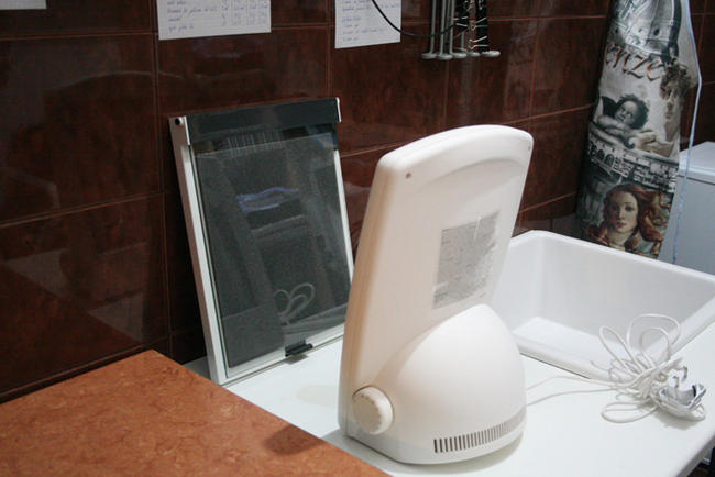

I use one of these.
With cyanotypes and vandyke prints, it gives me exposures of five to ten minutes with unstained negatives, and about twenty minutes with stained negatives.
It covers 8x10" with some room to spare. The contact printing frame in the attached picture is 9.5x12" (24x30 cm).

Jim, I use it for cyanotypes and van dyke brown. I keep meaning to try it with some gum bichromate but other projects keep seeming to conspire to keep me from doing so.
Exposure times vary for me. Generally, for a good full range cyanotype or van dyke brown print it takes an hour or two with my UV box.
My exposure times are based off a Stouffer 21-step wedge. I make enlarged negatives from my original films with Arista lith film and my darkroom enlarger. Densities wander a bit when I do this, so exposure times in the UV box also vary on both sides due to the inconsistencies of my enlarged negatives. For cyanotypes, I can print about a eight stop range with a two hour exposure. For comparison, I get the same contrast range outside in the winter sun with about thirty minutes of exposure to direct sunlight. Van dyke browns are complete (seven stop range) in about an hour under the UV LEDs.
My exposure times compared to others posted here seem long; I don't know if it's my light, paper, sizing, the formulas I'm following or the densities I'm expecting to see.
(Thanks for the compliments Mainecoonmaniac and holmburgers!)

I use one of these.
What kind of uv source are you using. This looks like you store bought this? where can we find out more?

Yes, I bought it. It's a facial tanning lamp. Click on the link I gave above (on the word "these") to get a better look of it.
It was approximately eighty dollars, new.
A google search for this lamp, the Philips HB175, doesn't show any sources for it in the US. I suspect it's not approved for sale here, probably due to the potential UV damage to eyes (including cataracts), but that's just a guess.

It comes with a pair of anti-UV goggles. It does no harm to the eyes if it's used correctly (that is, with the goggles on, at the right distance from the face, and for the right amount of time).
I don't think it's banned anywhere. Most probably it's either discontinued, or sold in the US under another brand (Norelco, perhaps? I don't know). Anyway, the HB-175 is just an example. I happened to find this one locally because Philips products are popular in Romania, but I suppose any facial tanner will work just as well. Like this one, for instance.
