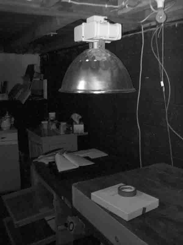

My UV lamp is a watercooled mercury arc (1000 watts) placed about 30 inches from the vacuum print frame. It's a surplus lightsource from a picture tube factory. This pic shows the print frame (made from hardrock maple) for 8x20. I have another frame that's 14x17 out of aluminum. .

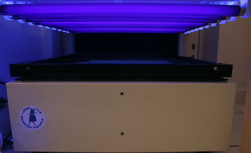

My uv source consists of 9x18w Black Light Blue UV tubes fitted on the bottom of an home made mdf table, the vaccum frame below was taken from a Parker plate maker (20x16") Only made it 3 weeks ago, at the moment i am very pleased with it, exposure times for all alt processes i use range from 4-5 mins.
