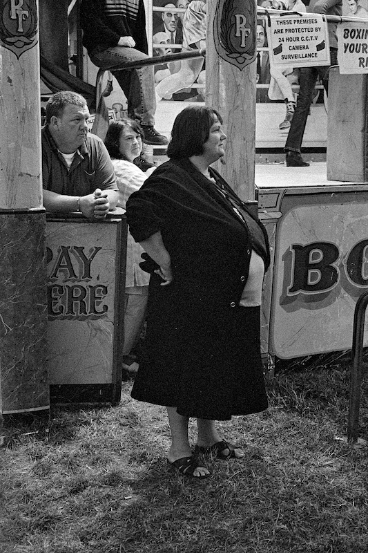

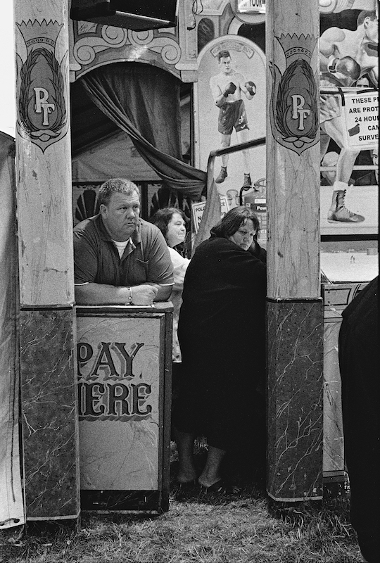

I don't often use Ilford Delta 3200, but I have just a few shots on this film developed in Tetenal's Emofin that I feel pretty satisfied with. It was dusk in a fairground and the lights created a huge contrast range. Because Emofin produced higher-than-box speed with all other films I used, I had set the full 3200 ISO box speed. However, I metered off the better-lit parts of the scene, so the shadows are fairly featureless, although there is more shadow detail in a print than the scanner could pick up. These 35mm negs make very acceptable 16"x12" prints.
I'd like to be able to do this again. However, since Emofin was discontinued I have failed to find any developer that gets the same speed and quality out of Delta 3200. So I'd be really interested to see what others have achieved with this film and other developers. Please quote the ISO and developer used.

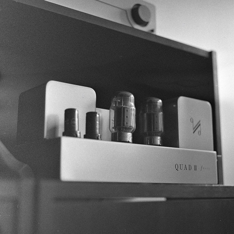

Such a great film in 120. Mind you I have only ever tried 10-20 rolls in total so I can't really say I know it that well. I should try more this coming Winter.
Rolleicord Va TLR w/ Xenar lens - handheld
Ilford 3200 - can't remember the exposure details but must have been 800/1000EI via incident metering with my Sekonic set for zone III in the shadows
Adox Rodinal 1:25 - standard inversion+agitation pattern.
Flat 16bit/channel linear negative scan - gamma adjusted. No dodge/burn or any other local edits.

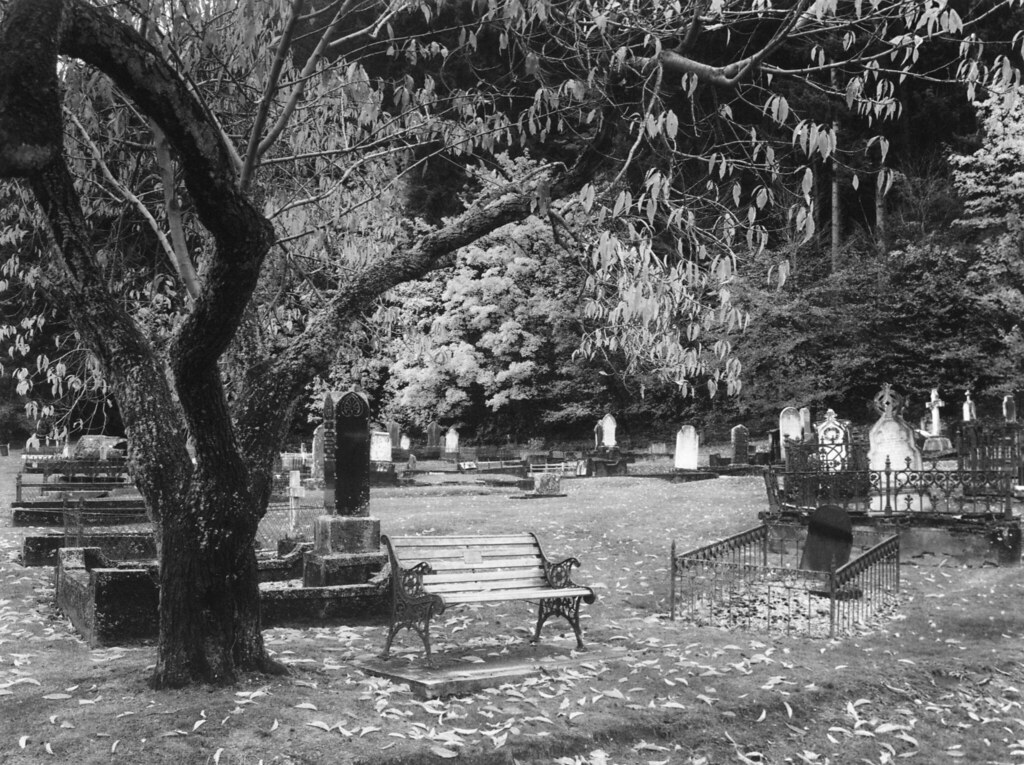

Cemetery, Queenstown
Gelatin-silver photograph on Ilford Classic VC FB photographic paper, image size 16.3cm X 21.5cm,
from a 68 format Ilford Delta 3200 negative exposed in a Fuji GSW680 camera.
I find Delta 3200 is remarkably forgiving of exposure as long as it is enough, and development is not critical as long as it is enough,
This example was exposed at EI = 1000 and developed in replenished Xtol.
