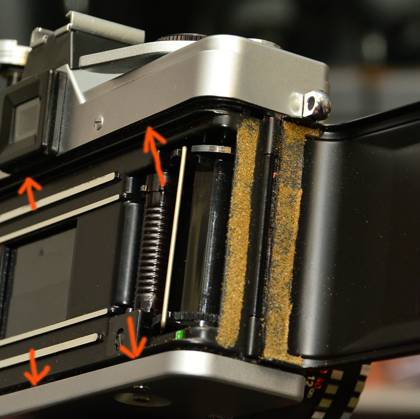

Last weekend I got a good deal on Ebay this Praktica LB and lens(next month I'll look for a Kiev). I want to relplace the light seals(I've never done that before). Are there supposed to be seals in those grooves where the red arrows are?

My recently re-sealed Nikkormat doesn't have seals there--it's lightproff bare.

The light seals on most of Prakticas comprise of a felt or foam seal at the hinge with some having string in the closure slots where you show the red arrows.
Leave the slots,mine do appear to have string set really deep, just change the hinge foam if you need to.
But I'd put a film through it first. I've a few old Prakticas and all are light tight with no gummy crumbly seals and they all have that vertical metal shutter, which is more than can be said about other 35mm cameras which I've had to change sticky messy foam seals on.

I just had a look a MY LB and it does have sealing in those grooves but I replaced only the door hinge ones cut from a sheet of foam I got for 86 pence ( British money) from a Craft Shop.

Just checked mine again, yes they do have the string deep in the grooves.
no,it's a light trap as is:smile:

Yes I'm going to load film in it tonight and try it this weekend. If there is no evidence of light leaks, I'll probably leave it alone for now.

The camera did well. Even though the light seals are just about gone, there was no evidence of leaks. I even took a shot with the lens cap on, held shutter open for several seconds, and shined a flashlight all over it. That shot was completely black. Here are a few. I threw away the rest of the slides they were just test shots. I took these with the 50 2.8 that came with the camera and a Nikon 4t. Copied with a DSLR.
