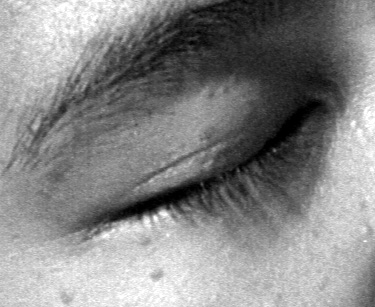

My last photo shoot has been the most frustrating. I've shot portraits of my father, again in diffuse outdoor lighting, with Tri-X 320 rated at ISO 800. The shots were all taken hand-held, at F/8 - F/11, 1/125 - 1/250. Surely that should be enough to "freeze" a portrait!? After all, back in the day when I was an assistant to a New York wedding photographer, F/8-8.5 @ 1/250 (albeit with flash) was the configuration of choice! Now I know that flash photography is an entirely different animal. However, depth-of-field is depth-of-field, regardless of the light source.
The images gotten from the Dad's shoot were "acceptably sharp" and had "adequate" depth of field (this forever relative to their degree of sharpness). However, there were still NOT "tack sharp". To better illustrate what I mean by "tack sharp" allow me to "borrow" an image from a fellow apug'er:
THIS, is TACK SHARP.
Why haven't I been able to get this? I mean, at this point I'm pretty much through blaming myself - technique or lack thereof. I'm certainly shooting at high-enough shutter speeds, and as for DOF, I'm always on the last third of the aperture ring. I know from experience that Jobo-processed negatives are always "mushy" compared to those hand processed in Rodinal. Gone is the Jobo, and I've been shaking the can! I know to use the Pro-series line of Bronica lenses - the "PS" and NOT the "S". What have I left out?
The only remaining variable, save for the camera/lenses is the film. I've always shot HP5 and now Tri-X. Could it be that the resolving power of the film simply isn't there? I highly doubt this, but in my quest for razor sharp negatives, I'm hell-bent on leaving no stone unturned.
If it's the camera/lens - please, if you know of anything like this, just say so. It'l be painful, but I won't hesitate for a moment to replace the gear. I'm proud to say that I'm a fully recovered "gear junkie". But nevertheless, tools are tools and I'd be heartbroken if having the wrong tool would leave me treading water for the next ten years!
It's the light, not the camera.
The main reason this shot is so sharp is because it was made in a studio with strobes (probably just one light in a square softbox, camera right--read the catchlight in the eyes). He shot at f:22, for pretty full DOF, but on 6x7 that's not so excessive as to cause a diffraction problem. Strobes take care of all camera shake and subject movement issues, so strobe shots will always have this sharp look unless something else is terribly wrong.

David,
This certainly occured to me. But shooting at F/11 @ 1/250th I should be able to get pretty damn close to this. I'll try using a higher F-stop, but somehow I'm not convinced the problem isn't in the camera itself.
I consulted on this matter with Philip Cohen, a personal friend and a well known commercial photographer. He brought to my attention that the problem could very well be mirror slapping - apparently a known ailment of the Bronicas. Seeing as mine is an Sq-a, long discontinued, it is quite possible that the dampner has hardened and the shock is causing the lack of sharpness. I plan on doing a test later this afternoon, shooting newsprintg as well as a live model, comparing frames with and without pre-lock. I will post my results.

Perhaps it would help to diagnose your problem if you could post an image of yours that shows the problem you're having.
As with your contrast control issue with HP5+, I don't know where the source of your sharpness problem is coming from, as the Bronica system has had an excellent reputation for tack-sharp optics, and has been used quite successfully for many years by many working professionals.

Strobes will give you a smaller f-stop and will eliminate any mirror slap/shutter vibration issue. The longest studio strobe exposures are on the order of 1/350 sec., and that's only if you're using a LOT of power. More typical exposures are going to be on the order of 1/750 sec or shorter with studio strobes, so you won't need to think about MLU or anything. Rent or borrow some studio time, use your Bronica, and you'll see the difference.
Here's an example--Bronica S2a (much older than yours), kind of dirty 21cm/4.5 Heliar (threads are stuck, so I've never been able to clean it properly) at f:22, Norman strobes--
Detail attached. A modern lens like even the 60's 200mm Nikkor would have been sharper, but the sharpness effect comes mainly from using Hollywood style lighting with strobes (and I was using the Heliar so it wouldn't be too clinical, but it's still pretty sharp).
Also the suggestion about groundglass and back registration is a good one, if you find that you are having consistent focus problems. You can test by setting up a tape measure, marking the focus point with a flag or what have you, shooting wide open, and verifying that the image on film is in focus where it should be.
