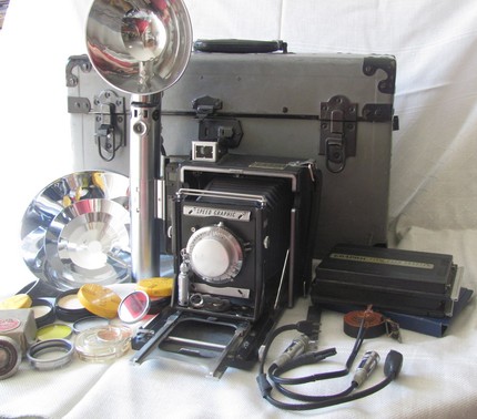

I recently found a Speed Graphic selling for $400. The outfit includes:
-Speed Graphic Graflex
-Kodak Ektar Lens F:4.7 127mm
-Hugo Meyer Range Finder
-Graflex Flash with 2 flash reflectors
-Kodak Filter #85C Daylight type F color films
-Series VI Wratten Series K2
-Series VII Wratten filter A
-Kodak Series VI Telek Lens 4
-Kodak Series VII 38mm Adapter Ring 1 & 1/2"
-Federal Anastigmat F4.5 3.5*...3& 1/2" Lens
-2 Film Pack Adaptor Graflex No.1275
-Unused Film Pack
-Graflex Plate Holder 3& 1/4" X 4& 1/4"
-Poloroid Difusser
The seller also mentions some cables, but does not know they are for.
Is this a good deal?

Depends what you want to do with it. Sounds as if it's a 3¼x4¼ model, films rare and only to special order so expensive
Things like the film pack adaptors are obsolete as you can't get film to fit them, the unused pack will be quite old. It's the least desirable range-finder as it's dedicated to one focal length, and can't be adjusted.
As an entry to LF it's the wrong choice, at best it would be OK with a roll film adaptor and there are plenty of 5x4 Speed graphics for less than that, also other LF cameras that offer far more movements than a Speed Graphic and movements are what LF is really useful for.

The cables are for connecting the flash
It's not an especially good deal IMO. I've seen mint 4x5's in their original boxes selling for that kind of money, but average used ones generally sell for much less.
3 1/4 x 4 1/4 film isn't common, so getting film and holders will be a bit of a challenge.
The unused film pack is very old as film packs haven't been made for quite a while. Hence the film pack adaptors don't have much value.
The filters can be useful if they are in good shape, but not worth more than a few dollars.
If the flash is the Star Wars lightsaber type, it can be valuable because of that, but as a useful photographic device, not so much, unless you want to explore using flash bulbs.

Is it an Anniversary or a Pacemaker? Does it have a Graphic back (spring back) or a Graflok back? Graflok back is much more versatile. Factor in some money for potential repairs or a CLA unless you really know how to work on antique shutters. Half of that price would be a much more reasonable figure. Remember that condition has a big effect on value.

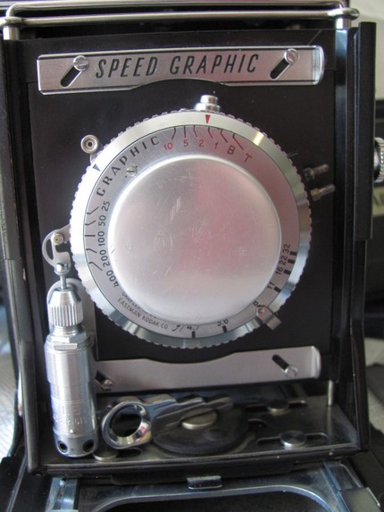

I uploaded two of the sellers pictures. I honestly cannot tell.

It's a 3¼x4¼ Anniversary Speed graphic, so no Graflok back.

That is an Anniversary Speed Graphic in 3-1/4 x 4-1/4 format. Most of these had Graphic backs(also called spring back). Only a few were retofitted with Graflok backs at a later date. It would be difficult to use this camera with most roll film backs. Value of this camera should be $100-150. The flash included is a Graflex flash that the St#r Wart fans want to get their hands on. Value is $125-150.
Condition seems to be relatively good.
Good luck!

$400 is a lousy price for that camera.
3x4 graphics go for much less than 4x5's, and you can easily get a 4x5 for less than $400.
I'm sure someone here can set you up with a 4x5 graphic kit with lens, holders, etc, for about the same price.
