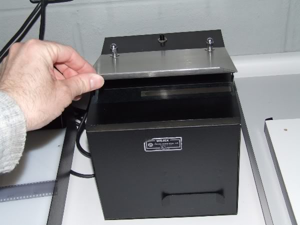

Occasionally I'll skip the first 5 frames and, in the dark, just before loading the exposed roll on the processing reel, I'd expose as step wedge with the sensitometer. That would give a very accurate measure of processing gamma for that roll.
I often “finish” a roll on the sensitometer.
The curve provides far more information than the 2-shot test I do...

The nice thing about having the step wedge at the beginning of the roll is that by leaving the tab on the cartridge after in-camera rewind, one can pull the tab out and across the sensitometer window easily in the dark. The exposed images on the roll stay in the cartridge; no risk of being fogged by the sensitometer.

Same here, so I spend some time to make sure the sensitometer is set appropriately for the film. It is important to get the toe and straight portion on the 21 steps. If those 'miss' then it can be a waste.
