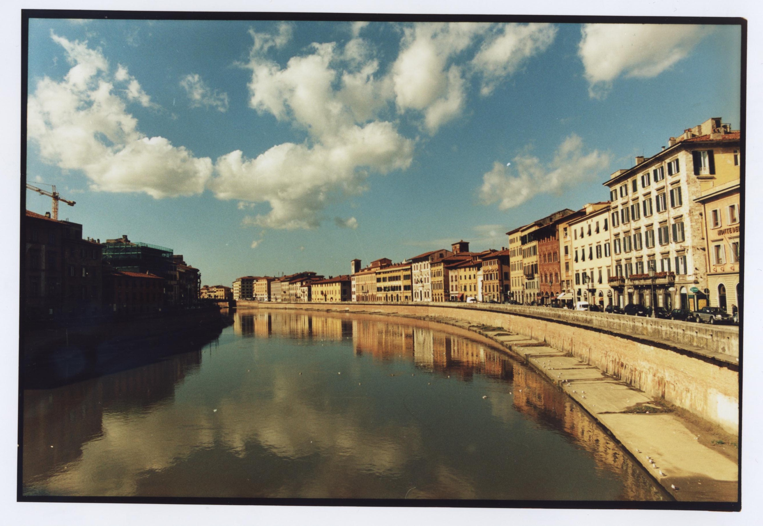

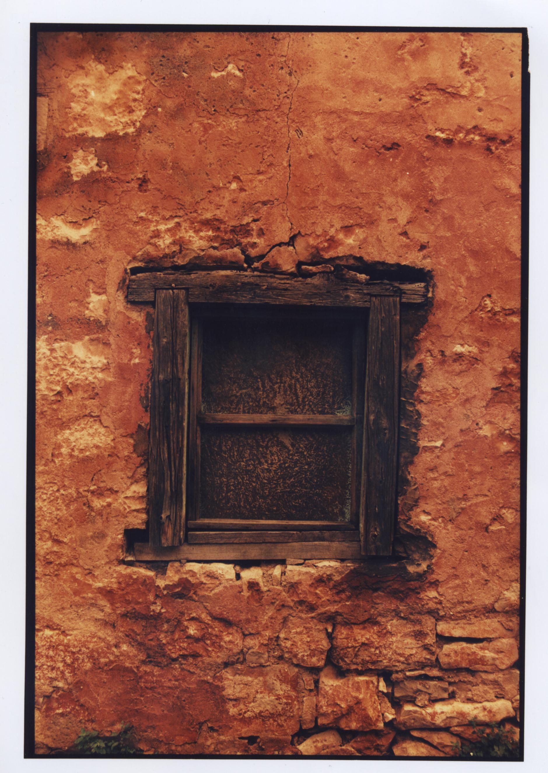

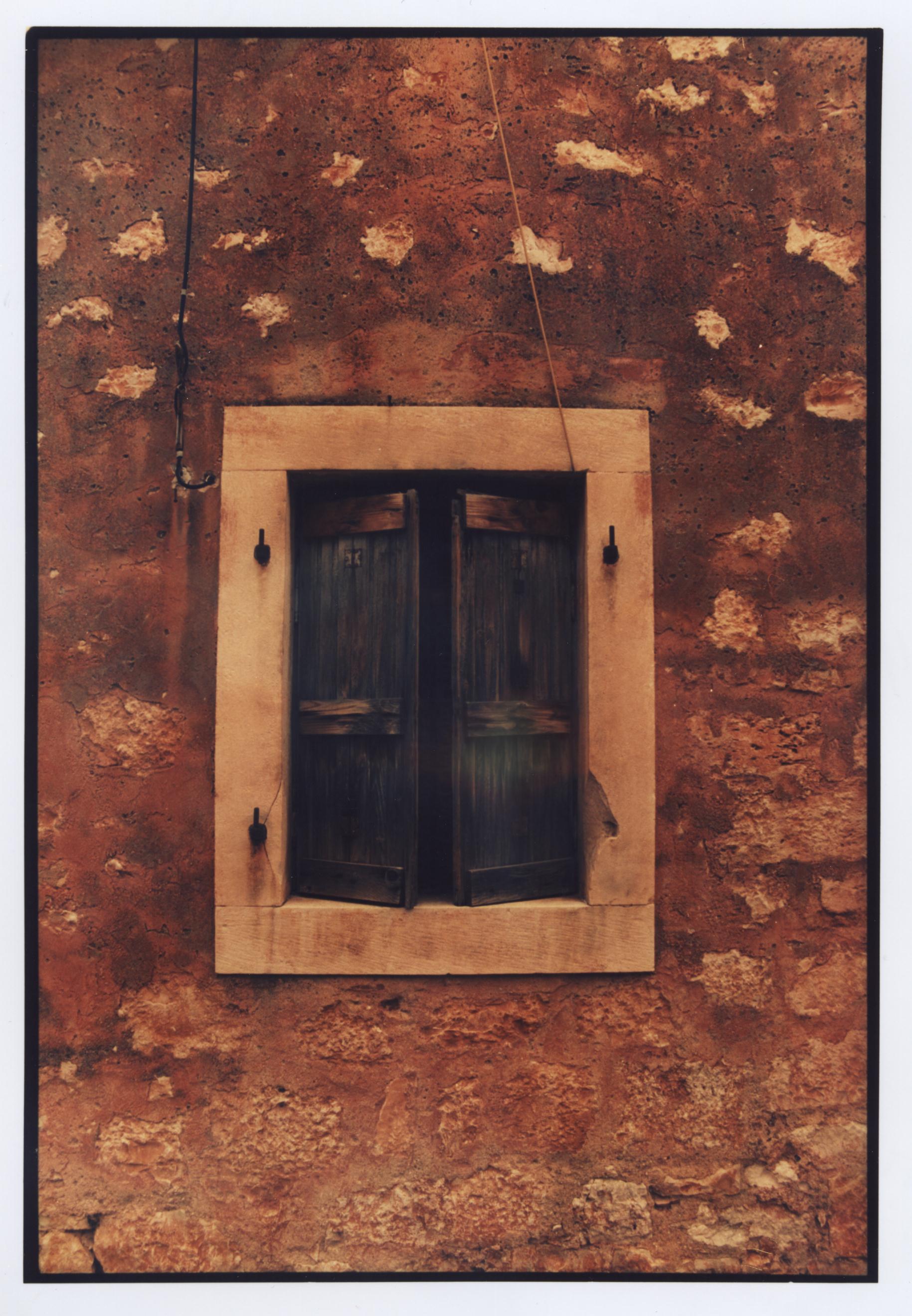

I have tried it (because I wanted to see, and my Focomat has a color head). If you are in to color photography - I would definitely suggest that you at least give it a try. For me the results were better than an (average) lab results, and you will never get 100% negative from a lab, the mask will use around 90-93% of the negative. If you want 100% negative (eventually with the black border) - then the optical printing the way to go.
Here are couple of examples from my test:
