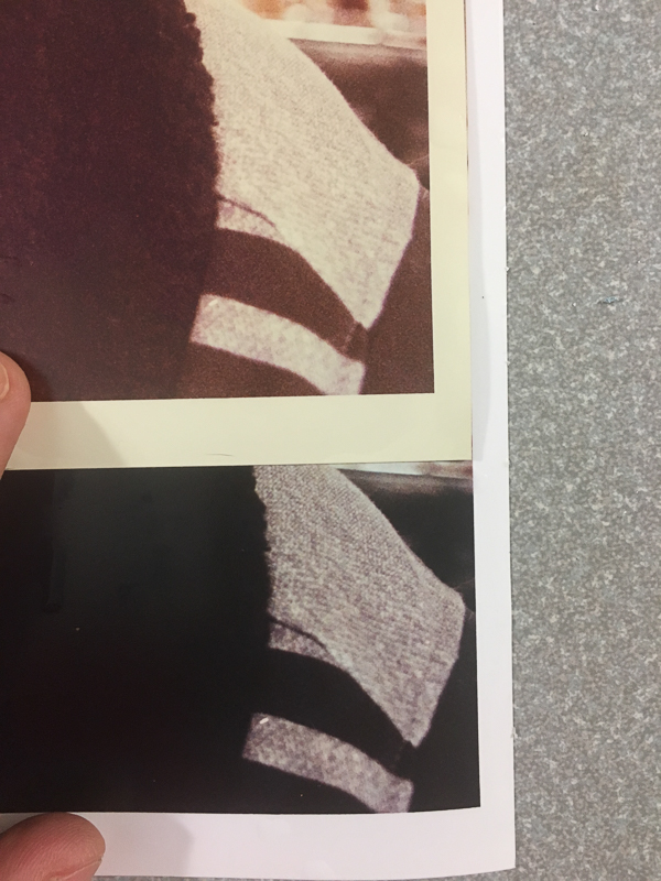

Hi,
I have been using Fuji Chrystal Archive paper exclusively but I bought a couple of boxes of Mitsubishi Speed Access Color RA-4 paper from Ultrafine Online and the borders are a light tan instead of white after printing.
It sort of looks like warmtone black and white paper.
I just opened the box and printed the one sheet in the same tank as a print from Fuji paper. The fuji is dead white.
Before I contact ultrafine online, I'm just wondering if this is how this paper is supposed to be and I just didn't know it.

Ok before this gets out of hand, it's possible that my blix is exhausted. I did two more and one is light green tint and the other is almost white.
Trying once more with fresh chems....will report.

Report; same result with fresh chems.
Is it possible that it takes a LOT longer to blix than Fuji paper?

It is possible that:
1. Paper manufacturer did tests only in one specific chemistry kit;
2. The paper has been fogged by age, temperature or bad package;
3. The paper require a lot longer blix time in your chemistry.
You may try to get some tinopal and process paper in additional bath with it after blix.

I have some of that paper. I think it is a bit fogged. Small amounts of benzotriazole in the developer often works wonders for age fog in color papers.

Thanks. I guess Ultrafine might have suspected that also, they offered me a refund.

The base should be white or you will not be able to achieve white in your prints, and whites in the print is a good way of checking your color filtration settings.
I have gotten old color paper in enlarger deals and had to get rid of it all of and use fresh paper (Fuji Crystal Archive Type II). No problems with this paper and I store it in the refrigerator, placing the box in a plastic bag, when it will not be used for a while.
I once tried the Ultrafine house brand, probably the same as other suppliers carry, and it was nowhere near as good as the Fuji paper. Unique Photo has good prices on the 8x10 and 11x14 Fuji paper.

Stick with major brands & you will better off in the long run.
Save yourself a lot of trouble and buy a brick or more of one emulsion film freezing all but a few rolls, Same with paper. Buy 100 sheets and freeze 75 using 25 in an old box of paper which you keep in the frig when not in use. I used to cut down larger sizes to 8x10 so everything is the same. Make some stops so paper can be cut in the dark. Invest in a good rotary trimmer.
By doing this you will save more time and expense than buy trying to color balance different batches of film & paper.

Hi,
View attachment 180465 View attachment 180466
I have a bunch of that Mitsubishi paper also, maybe not exactly the same type, but I also see the tan edges. I still like the paper and it was cheap. Hmm, I wonder if my roll of Fuji will be tan now that it is old.
