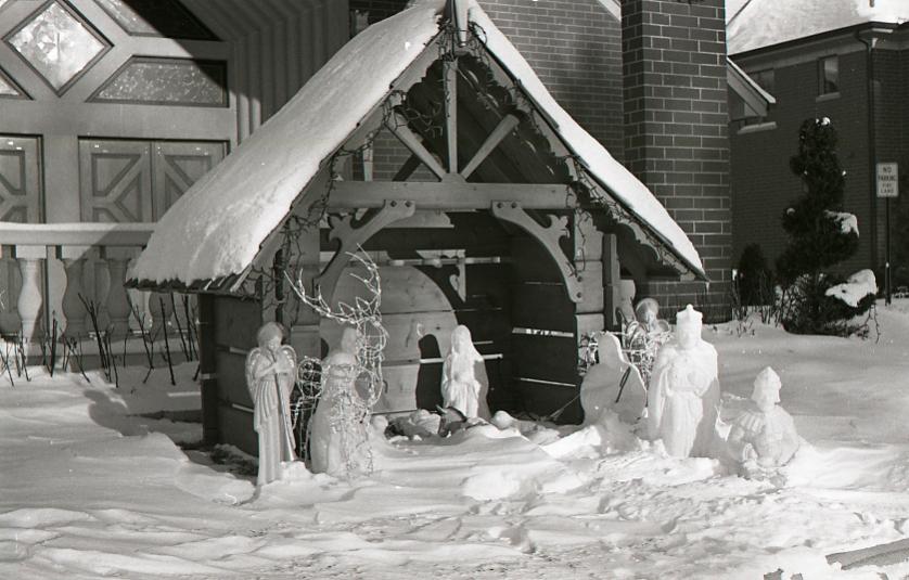

Thanks for all the advice. Im still learning photography and have a long way to go. Here is the results of my mistake. tmax 400 exposed at 100 rodinal 1+25 3.5 minutes 68 degrees 2 inversions every 30 seconds.

All the snow in the scene bailed you out on this one. You did, by accident, almost exactly what should be done with snow scenes. When you have that much white, it's a good idea to add a little extra light and pull back development a bit. The meter wants to see all that snow as medium gray, which it is not. If you go blindly by what the meter indicates, then the shadows become very thin, and will black out when you try to print the snow as white.

I agree with what Frank and Gary said. The general rule of thumb for snow is two stops overexposure, so you came up right. Tmax 400 has about as much exposure latitude as a B&W film can have. You probably could have metered this scene at asa 50 and still come up with a decent neg.

As Frank & Alex said you were lucky, but remember many of us here use Tmax 400 @ 200 EI anyway so to use you were only a stop out, not as much as you thought.
Tmax goes a little contrasty in Rodinal at 1+25 try 1+50 or 3+100 which gives better control.
