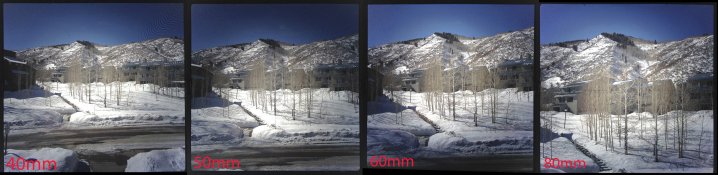

OK, so I went out to my front porch and shot a set with the 40, 50, 60 & 80mm CF lenses, it should help put it into context, the pics are of the screen via my phone. As you can see, the difference between the 60 and 80 is not insignificant, but based on what you own already and being budget conscious, I think the 50mm CF non-FLE should be your next lens.
Personally speaking, when I shoot wider landscapes in square format, either the sky or the foreground takes on a more important role in the narrative composition, the same goes for 4x5 which is pretty deep as well. All too often you see shots where the photographer was so enamored by the right to left portion of the shot that they fill either the sky or more often the foreground with really dull subject matter...I see this a ton. You want to get to the point in going from an 80 to a 50 that the choice to go wide is *super* obvious, the entire shot is strong.

OK, so I went out to my front porch and shot a set with the 40, 50, 60 & 80mm CF lenses, it should help put it into context. The pics are of the screen via my phone, LOL!
Cool. I wonder if with a tripod, MLU and using something like the 40mm CFE IF you can crop to 50mm or 60mm and call it more than sufficient results....that said once I got my 40 CFE IF, sold my 50 and kept my 60 and 80....
I don't see why not but I also think that the 60 is good enough that if you compared the 40 crop to the 60 full frame, you would see a noticeable difference, for starters, the tonality might look more condensed in the 40 cropped. I can see why one might punt the 50 in having a 40 and 60, but I like having the options in order to make the overall set work better and it creates backups for when something goes out for repair or CLA too. I love having the set I do for these reasons, 40, 50, 60, 80, 100, 120, 180 + 1.4X.
