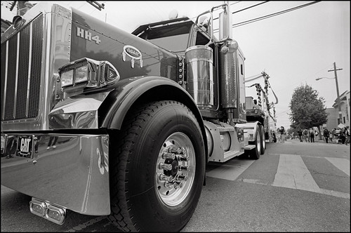

Here's another recent from the recent Carnaval parade (400TX@250, D-76 1+1):
Shots like these always make me laugh at grain arguments in 135. Only a LF zealot would actually care.
