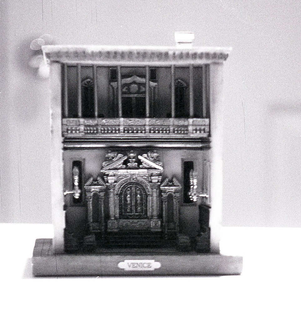

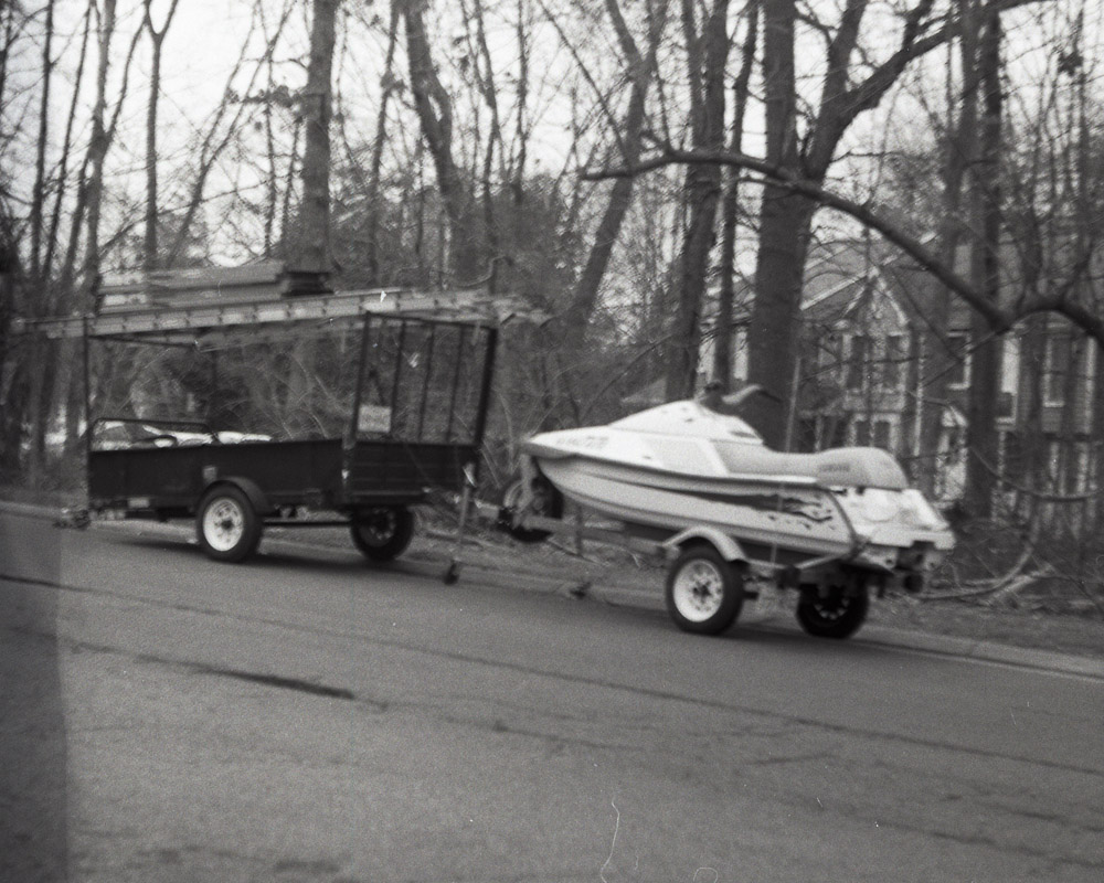

Here are two images I took with the graflex....I believe these were both were shot using 400asa film. I took a roll this afternoon using a tripod as was recommended but I didn't develop it yet.
Yashinoff
Sep 18, 2012
193
The first one almost looks like an element is flipped. The second one doesn't seem to have any area in focus. You might check to see that the lens is screwed all the way into the shutter.

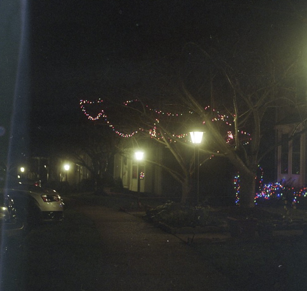

Thank you for your response Yashinoff. I developed a roll of Fuji Color 400 that I shot Holidays displays on using a tripod there were a few out of focus ones but most were in focus ....here is one of the better ones. holiday2012-1.jpg
I also checked the camera and everything seems tight. Perhaps this camera is just much more sensitive to motion blur than newer or more high end cameras. One other thing I noticed is there is perhaps a slight light leak on the right side (showing up on the left side of the image.)
I will be developing the test roll I shot today (T-Max 100) either tomorrow or Monday ...again tripod was used.

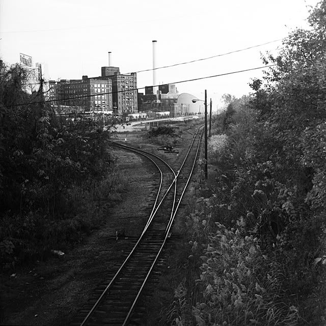

You can always check focus with a DIY ground glass. Get a piece of plexi or similar and cover one face with scotch magic tape to simulate the surface of a ground glass. The side with the tape is your film plane. Hold that side to the film rollers and compare the focus to the focusing ground glass. If they dont match, I would make sure the ground glass in the viewing hood has not been flipped before I started messing with the lens. Here are a few shots from my 22 with the cheaper 3-element Graflar lens. Not a great lens, but can be quite sharp stopped down a bit. Both were shot from a tripod with a cable release:

That is about what I would expect from a triplet lenss, Matthew. BTW, when "clik this bar to see the full image" I got a Malicious Web Site warning from Norton. Not sure what that is about but doesn't look good.
When I shoot old cameras withuncoated triplets I call it "ART". :smile:
I wouldn't. I've never had a triplet that soft, even on a 35mm camera. I suspect the lenses are not calibrated to each other or there is some other problem.
You should be able to get something at least this sharp around f8:

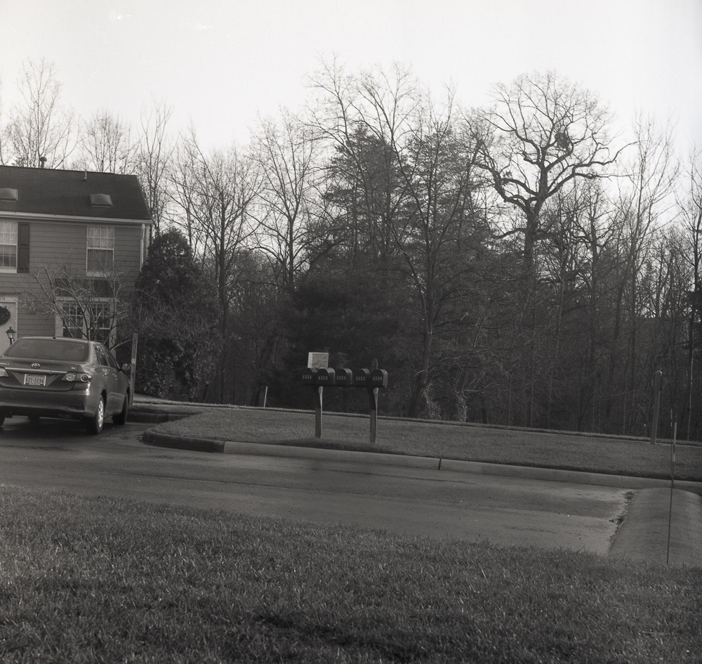

Thanks guys! Yes, I have plenty of old CD cases. Now I developed and scanned a roll I took with the Graflex using a tripod in daylight...with the tripod it seems not too bad. Here are the samples graflextest-4.jpg graflextest-3.jpg graflextest-2.jpg graflextest-1.jpg graflextest-1-2.jpg
I'm going check the lens and assuming the weather holds tomorrow do some of the focus tests people have mentioned.
