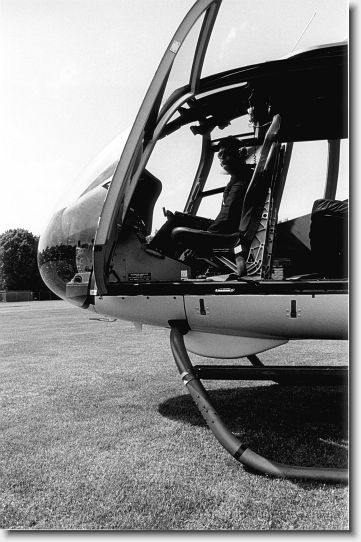

Obviously I would like to take a camera up with me, although I'm not sure how easy it will be to take photographs from the helicopter, as I've never been in one and am not sure what the seating/window/door situation will be like with this particular one.
Take a look at my "Heliflights" gallery on my webpage:
http://www.boeringa.demon.nl/heliflights/index.html
It was the first and only time I flew with a helicopter, and I was lucky enough to be seated next to the pilot.
I used my Minolta Dynax 7 with my F2.8 28-70 zoom to take all shots from within the helicopter (some ground scenes with 70-200 zoom). Film was TriX 400. I don't know if changing lenses is a really viable thing, especially on short flights. I was glad to use the zoom. Yes, there are vibrations, but with any half-decent lighting, you should be OK. The sky is your backdrop and light source!
Actually, your biggest concern should be staying healthy! :D
After some 10 minutes of sometimes quite vicious turns, while looking through the viewfinder a lot, I was close to p******g... Had to ask the pilot to fly a bit less fancy full, and just made it to the ground in one piece. I was OK after some 10 minutes lying in the grass :wink:
A helicopter is tremendously agile, and I would definitely urge you to specifically ask your pilot to restrain himself and only make modest moves if you want to be able to fully take advantage of the photo opportunities. At some point, we made turns with the heli at 45 degrees... Sensational, but not if you are trying to keep your head straight to take pictures and your stomach healthy.
