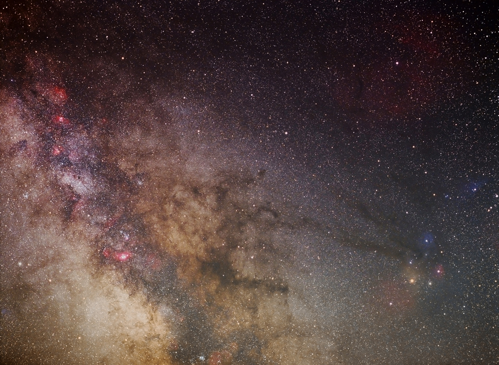

E200 and Elite Chrome 200 has excellent reciprocity and little color shift. I have exposed it under Moonlight with 20 to 30 minute exposures and you would swear the frames were taken in daylight. These films continue to record light well into 2 hours plus before dropping off. There is some reciprocity loss, but I would think it would be one stop or less over many minutes. This is why it is the best color film for astrophotography
30 minutes at f/4 105mm lens Pentax 67 E200 pushed +2 stops

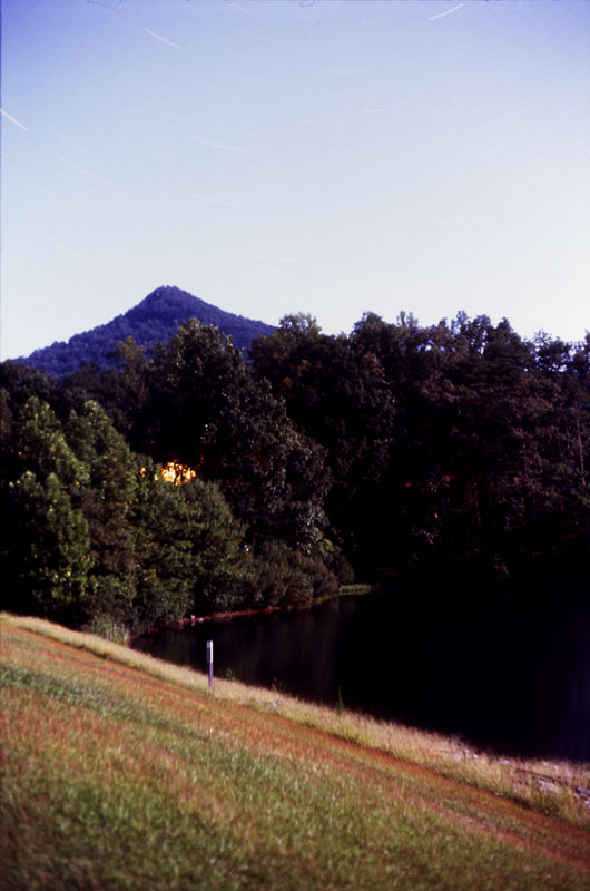

I think the consumer grade Kodak Elite 200 works just as well at night.
This was pushed 1 stop, 45 minutes at f/2.8 under a quarter moon just after it rose above the mountains.
