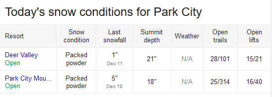

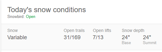

I like Deer Valley better than Park City. Deer Valley has better service and the great plus that it is skiers only. I like deep powder even better and would rather go to Snowbird but given the steepness of Snow Bird you are better off with Park City or Deer Valley.
