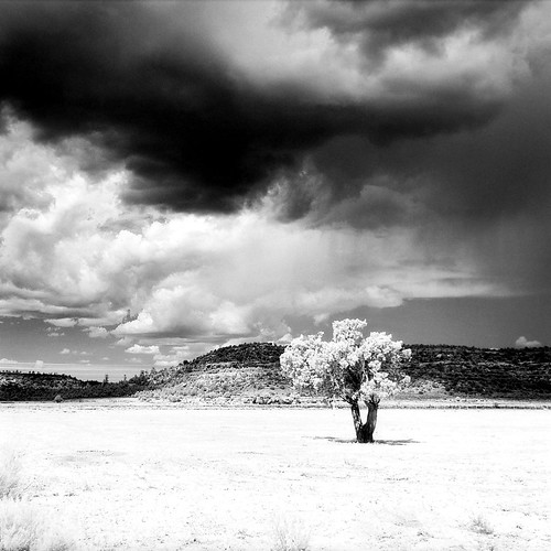

I love this film, I use it with a red filter at EV11. I usually use a camera that doesn’t have the IR compensation on the focus scale so I focus slightly in front of the subject and shoot at f/11 or f/16 to increase the DOF. Use a tripod and only shoot on a bright sunny day with the sun at your back. I’ve developed it in Rodinal and HC-110 with great results.
in this shot, despite the clouds I had the sun at my back and the tree was in bright sunlight. Developed in HC-110 dilution B.
Thunderstorm Over Zuni Mountains by Bryan Chernick, on Flickr
