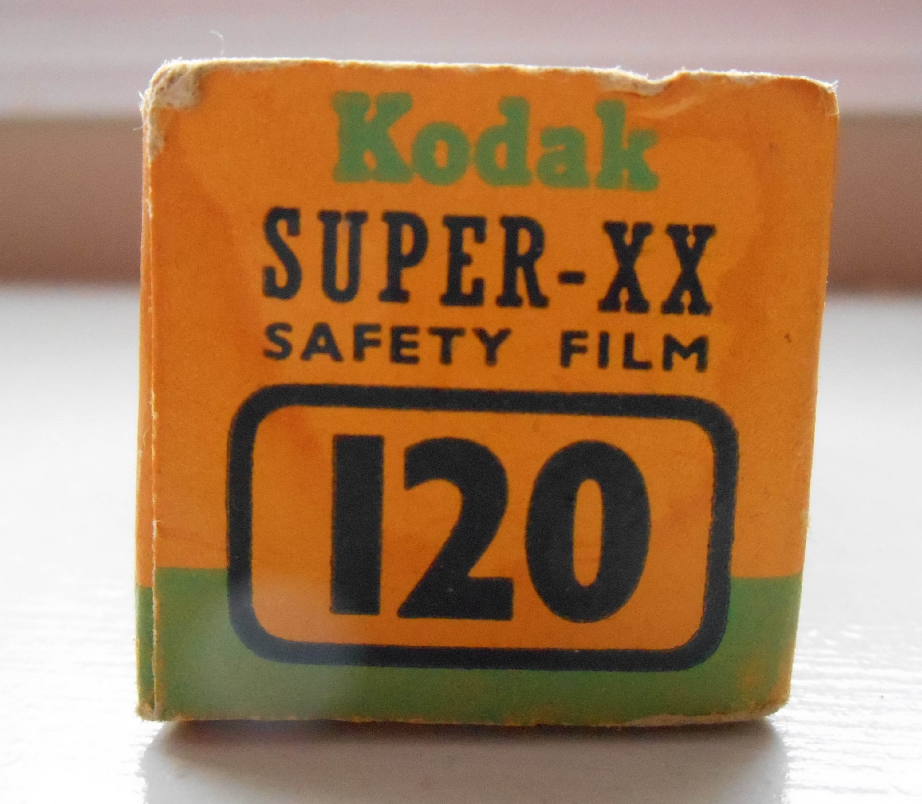

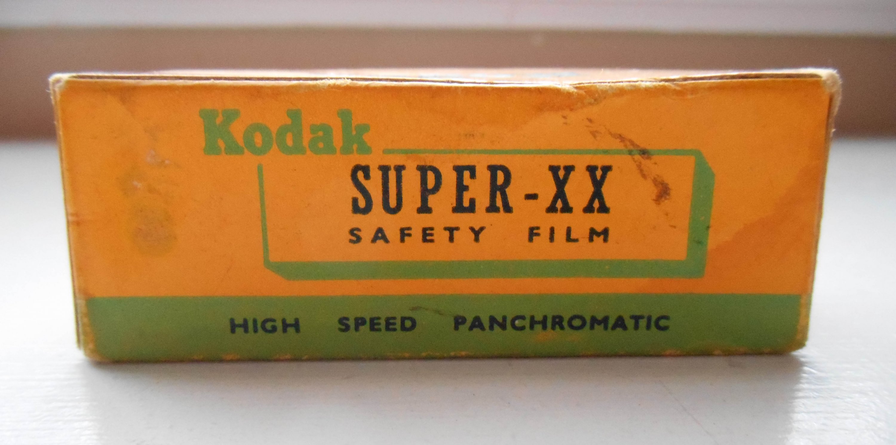

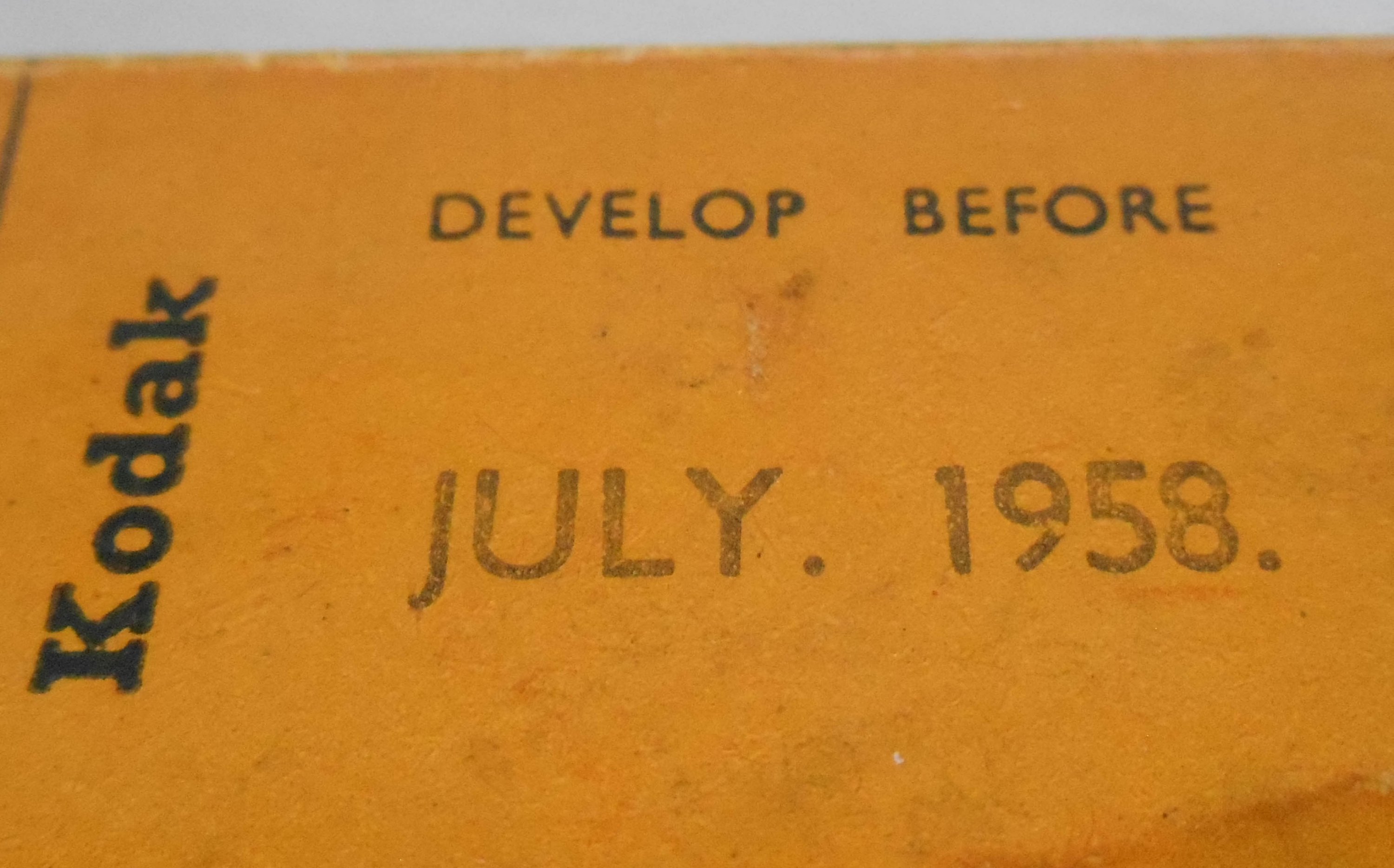

I have a 120 roll of Super XX from 1958. I'm wanting to try and shoot on it for fun. Im not expecting it to turn out to be honest, based on a previous roll I did years ago. But I'd like to try. Should I shoot it at ISO 25? And when developing in Xtol, what time would one do for it? Should I do it at 1:1? Im expecting it to be extremely fogged, but some others have had luck with film of this age. Who knows. Maybe the pictures will have some artistic look to it. Any suggestions?

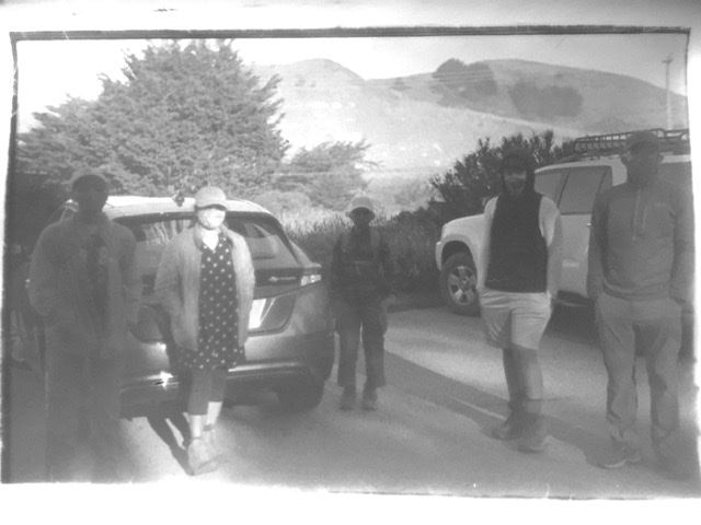

I found this old film has so much fog that the effective speed is very low, like EI 2 - 4
This was from 35mm, so you can get an idea what to expect.

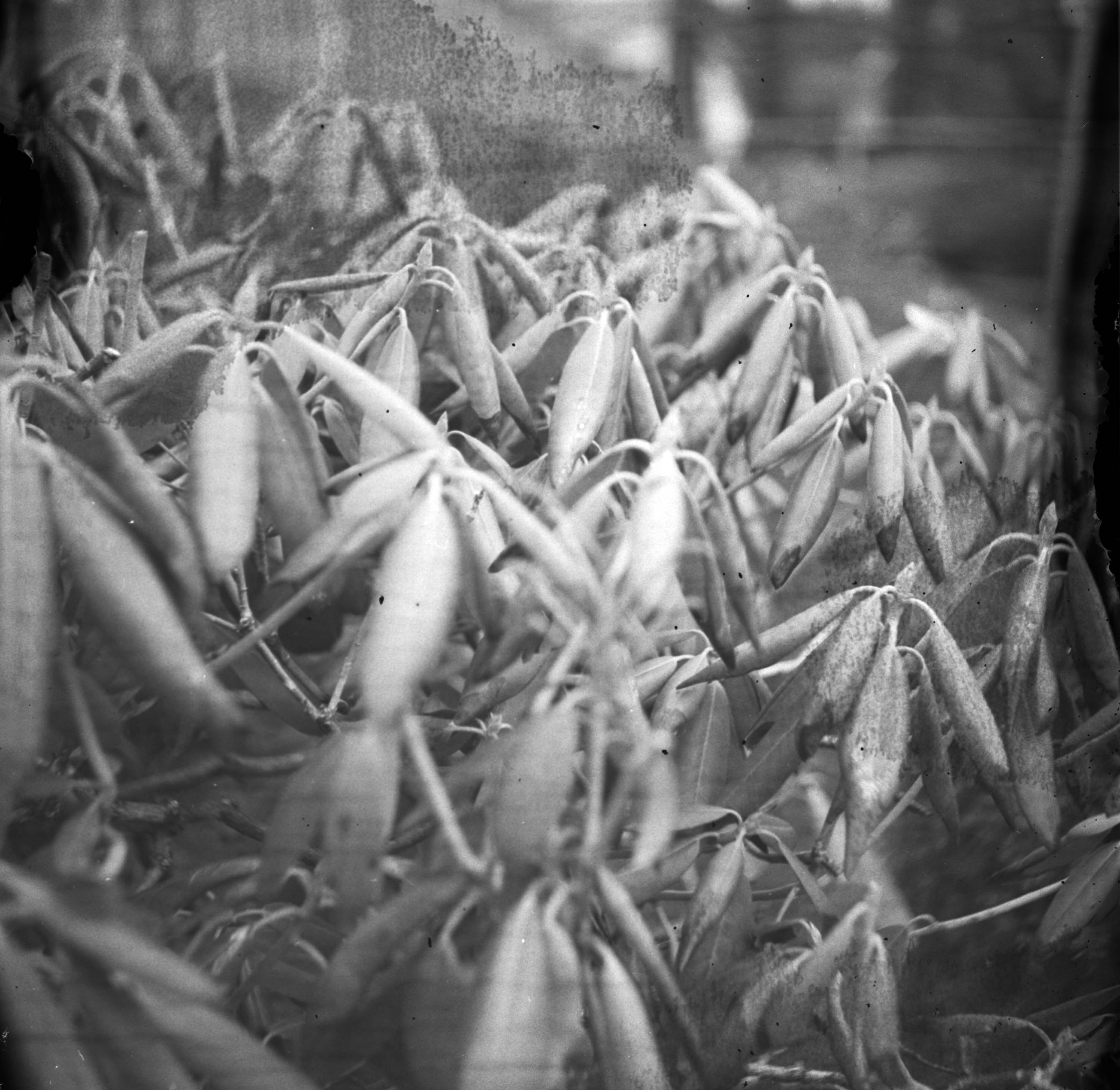

I loaded up this roll in my Yashica A camera. It was the only camera I could put the reel into, as the metal reel didn't have the slots on both sides that my other cameras use. Only a slot on one side and hole in the other side. So it went into my TLR. It was really crunchy loading it in. The paper was damaged and really stiff. When I got to frame number 1, it just seemed really stiff. I have both Xtol and Rodinal. I haven't decided as which one I will use, as the Xtol is mixed up, but the Rodinal (new version) is still sealed in my bottle. In the film box there was a print out from Kodak on films, chemical mixes and times. It even showed how to make D-76 from scratch with a recipe. I might scan that up to show you guys here. I will probably shoot this roll as 12 ISO speed. Im not sure what times I will develop the film at, but it wanted 15 minutes in D-76 according to the sheet. Im expecting this film to not turn out, being completely fogged, but Im going to shoot the roll anyway just to see. I'm making a video of this process.
braxus
braxus
Oct 19, 2005
1,779
Fraser Valley B.C. Canada

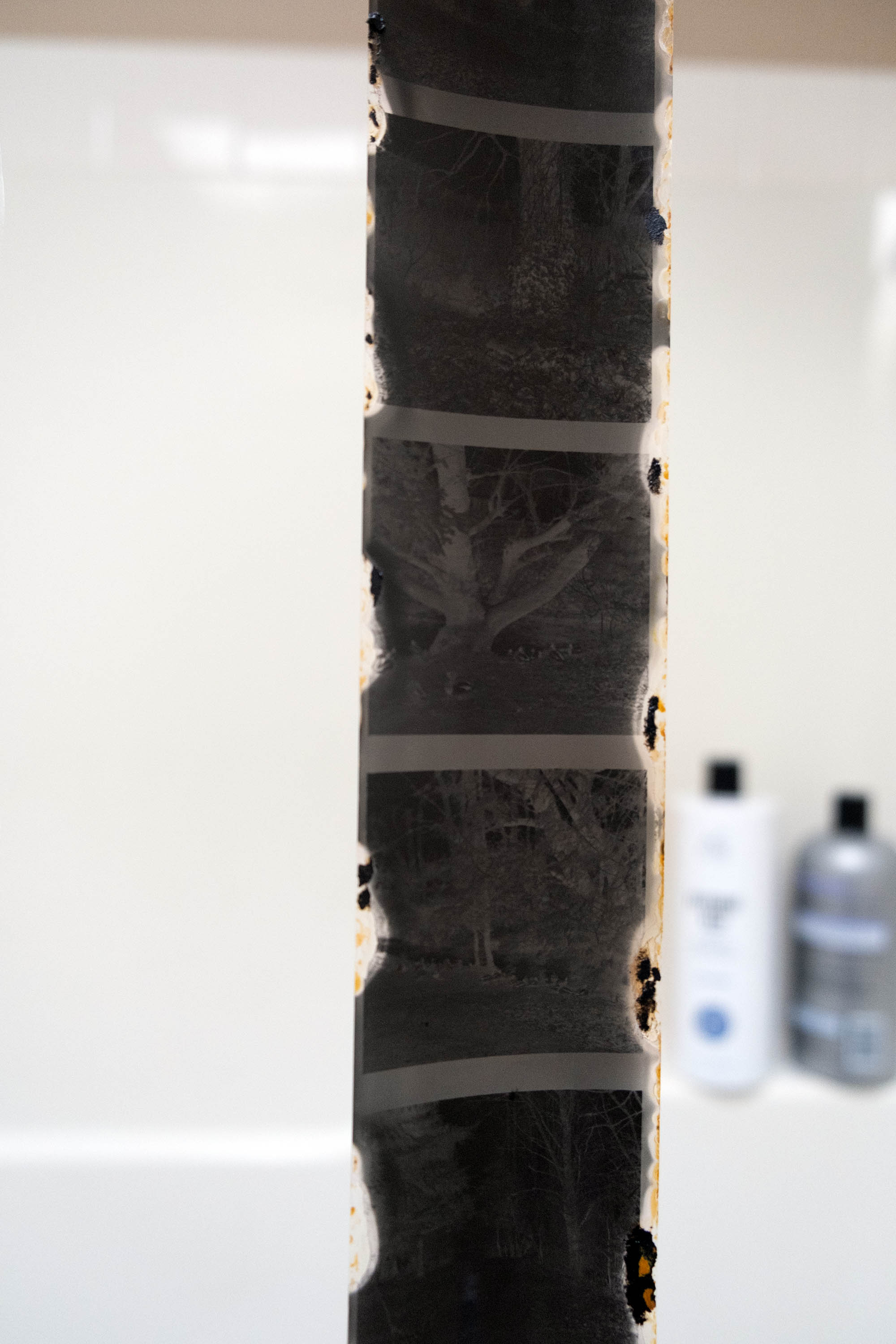

Well I shot the roll between 6 and 12 ISO. I basically just shot it wide open at the slowest shutter speed the Yashica A could do. Its an dull overcast day here today. I was outside shooting. Winding was very stiff throughout the roll. When I got home and loaded it into the developing tank, I noticed the backing paper was stuck to the film through most of it. Tried to take off as much paper as I could, but some of it is really glued on there. So I did the only thing I could do and prewashed the film, to hopefully loosen the paper. But I wont be able to take out the paper before developing it, so its going to have to stay in there, and hope for the best. After fixing, I'll just open it all up, take out the paper, and fix some more. Then wash. So far the roll seems like a loss, but Im still hopeful I can get something off of it.
braxus
braxus
Oct 19, 2005
1,779

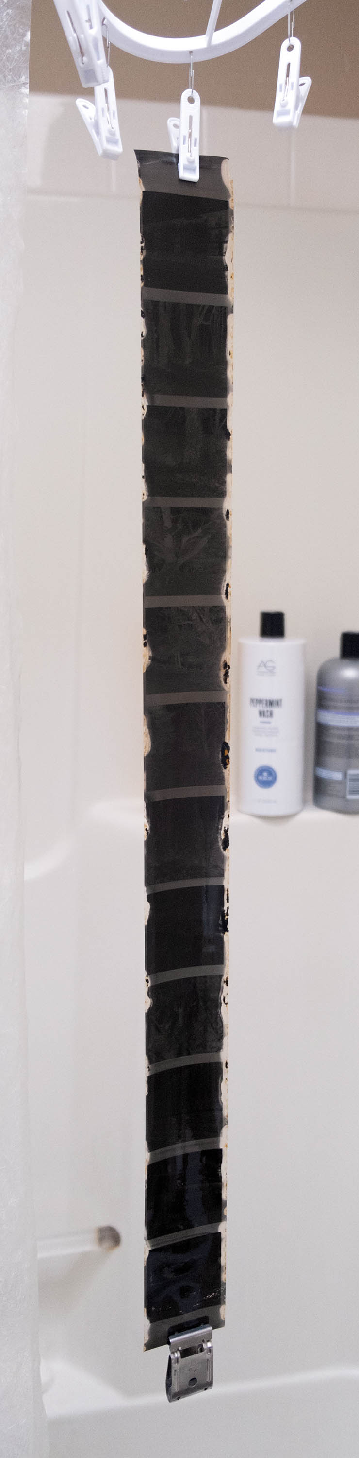

Well I fixed the film, pulled it out after 6 minutes and pulled off all the stuck paper. I could actually see images on this roll. So I put it back in the fix with the paper off and did another 6 minutes. Now its washing in the sink. I had to dump my fixer because of paper bits floating around it. I'll mix up some more to fill the bottle back up. There is fog on this film, and the negs are really dense. But I think I can actually get some images off this roll after scanning it.
I ended up developing it in Xtol straight for 14 minutes, fixed for 12.

Well there certainly looks to be images there and scanning might well be able to produce a fully recognisable picture with some manipulation as might an extended exposure under an enlarger. Not bad for nearly 64 year old film

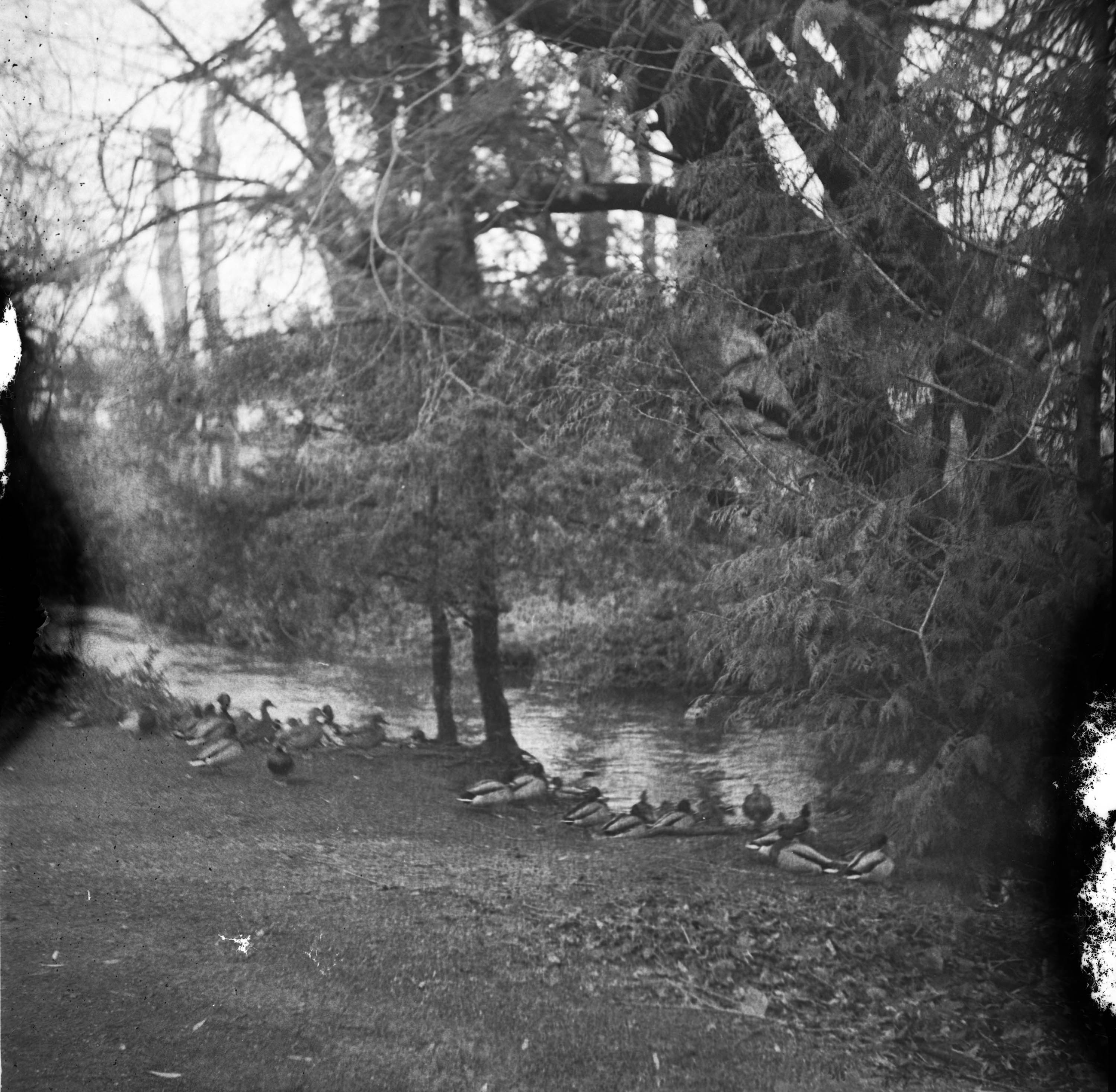

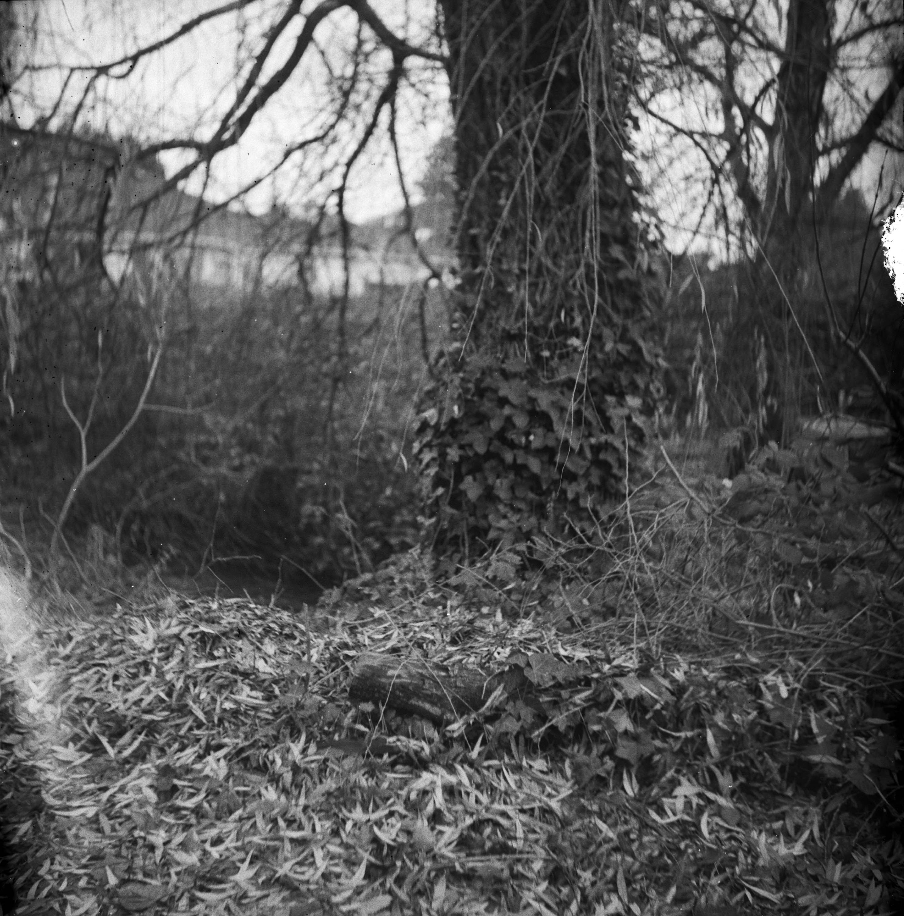

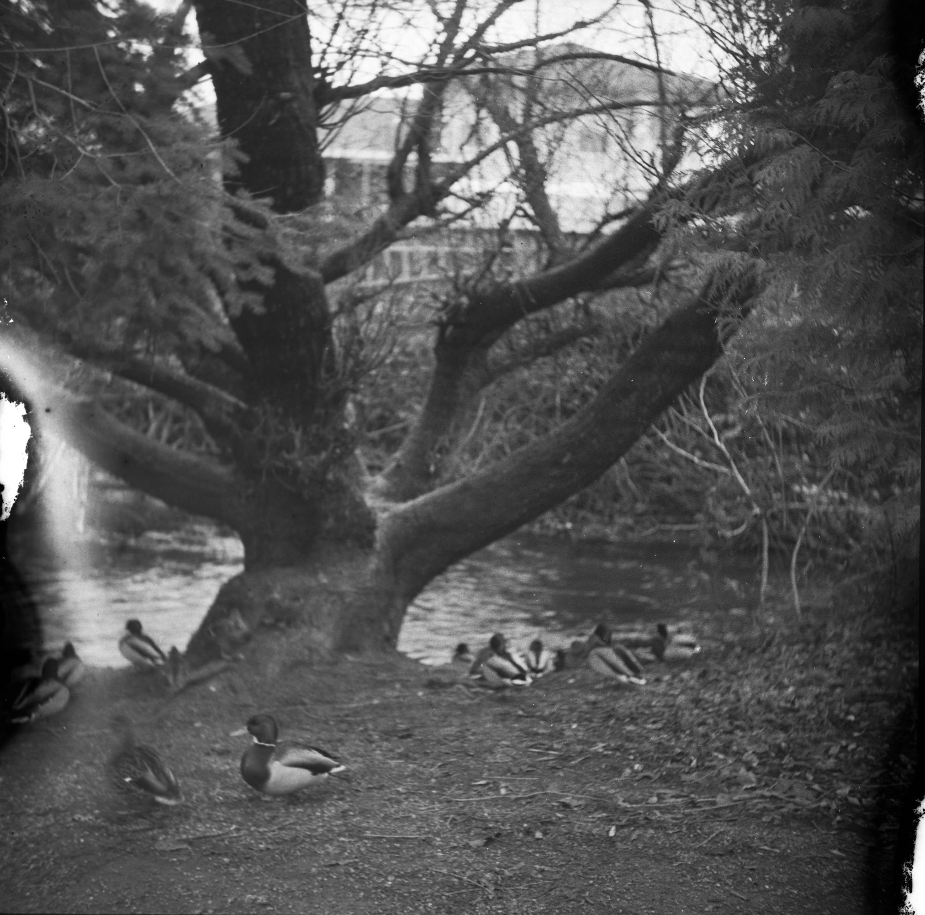

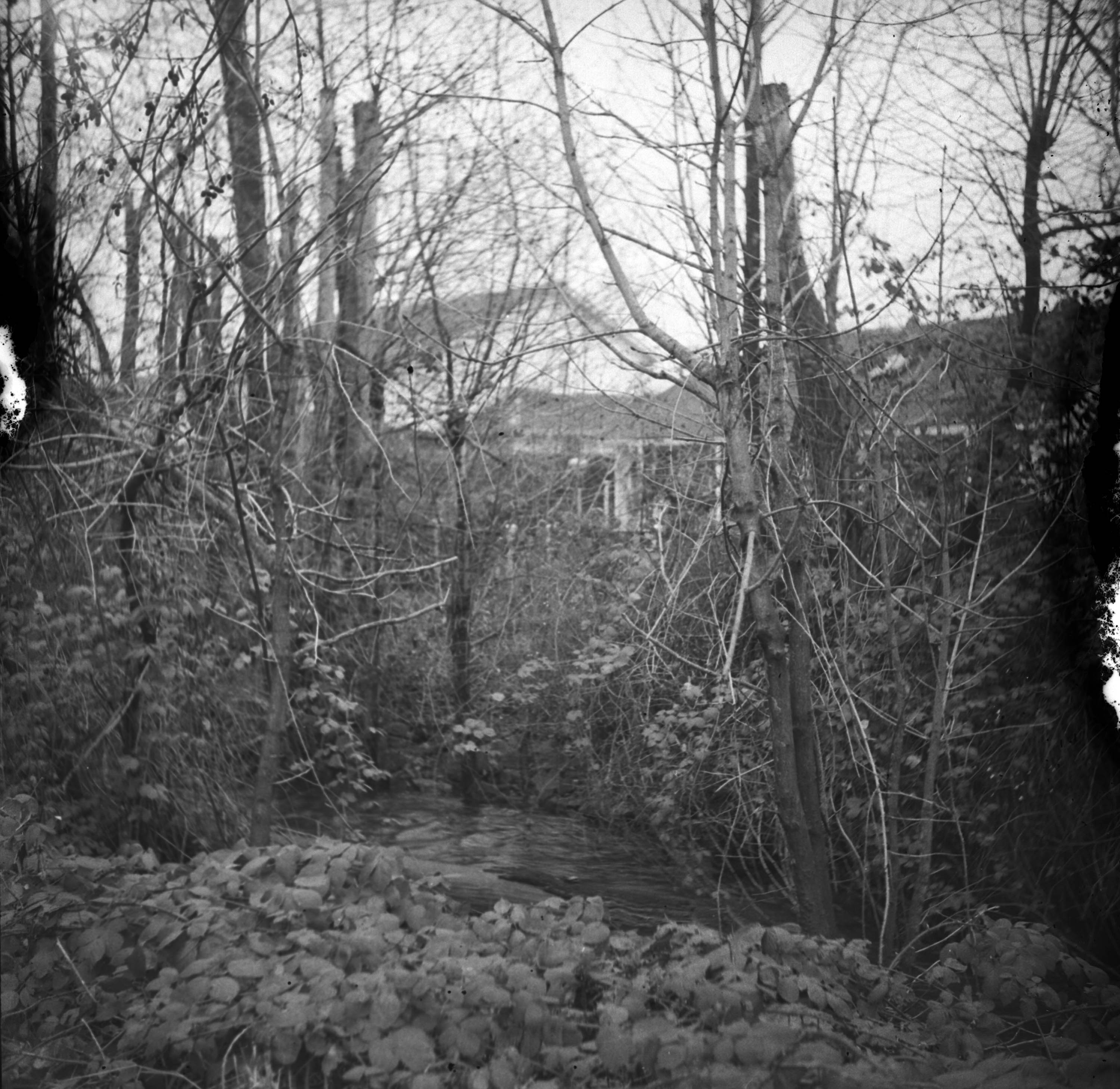

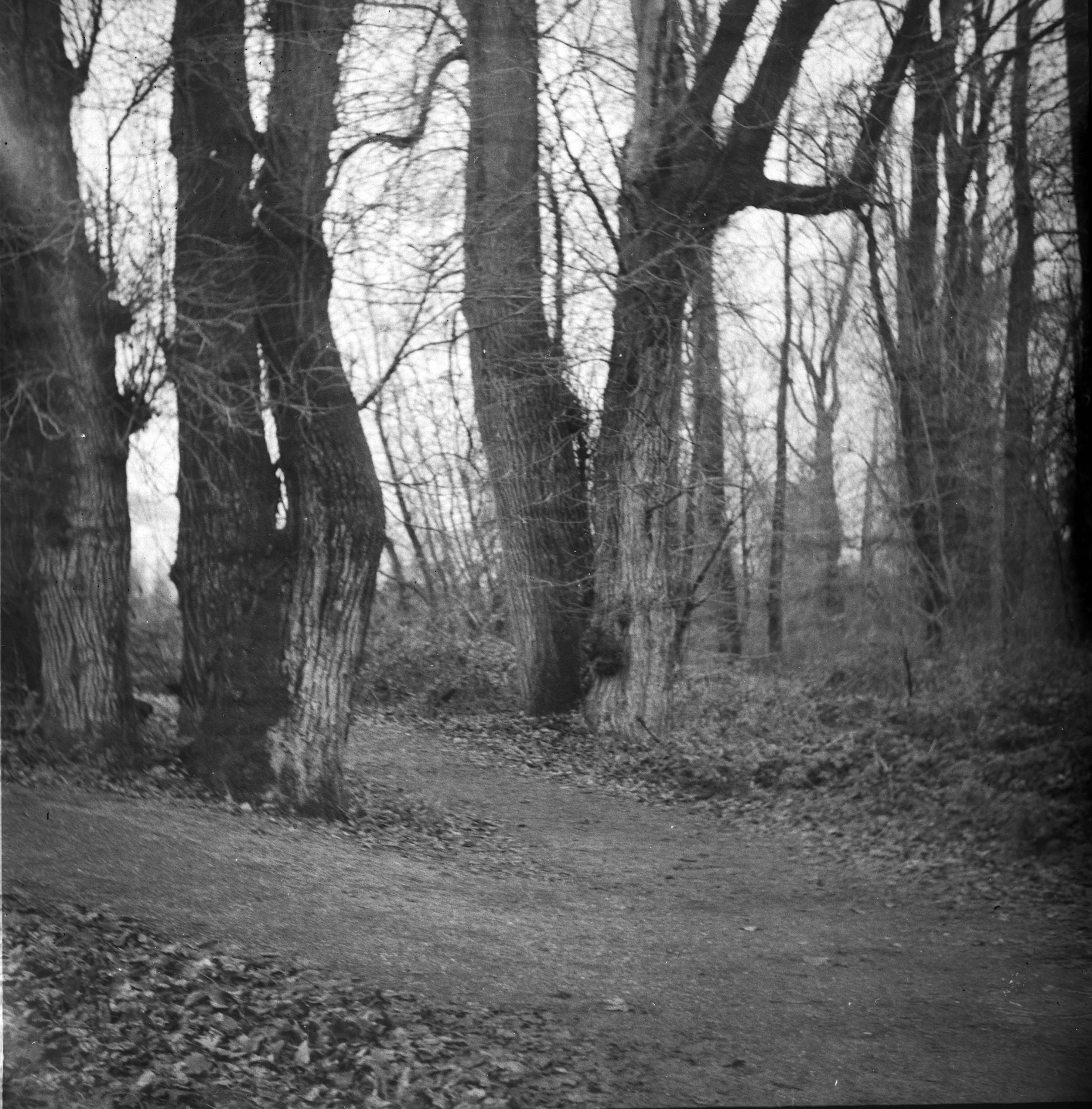

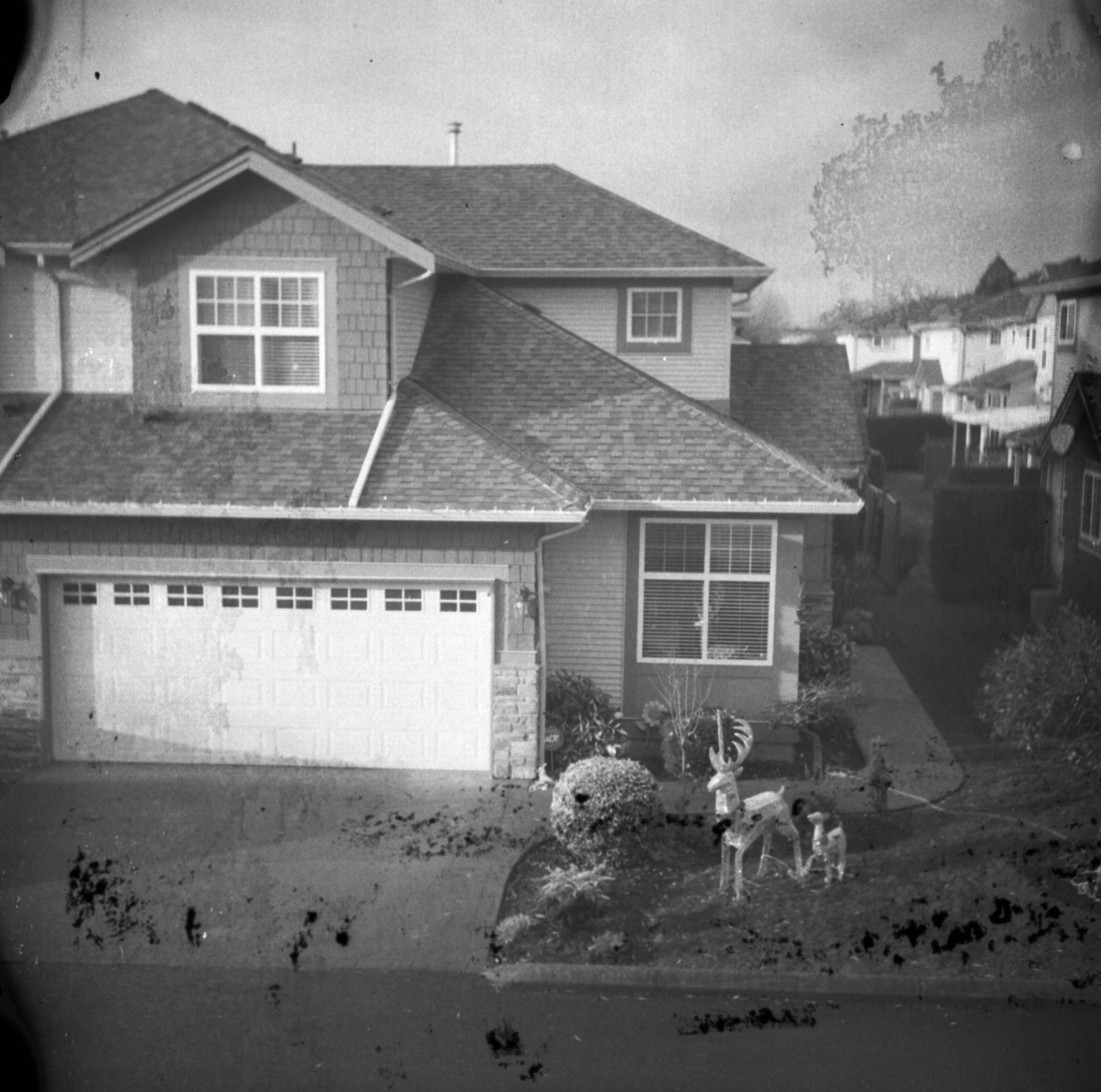

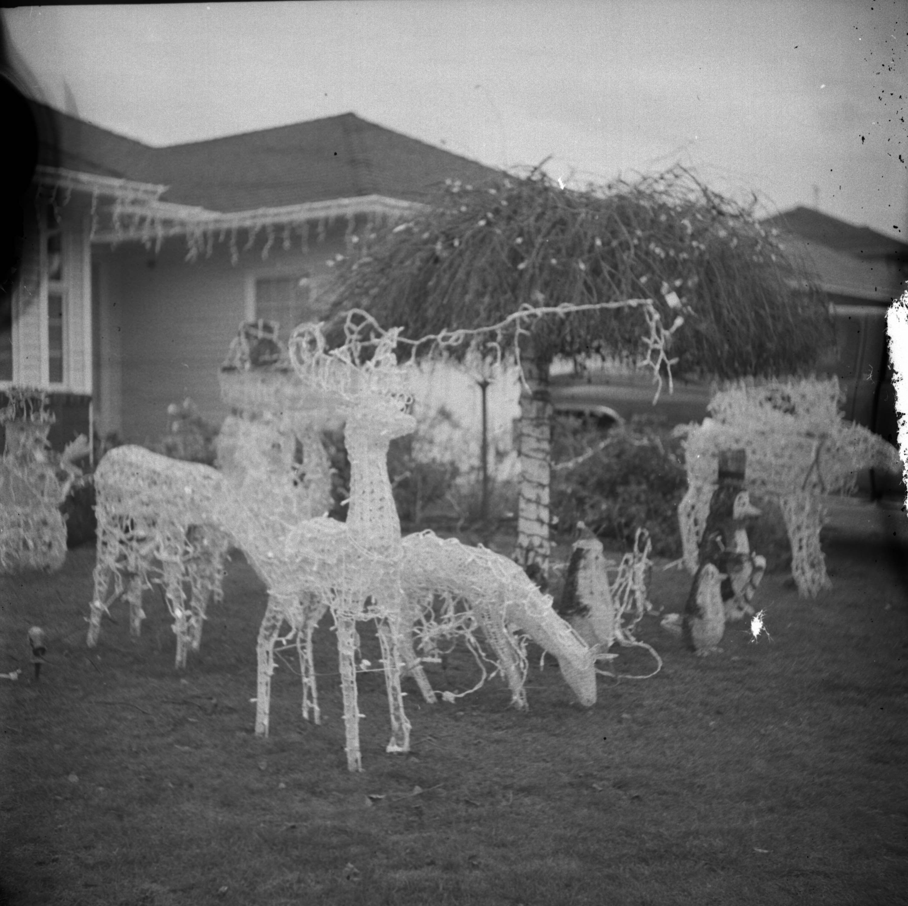

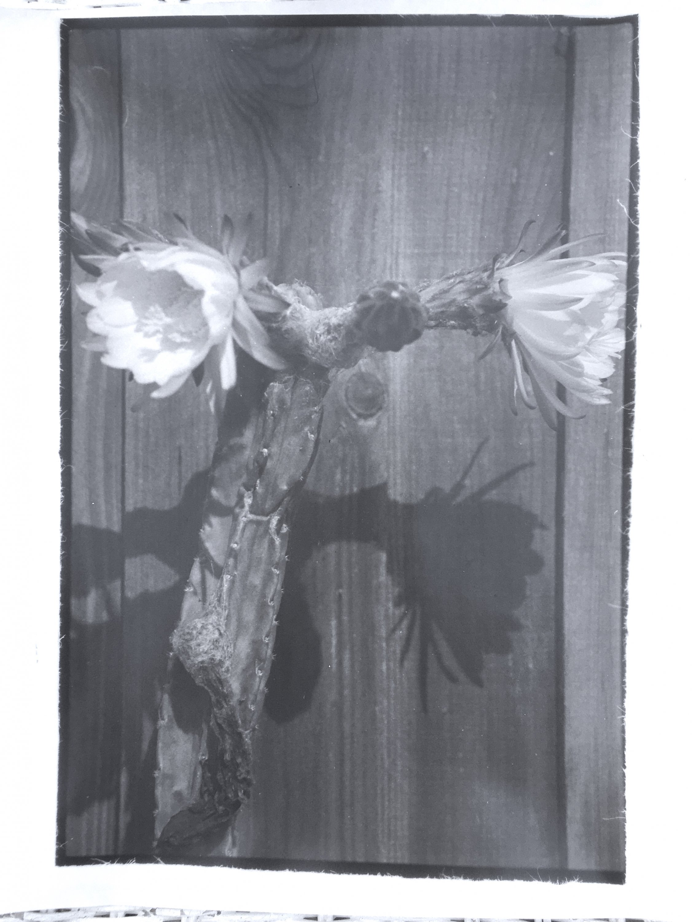

So the film flattened out just enough for me to scan these up. The images were so dense, I really had to crank down the brightness and contrast. Then in Photoshop, I had to crank the brightness down more and bring back up the contrast. Im quite pleased with the results of all this. Its really quite a beautiful looking film, being the defects from age, etc. Take a look. I also included the paper sheet that was in the box with info.

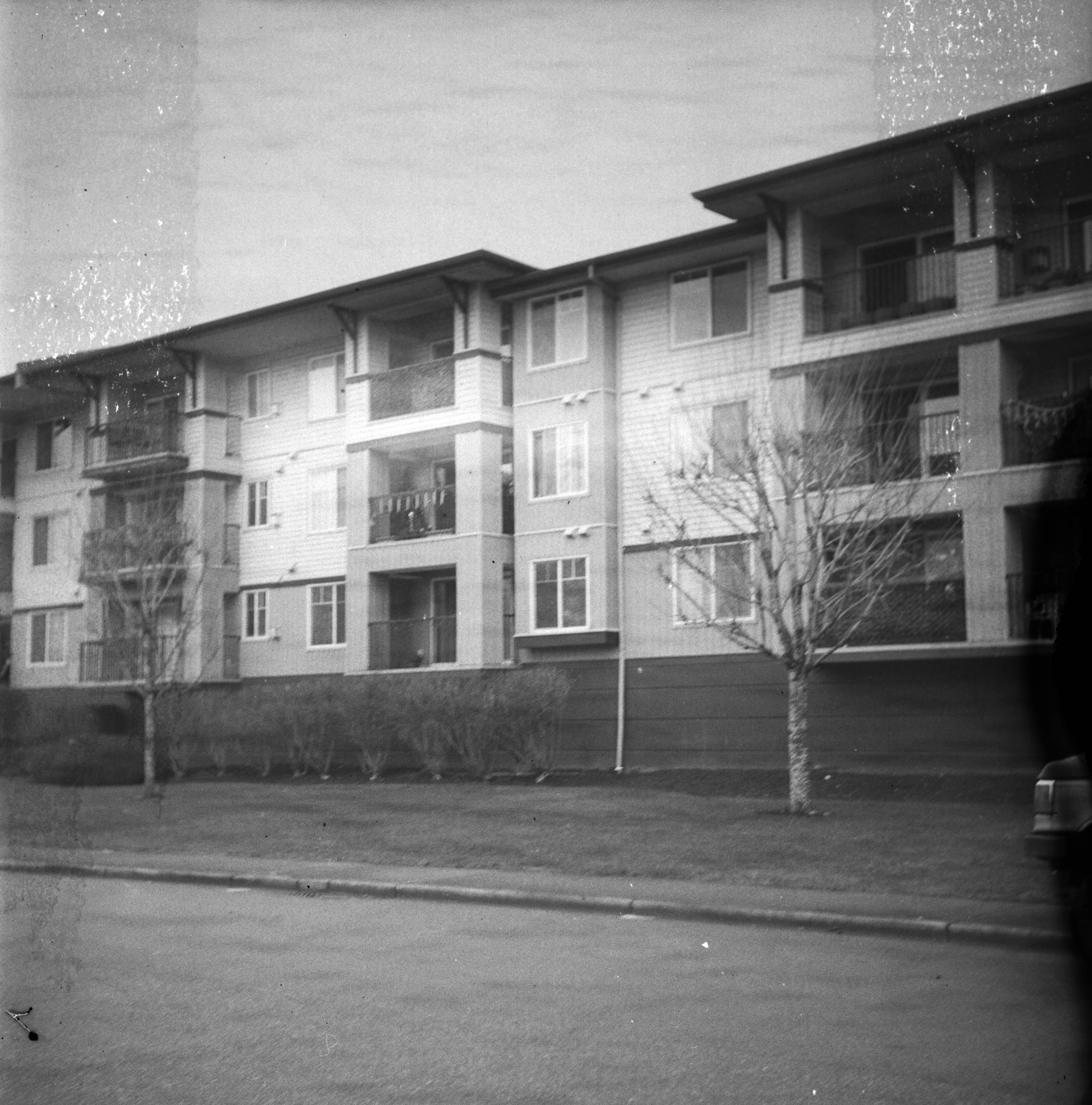

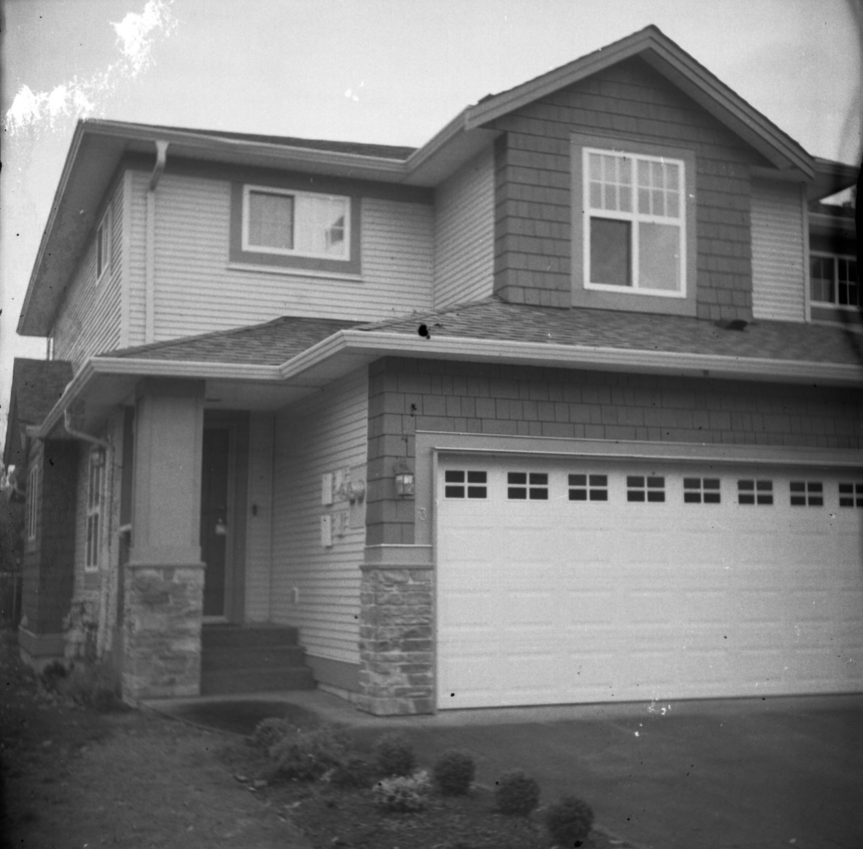

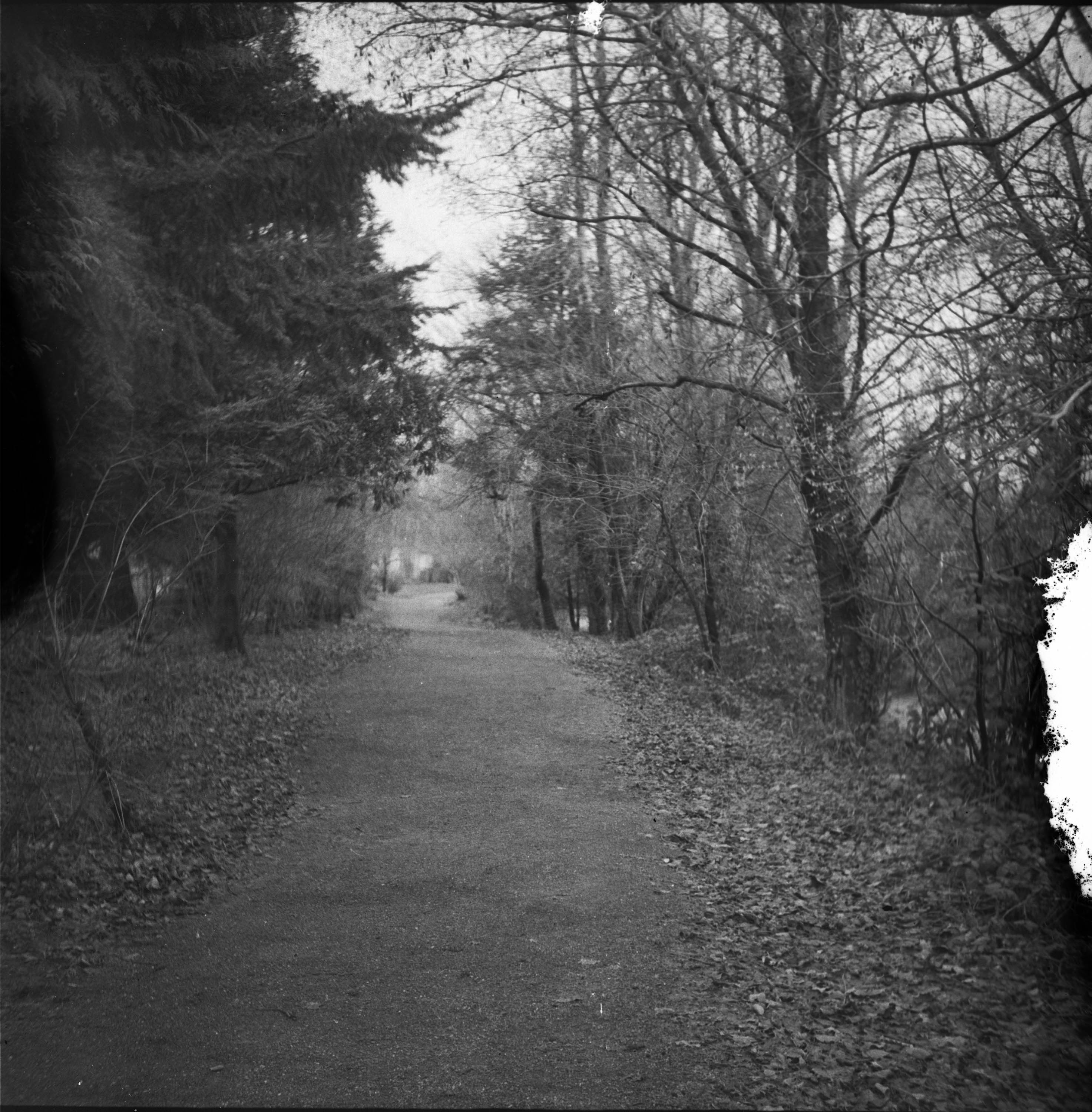

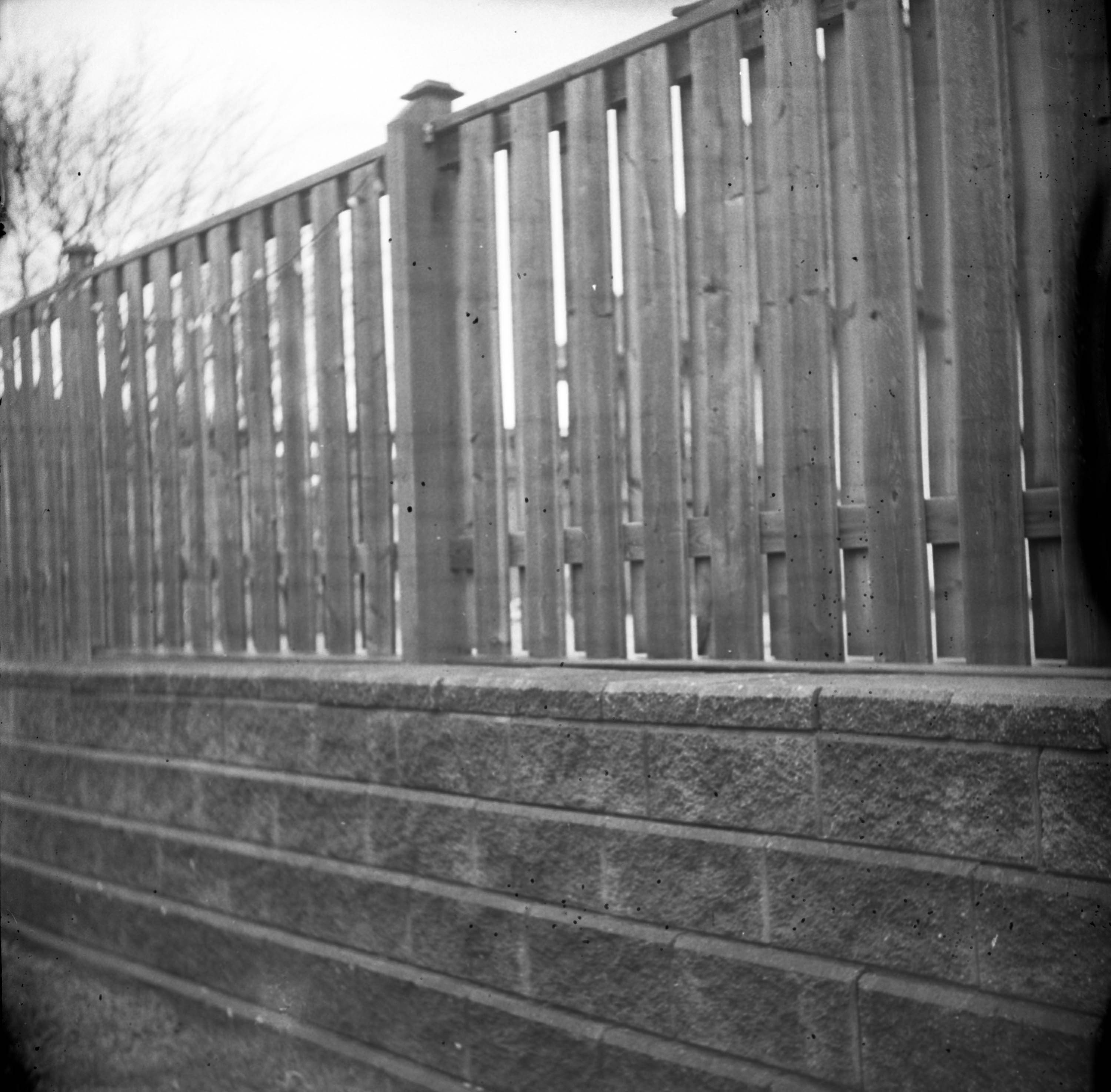

MattKing
Apr 24, 2005
52,554
Delta, BC Canada
Excellent work! Better than my 1940s vintage 616 film.
I know I'm late to mention this, but the ASA standard was changed after that film was made. A 100 ASA film that was to be developed before 1958 would be a 200 ISO film today - just due to the redefined standard.

Thanks for the link. Good job with the video, just the fact the images are as good as they are from a sixty three year old roll of film make it worth viewing.
