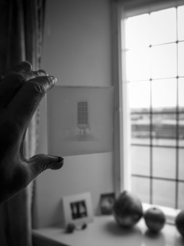

Here we have ...
20141012-1 by _loupe, on Flickr
Shot in a Zero Image 5x4 (I made a "plate holder" from foamcore & cardboard, but no darkslide) at EI3 - about 4 mins exposure.
Developed by inspection in some goo I made up a couple of months ago to test something for someone else and didn't throw away (phenidone and coffee in glycol)
20141012-2 by _loupe, on Flickr
20141012-1 by _loupe, on Flickr​
Needs more exposure, and more development in a better developer with a splash of KBr ... but I was mostly pleased that anything came out at all ...
