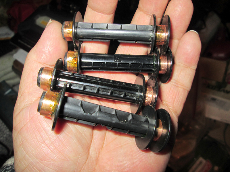

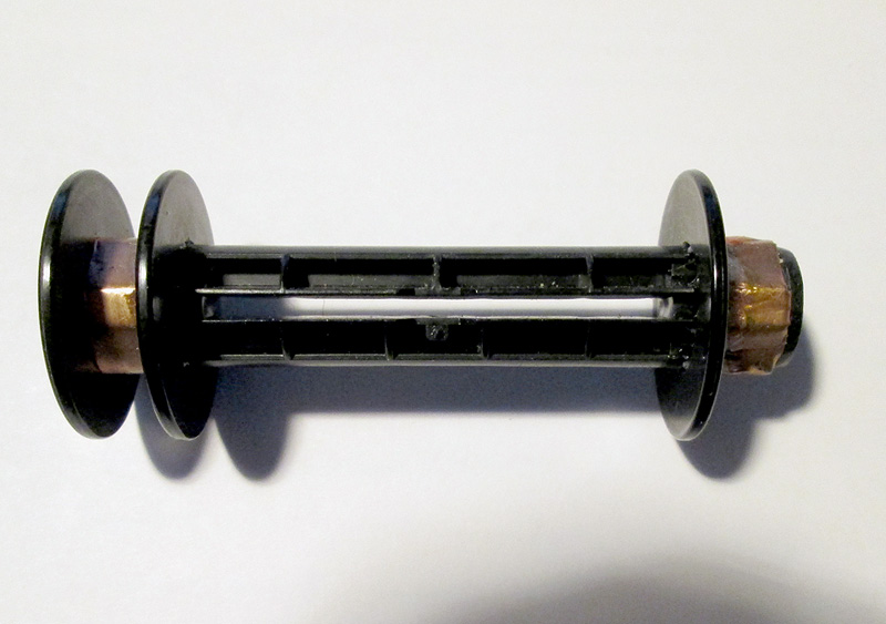

I made some special reels for loading 46 mm films to shoot on any MF cameras that can use 220 films. I have cold stored quite a few 100 ft and 200 ft long rolls of 46mm Kodak 400NC and 400VC in my freezer. Those films are now long expired of course. I figured a way to use them on my Pentax 67-ii. I hope it will yield 7x4.5 panorama shots for me without using and cropping my 220 films. I will need to cut in a darkroom the right length of my 46 mm film out the 100/200 rolls and use leader and trailer paper from 220 films that is trimmed to 46mm wide, Then I can use it just like using a 220 film except it is only 46mm wide. Here are the special reels I converted from 120.220 reels:
