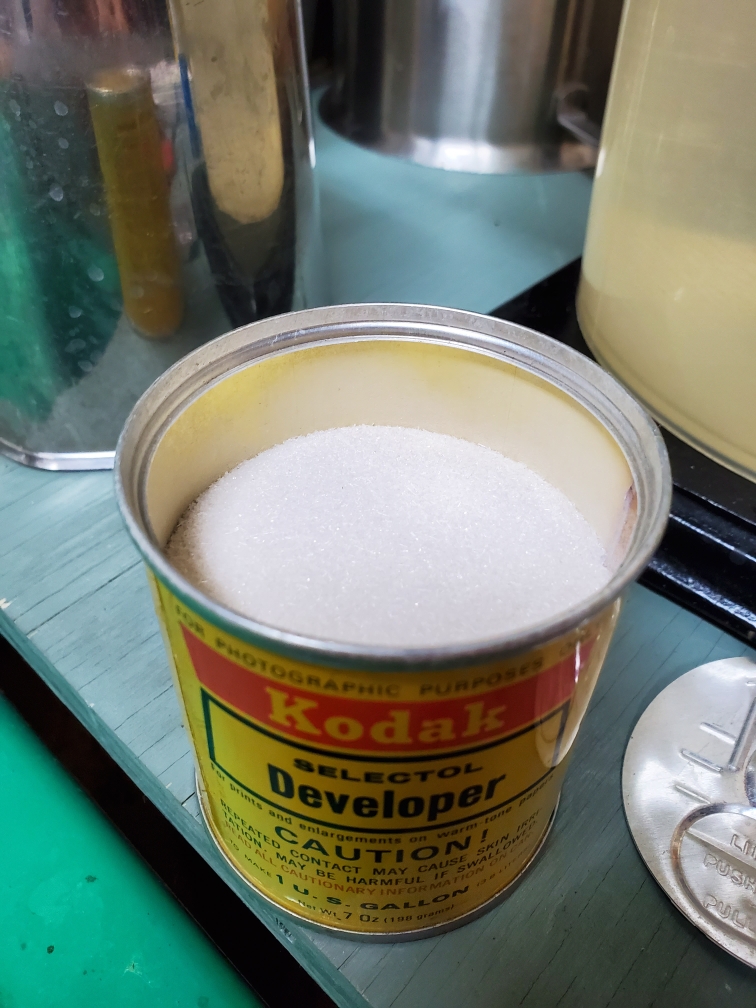

1969 can of Selectol I just mixed up a hour back. Powder was pure, no clumps, white, dissolved perfect.

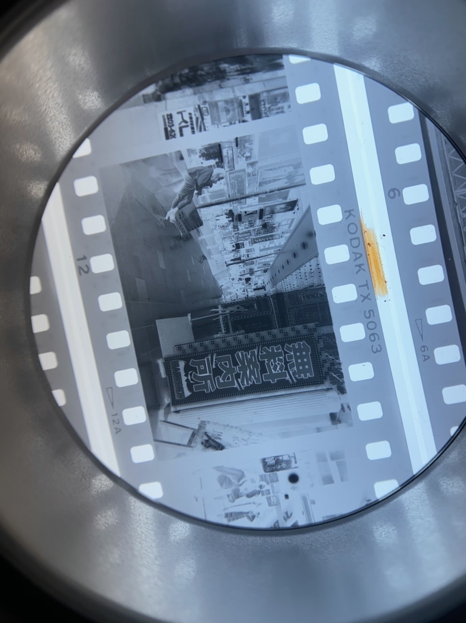

OK. I have a few rolls exp 1988 and more exp 2000. Just shot one of the rolls exp 1988 like I would shoot a fresh roll and developed normally in xtol. Looks good but I haven’t printed anything yet. Base is definitely grey not pink/purple like the new stuff. The base also looks darker. Is this base fog? If it is I assume I would have to give it a little more exposure?
Then again, I haven’t tried printing it yet. It may just print fine as it is.

The box came with a few rolls of Tri-X expired in 1988 and the majority in 2000. Below is what the 1988 Tri-X negatives look like. This was shot the same way I shoot fresh Tri-X. Probably a little underexposed and developed in xtol.
the base looks a little dark compared to fresh Tri-X, but I’m sure I can get prints out of this.
Should I give this more exposure to blast thru the fog? Keep development the same?
thanks.

Bill Burk
Feb 9, 2010
9,153
