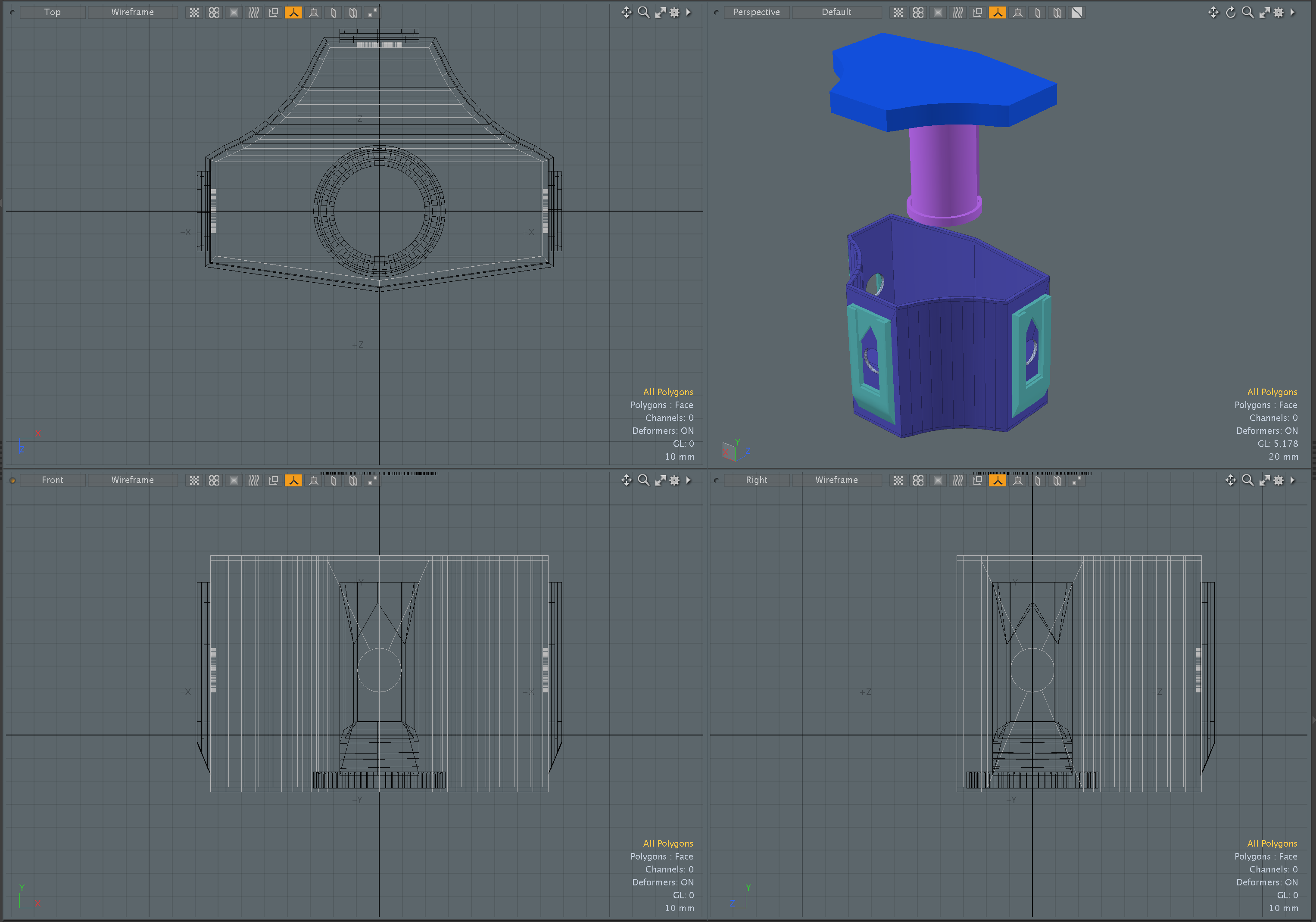

Me too! I have worked out the ray trace maths for the 120 based, 4 hole version with a 225mm diameter core wrap and a 4 X 5 based, 3 hole version with a 44 mm core wrap as a proof of concept. I have that one designed (see image attached of the enclosure design) and will 3D print it later today. With any luck I could have an image from the 4 X 5 version next week. Still wrestling with the design of the120 version. I will need to take a hybrid approach to its construction because of the size so that one is still a work in progress.
