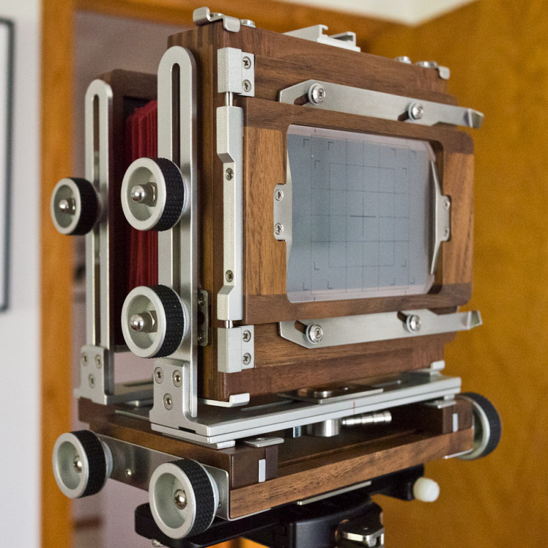

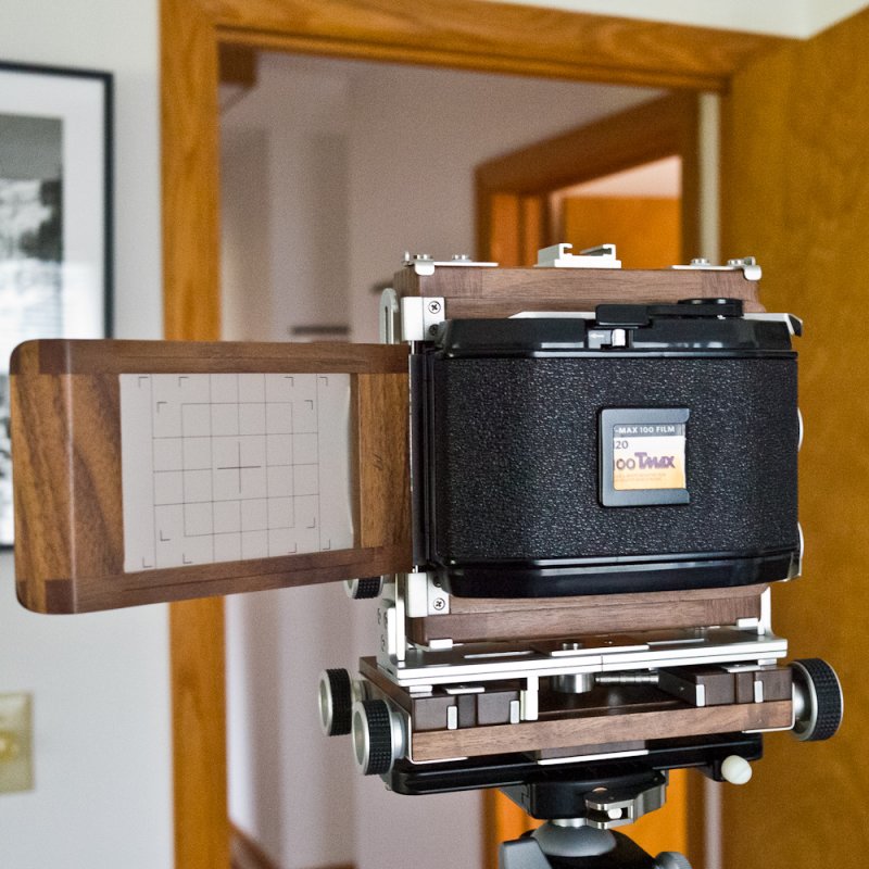

So, I am contemplating the best of both worlds (for me), i.e. a small camera that is easy to setup (and use roll-film!) but with movements like a 4x5 view camera. I came across this Shen-Hao TCF69-A and it looks perfect for what I need, except that Shen-Hao doesn't have a reflex viewfinder for the camera so I would still probably need to use a dark cloth. I noticed that the Shen-Hao natively supports Horseman 69 backs, and I read about the Horseman 69 reflex viewfinders and I am thinking they should fit perfectly (assuming they mount the same way, which I am assuming).
So my question is (finally!) can the Horseman Reflex Viewfinder work on the Shen-Hao TCF69-A camera without making any mods (I suck at mods) and will it register correctly for focusing?

...can the Horseman Reflex Viewfinder work on the Shen-Hao TCF69-A camera without making any mods (I suck at mods) and will it register correctly for focusing?[/U]...
Yes, but only by swinging the Shen-Hao's ground glass frame away and mounting the Horseman viewer's screen/frame combination as one would mount a roll film holder using the Graflok sliders.
...You can view the full post here
The right way to do this and avoid redundant viewing screens is described in detail in post #23 of the getdpi.com thread you linked to. It does require modification of the Shen Hao's viewing screen frame, but results in a much more user-friendly configuration.

@Sal Santamaura - I believe the author of post #23 was referring to his Ebony. The Shen Hao seems to be a copy of the Ebony but with more rear movements. But, you are correct in that the GG needs to be swung out the way, which is what you have to do to mount the rollfilm back.

...The right way to do this and avoid redundant viewing screens is described in detail in post #23 of the getdpi.com thread you linked to. It does require modification of the Shen Hao's viewing screen frame, but results in a much more user-friendly configuration.
...I believe the author of post #23 was referring to his Ebony...
Yes he was, but both the Ebony and Shen-Hao have swing-away viewing screen frames of the same design, so his post is entirely applicable to the Shen-Hao.

I sent Shen-Hao an email and got a response, but it doesn't seem to answer my question (guessing they probably are relying on Google translate). However, I am now fairly confident that this should work just by looking at the images. Thanks for the help!
