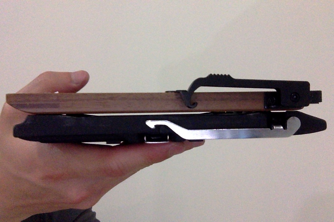

I just got a new Shen Hao HZX 45 camera. From all the research and literature I've read, Shen Hao 4x5 cameras are supposed to come with a Graflok back. When I got the camera, I took the focusing screen from my Crown Graphic Special and tried to mount it to the Shen Hao, but the backs do not match. I've included a photo of the two screens and they are obviously different standards. What's the deal?

Focusing panels don't all interchange between Graflok/International backs. Just use your Shen and stop worrying. Accessories that fit a 4x5 Graflok back will attach to it, and that is what matters.
For another example, my 4x5 Cambo Graflok back's focusing panel won't attach to a 4x5 Graphic. And vice versa. Why should I care?
i was mostly concerned because i have a graflex 23 back on the way and i was worried this might not fit. i guess i'll find out when it gets here.

As Dan said, the focusing screen dimensions can vary for different cameras, but any accessories/holders/backs designed for the Graflok 4x5 should fit. I have a Calumet 6x7 roll fim holder that fits in my Shen-Hao TZ45-IIB just fine.
I recently tried swapping the focusing screen from my Graphic View monorail into my Crown Graphic, but was surprised to find they didn't match. Same manufacturer and only a few years apart, but even these varied in size.

Dave, the Graflok sliders hold accessories to the back. The pins that the focusing panels' hooks grab have nothing to do with the attachments.

Thanks Dan. I had always assumed the pins were the graflok part.
