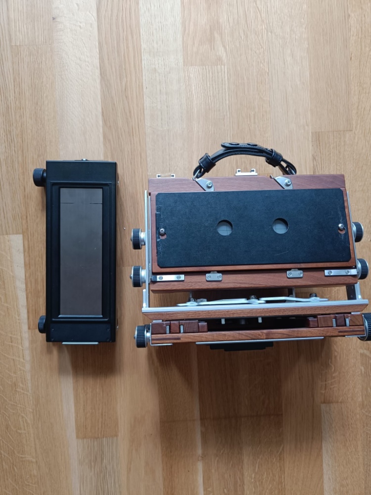

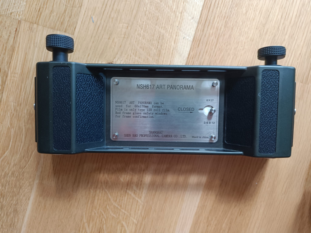

I have the purpose built 6x17 camera. With the matching film back. The back sits pretty tight.

I recently bought a new TFC617-A but sent it back because it had a slight light leak (not as bad as yours) between the camera and the film holder. With the film back on there was just a little bit of play between the film back and the camera back - I could push in the back just a bit when it was fastened on the camera, but I could not find any way to tighten it and did not want to add new light seal foam on a new camera body.

Hmm, I might need to check that again and maybe add some foam The film back I have only has something I can call "black fur" on the edges.

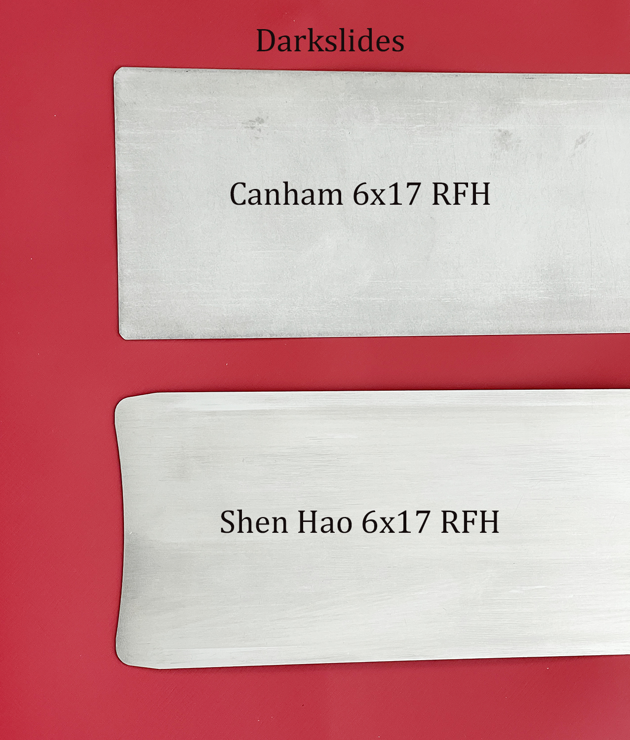

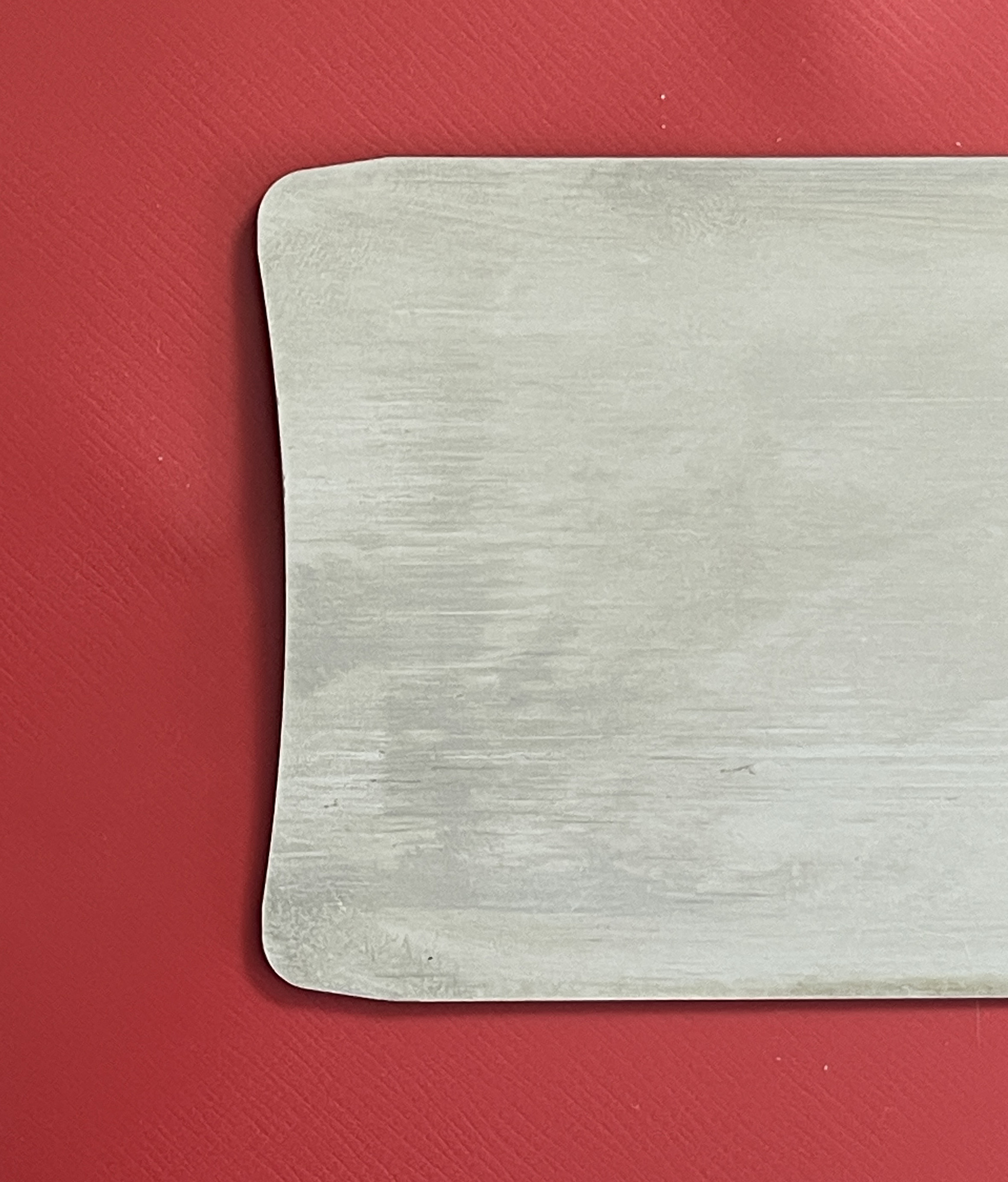

So here's a comparison between the darkslides of the Canham 6x17 automated rollfilm back and the Shen Hao NSH617 rollfilm back. I've never had a problem with the Canham 6x17 RFH, even removing the dark slide entirely for each shot, whereas I've had minor light leaks (between the frames) at the end where the darkslide comes out with the Shen Hao back.

Many roll film holders have slightly scalloped ends of the darkslide. For example, Mamiya RB67, Mamiya Press, and (slightly less scallop) Bronica ETR and SQ. It's presumably for easier insertion. For example, https://ianbfoto.com/product/mamiya-rb67-dark-slide-3/
I don't have any experience with the Shenhao 6x17 back, where there is an issue, it might have to do with the design of the light trap, but the darkslide end shape is not prima facie flawed.
Thanks. I got out my Horseman 6x12 back yesterday and was surprised that it's darkslide was scalloped very much like the ShenHao back, so I guess Mr. Canham's 6x17 darkslide is the exception for rollfilm backs. I do think the ShenHao light trap/darkslide "slot" is a bit wider than other rollfilm holder slots.
