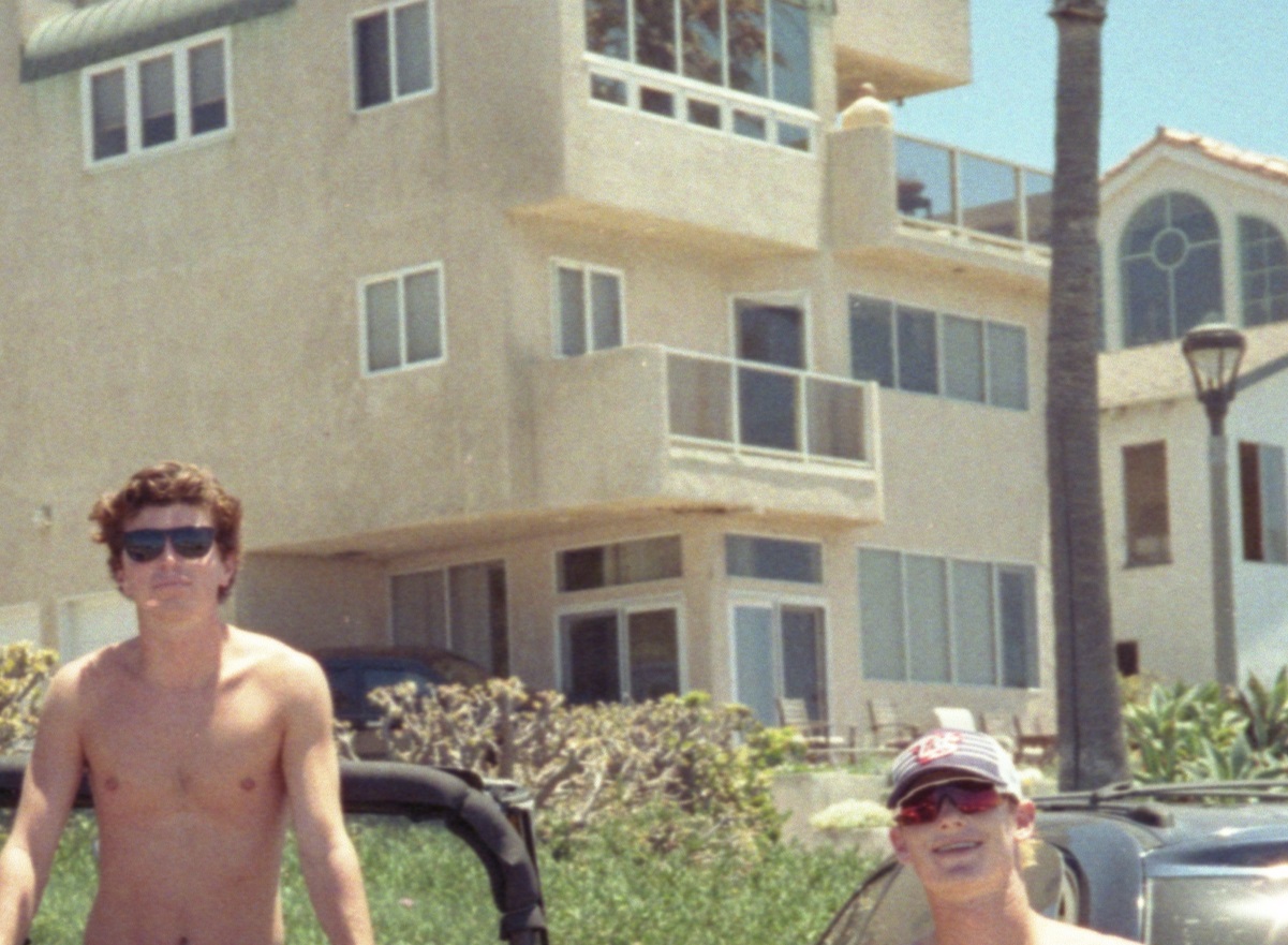

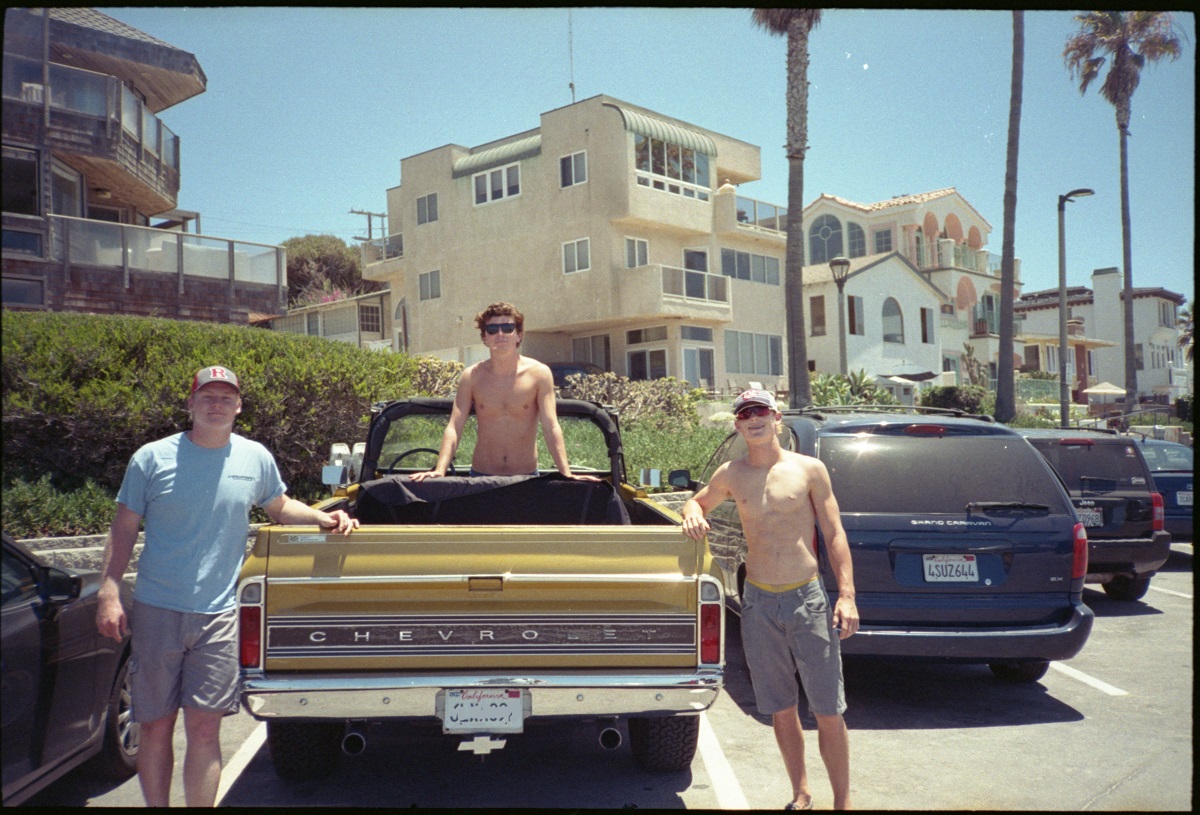

Thanks for all the feedback. On second thought, I'm not sure about the camera shake theory. I could find a few examples where the camera was on a tripod -- and as has been said, it has a distinct look which I recognize.
Here's an example. On the left is the full frame, on the right a 100% crop (from a 1600 dpi raw scan). This was shot in midday sun in LA in July. I usually adjust aperture for the fastest or second fastest shutter speed in a situation like this. The film is Kodak Profoto XL (100) with the camera set to 100.

They're certainly less sharp than some 20 x 16" C-type optical prints I own by a US photographer shot on an XA. A number of things come to mind, a dirty back element, bad scanning or a lens stopped all the way down leading to diffraction. The shots aren't soft enough to suggest a lens problem - though that's always a possibility - it just looks sub-optimal. If you're getting much better results from the T5 with same film and scanner, it's clearly an XA issue. What that issue is may take a little detective work.

The scans are smudgy but could be film/dev/scan issue and not necessarily camera fault.
Film inspection with a magnifying glass and shooting a roll of B&W film like Acros or tmax 100 will reveal the whole story...

I suspect a scan issue. Did you apply any sharpening? Scanning (sampling) is a low pass (blurring) operation and some sharpening is always required.

So stopped down the lens is good. First guess is scanning issue (if using a flatbed, was the film flat or somewhat curled common for Kodak film? To me it looks like a flatbed scan of 35mm, not typically all that sharp at 100%)). Maybe the lens is out of alignment? Here is an example of the xa stopped down at f11 or thereabouts on kentmere 400 developed in hc110 dil h scanned on a Kodak pakon f135+
As one can see, the lens is plenty sharp.
