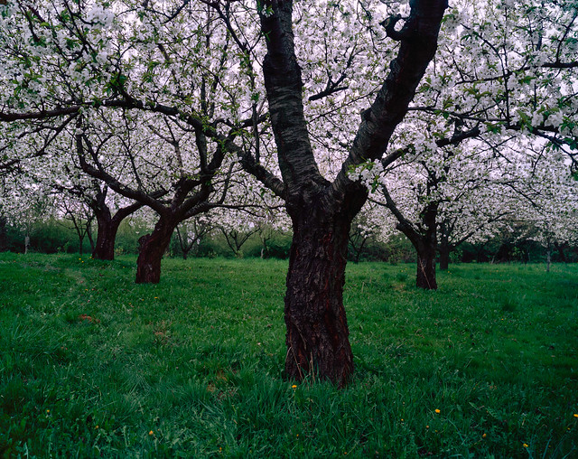

This was my 5th (yes, fifth) reuse of tetenal e-6 kit @8 minutes FD, 11 minutes CD, and BX:
Great Hanami place by JaZ99wro, on Flickr
I always mix up 450ml of chemistry, so I can get 11 batches from 5L kit.

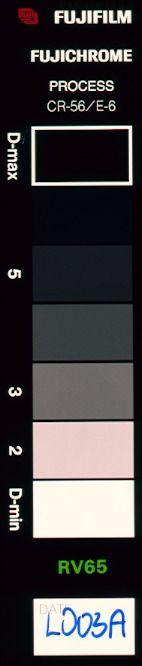

This is the control strip from 4th reuse of another batch:

Jaz, I'm interested if you've got any kind of time-compensation table/formula for reuse? I again gave it 7.30 FD, but this time 6mins CD and 7mins BX (on high-speed '2', the rest on low-speed '1', that's all you get on a CPE2). Like I said, i'm not going to reuse these chems again for anything important, but if I can 'lomo' anything out of them that'll be a bonus...
