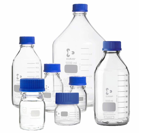

Ever since I started using glass bottles for storing developers (either decanted or mixed from powders) the shelf life increased enormously. My choice is Schott Duran with some Tetenal Protectan spray to top it off when not full to the brim:
These are an initial investment, but excellent in the long term. Good caps. There are other makes that seem identical and can be cheaper, e.g. Simax
The only downside is breakability on a concrete floor.
