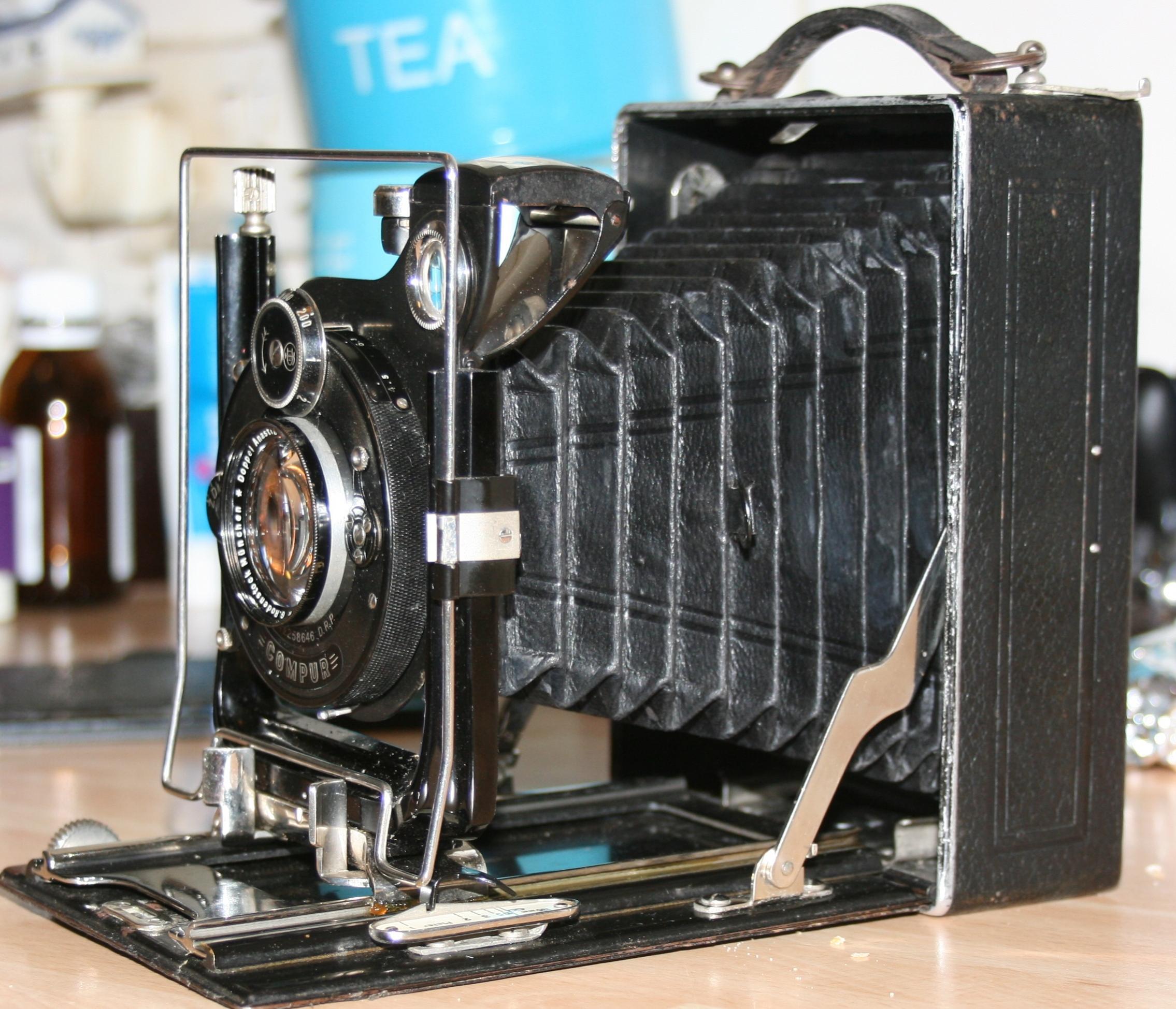

Hi Ive recently acquired a Welta 9X12 plate camera, I have a 120 roll film back for it but I would really like some Cut film holders for it
I have one which came with the camera, but it doesnt fit properly, the lip appears to be too thick for the groove in the back of the camera.
if anyone has a couple of the correct film holders they would like to sell, I would like to buy them.
Thanks
Griff

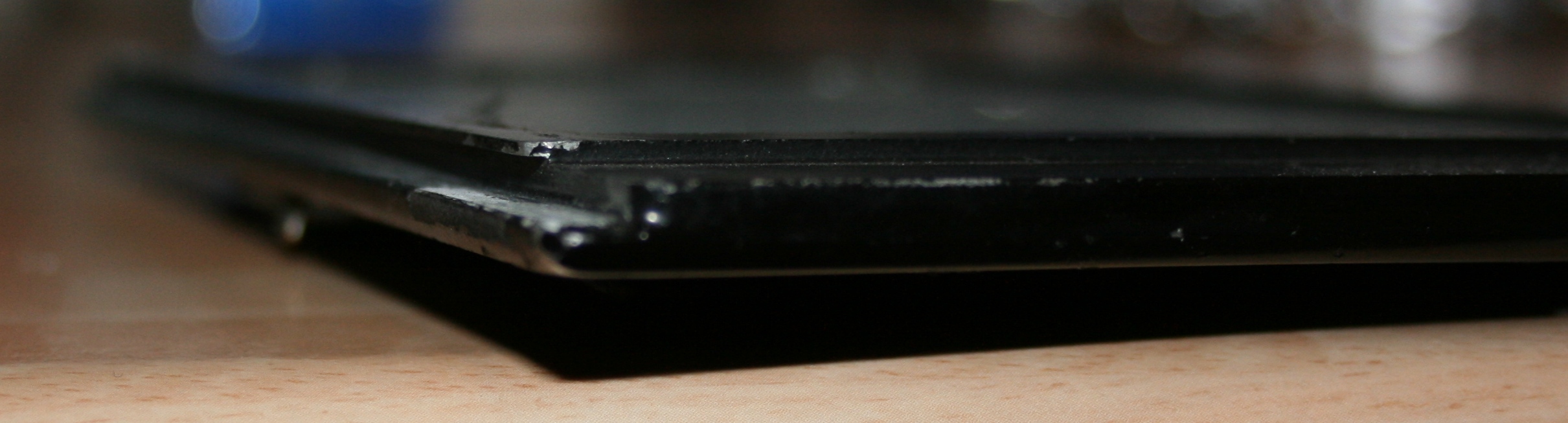

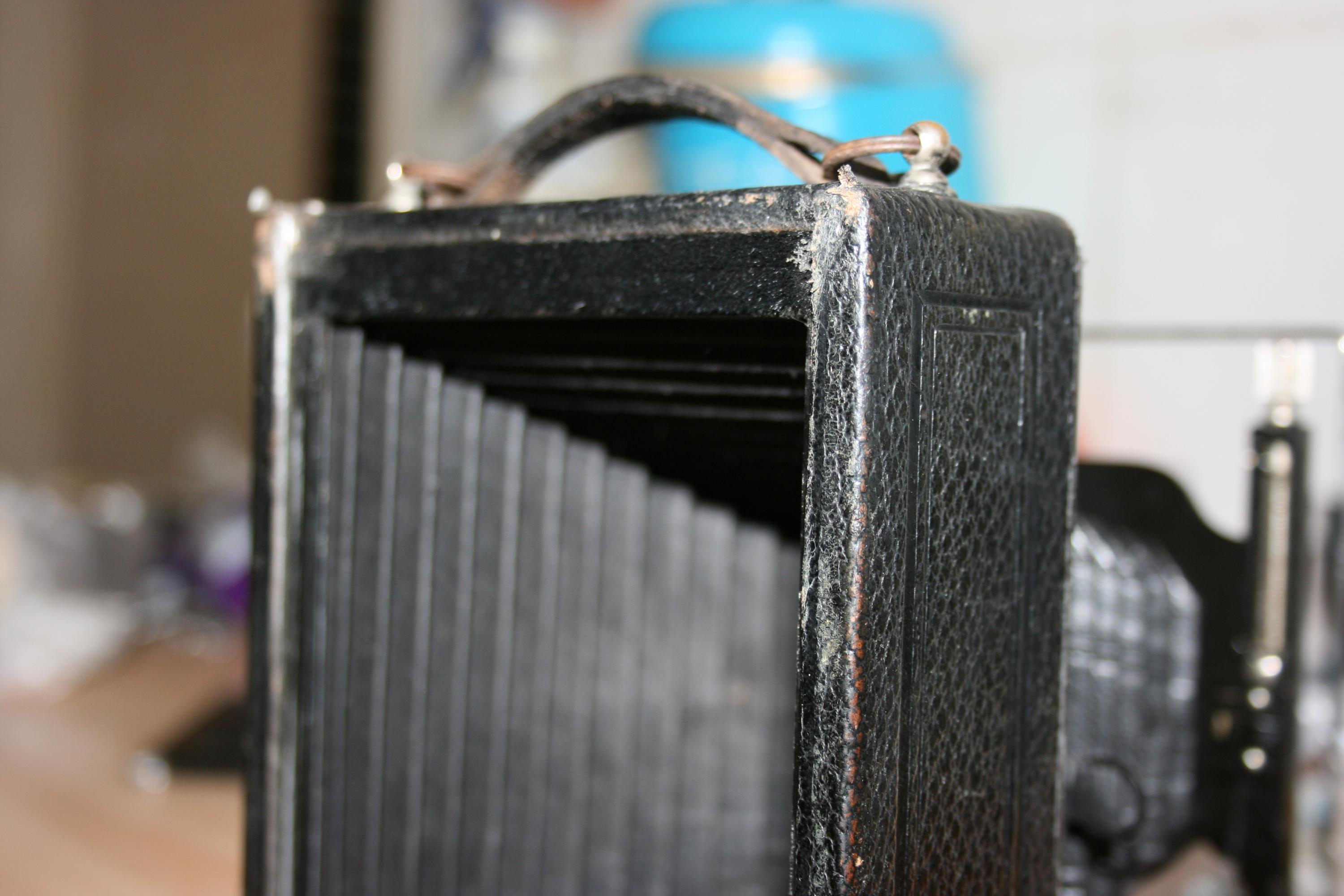

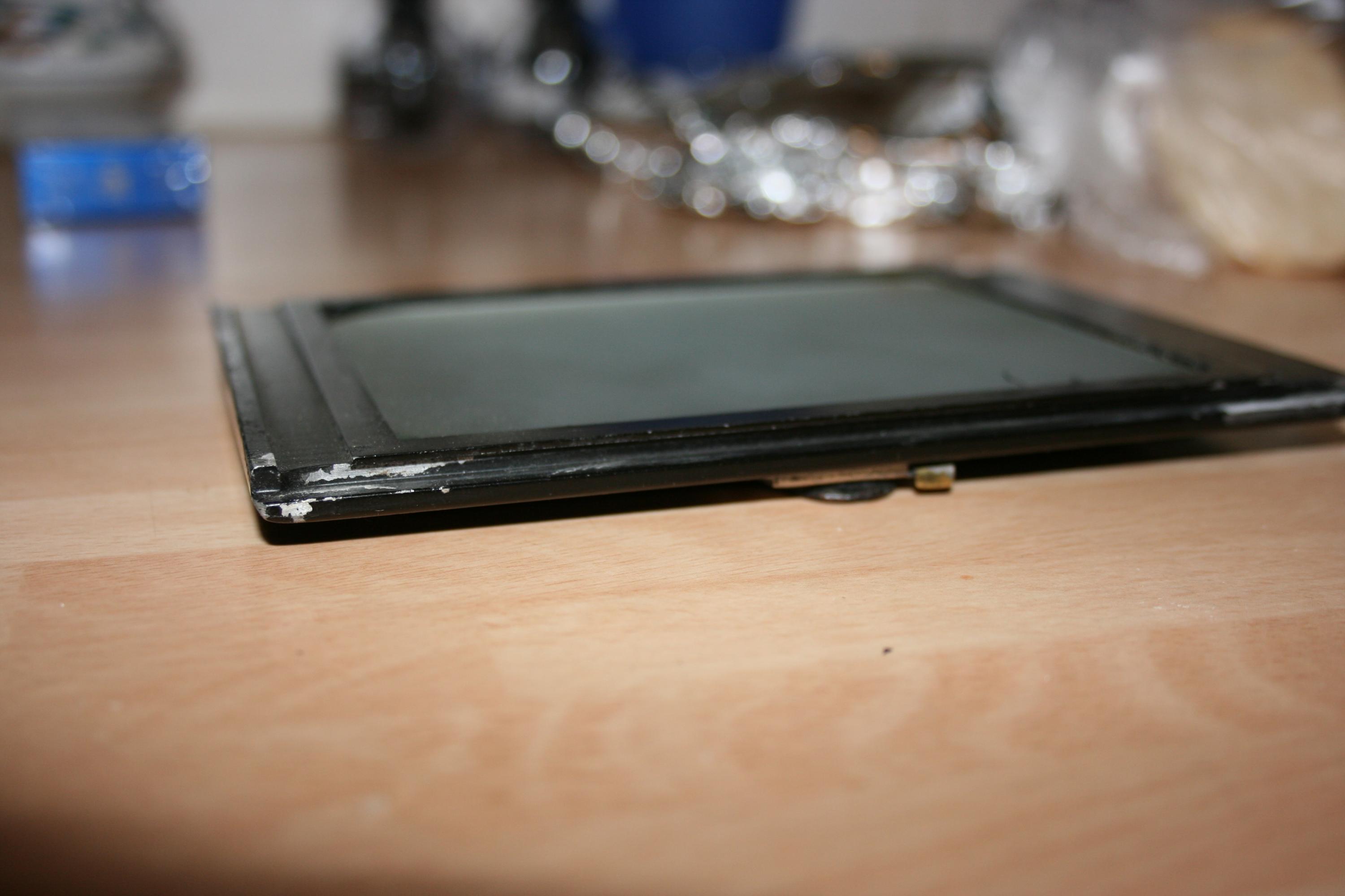

Thanks for the reply, I am trying to upload some pictures that you may be able to recognise the type from
attachment.php
attachment.php
attachment.php
attachment.php
I hope these are clear enough to tell
Thanks hope to hear from you soon

Sorry, The pictures aren't clear enough for me to see what the spacing might be on the side channels or the thickness of the flange that slides into the camera. Can you send me any measurements?
I have lots of plate holders, with film adapters, that I will happily supply to you for a donation to APUG, but I want to send the proper ones the first time.
Whitey

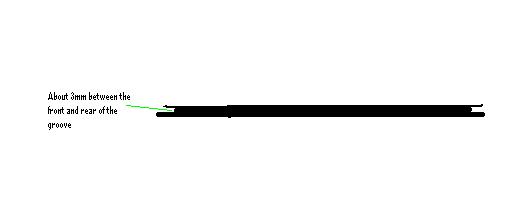

Gents, Than you so much for your efforts, I really appreciate it, I have taken some measurements from the focusing screen plate, the part which actually fits against the camera is 100mm from edge to edge across the width, and 150mm edge to edge in length, the lip which fits in to the camera groove is about 0.5 mm thick, and the distance between the lip and the back of the plate is around 2.5-3mm wide to allow for the thickness of the camera groove and the leather covering, I ve done a rough diagram in MS paint of all things I hope that this might help!!

Here is a link to a RADA Mettallwarrenfabrik catalogue I finally found and put in my dropbox. Feel free to download it. It lists the Welta plate as similar to the Contessa-Nettel as well as the Steinheil and ICA cameras. Ian has those as different plate holders and he is working from real info, not an old catalogue, so I don't know if it will help. I think I have a few of the ones you need, one here at home and a few more at the warehouse. I'll get four or so together if I can and mail them to you. If they fit, send a donation to APUG for what you feel they are worth. If they don't maybe you should buy another camera that they will fit? or give them away.
