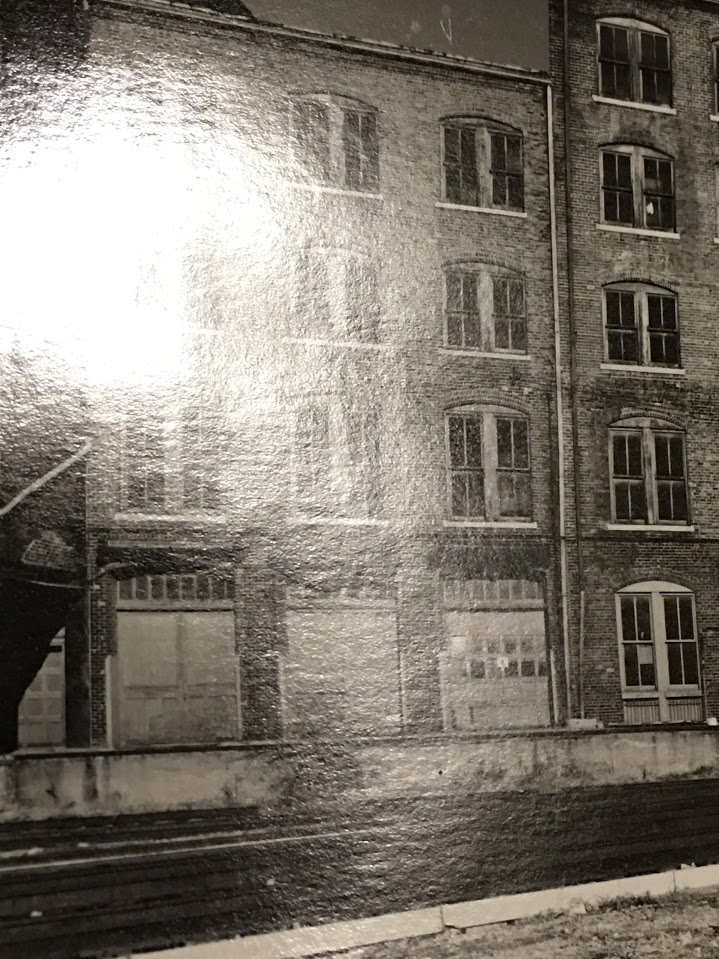

The following image below was printed on double weight, fiber base Ilford Multigrade Classic, selenium toned and air-dried, on window screens as described by others here, for reference. In the edges of the shiny area, it's fairly representative of what that paper looks like, for comparison with pearl.
I find the sheen of this specific paper to be much more brilliant than most of the other FB-DW papers I have printed with.

Thanks for that effort.....and a beautiful frame BTW.
