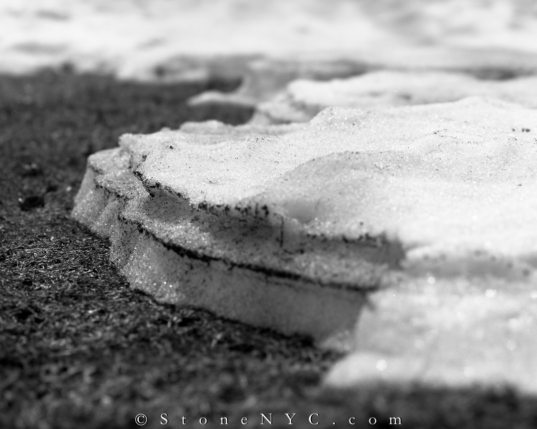

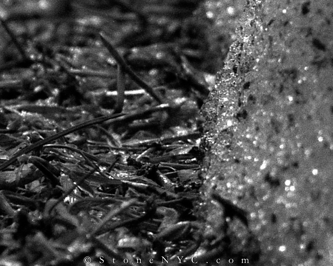

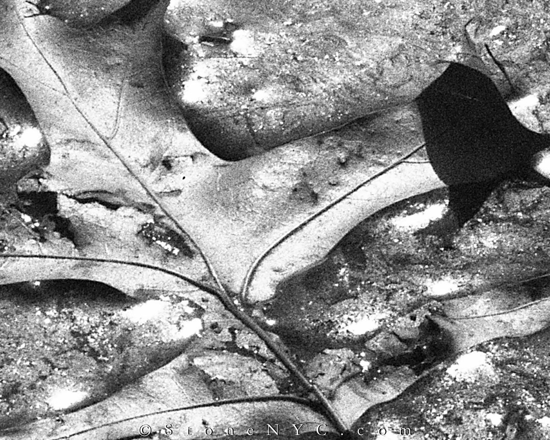

Example 1
Full image
1:1
Example 2 full image
1:1
Nothing has been done to the images in post.
Happy and satisfied Stone :smile:
