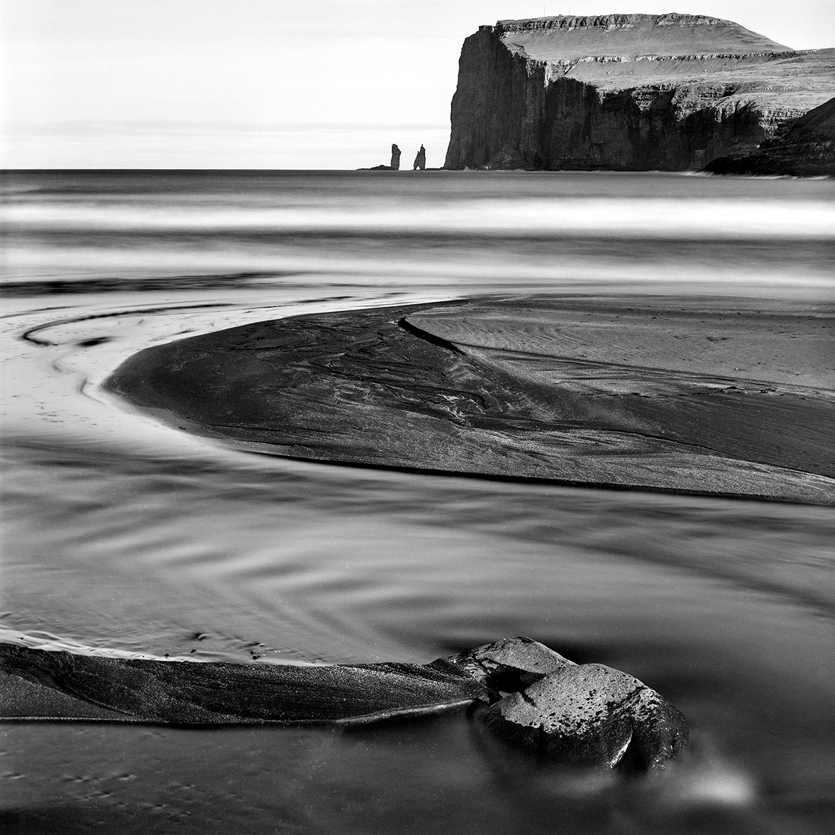

Flexbody w/ rear tilt, 100mm CFi, Efke R25. Tjørnuvík, Faroe Islands...
As expected a superior depth of field with the FlexBody and I expect the same with the ArcBody. Since I use mostly ISO 400 film and a tripod when necessary, I have not had an occasion that I did not get the depth of field that I have needed, so do I really have a use for the FlexBody or ArcBody for a "straight shot". It is the "perspective control" photograph [looking up at a building, looking at an angle at the length of a building] where I expect these two bodies to shine. So how much would I, or others reading this thread, use this camera? Would I want to take it to, for example, Europe on a trip when I am carrying the SWC, 50mm and 80mm lenses? That is the hard part. If the answer to that is yes, then it comes to what does one give up to have the money to purchase it.
Ai Print
May 28, 2015
1,292
Colorado
I often use longer than 80mm lenses for landscapes to strengthen the compositions and this is where the Flexbody really shines. The image circles are larger in longer glass but the depth of field gets shallow real fast so in order to avoid always being within a stop of minimum aperture, the Flexbody gives me a lot more options.
For example there is a shot I did that has a rock outcrop that is about 40 feet away and that same island in the shot above in the far distance. In order to make a strong composition, I used a 1.4X on my 180mm giving me a 250mm. Both are sharp with careful placement of focus and swing as I turned the camera 90 degrees on its side to achieve it.
Only you can decide the value of any tool, to me the Flexbody is an extremely important tool, I now have two of them.
