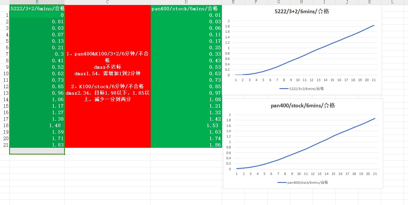

Added down are sample images and data, the sample images are from Ilford pan400 and the data is done peeled:

For this recipe, I tried using 3 grams of hydroquinone II not sodium VC at first. After comparing later, the DMAX will be higher with sodium VC than with hydroquinone if used for the same amount of time.

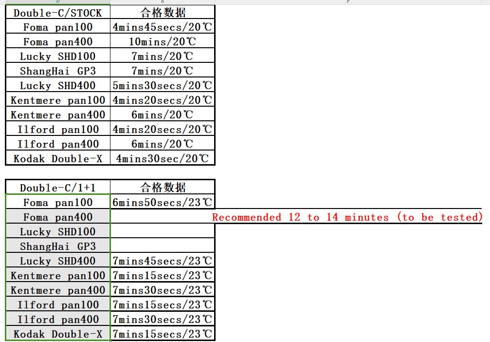

In the last few days I've done tests on different films, here's some development time, to be followed by tests on foma 200, ilford delta100/100, HP5, Svema Foto100/200 and FN64.
