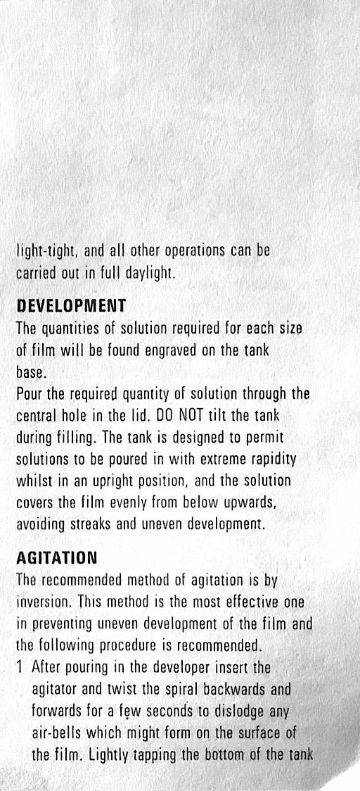

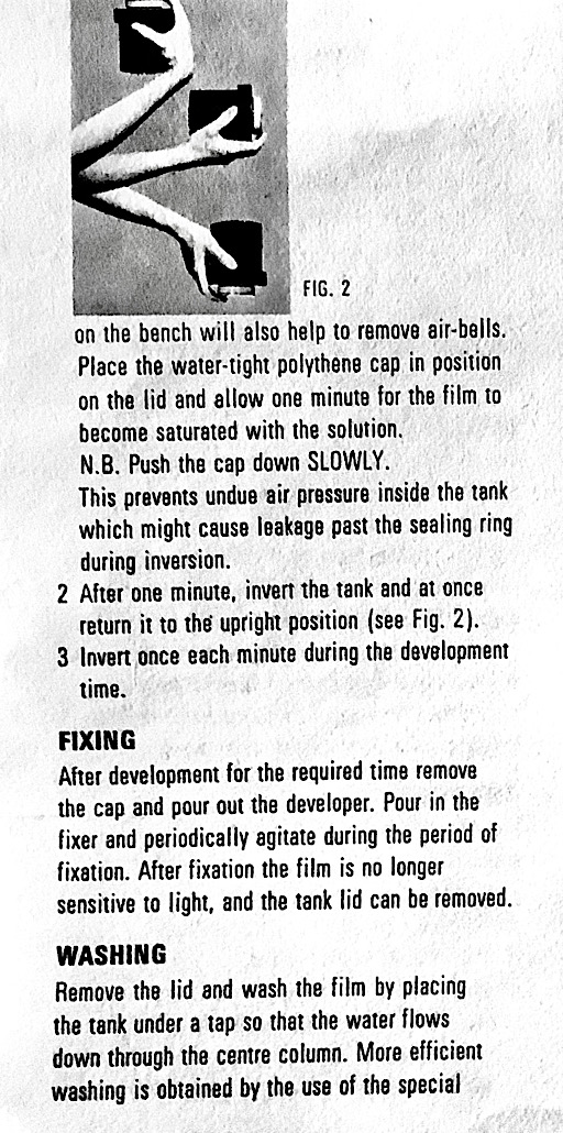

From the Paterson System 4 instruction book
Thanks I had not realised that the official Paterson agitation method was as gentle as this. So a few twists with the stick then nothing for a minute then only one agitation per minute. In say a 10 minute development time this is a few seconds twisting and then 9 inversions only Quite far removed from either the Ilford or Kodak regime which in turn are quite far removed from the guy making cocktails

I do exactly what the Paterson instructions say. When twisting, the backwards and forwards part is important, because you probably don’t remember which way your spirals are facing. Twisting for the first few seconds means the chemical gets to the film evenly straight away, rather than waiting while you fumble with the lid. (The instructions posted above show the early System 4 tank, which had a simple small push-on lid. The later Super System 4 has a wider opening allowing faster pouring, but it takes a little longer to get its wider lid seated all the way round, so the twiddle stick makes even more sense.)
During inversion, it takes time for the chemical to flow around the outside of the tank to the lid, and likewise back down through the funnel. Two inversions in 5 sec sounds about right. There has been some previous discussion on the forum about foaming, which seems a good reason not to be too vigorous with agitation.

I invert the tank by turning the wrist instead of the arm like on the pictures. Getting leaking chemicals on your arm and shirt is a bad idea. Dermatitis from metol, bleached skin spots from hydroquinone, cancer from benzenes...
