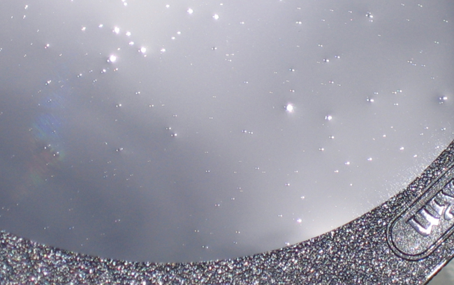

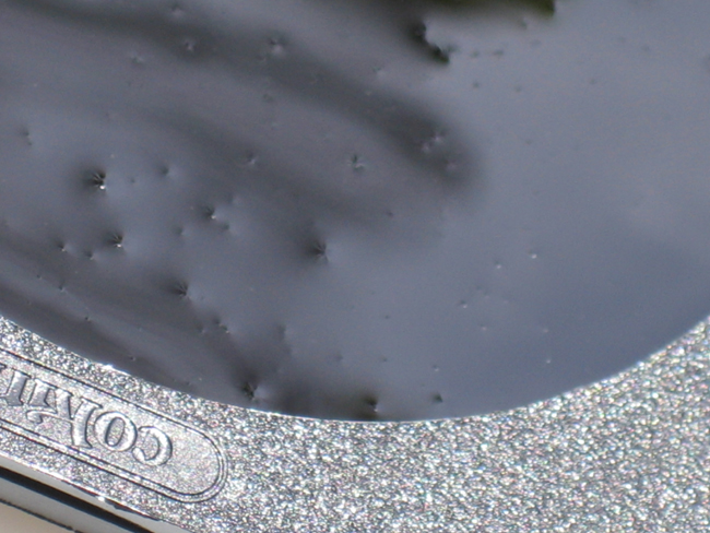

I was happily clicking away at my first roll of SFX 200 today, using the supplied filter from the value pack. I felt a fine mist of water from a fountain in the foreground I was shooting. Low and behold, when I removed the filter after my shot, I saw many fine little pin sized divots into the filter. At first, I thought it was still the droplets of mist, but I could not wipe them off- It's like the water dissolved the filter. Now, I realize it's a gelatin filter, and it was essentially free with the 3 packs of film, but come on! I would expect something a *little* more durable. It's like it was made of jello gelatin! Did I get a dud? I don't think so, as the build quality is quite flimsy, and the filter itself is super thin- I guess just what you'd expect in a promo pack......I must say I'm a bit disappointed. Is there any way I can salvage this filter? I believe it's essentially an 89b, correct? I guess I'll just have to buy the real filter...... What *is* the cokin filter number/name equivalent to this promo one, anybody know?

Nope.
It's a gel filter. Same as Kodak Wratten filters. And yes, it's made out of jello gelatin, hence the name. I've already wrecked one gel filter so far.
Polyester filters would be better but still cheap, but nobody makes an 89 polyester.
The Cokin 007 would probably fit the bill. Or a screw-in IR filter.

You could try a Cokin P series 007 (Wratten 89B)
or B+W 092
Cokin makes an IR filter:
Dead Link Removed
According to the above URL, it transmits 50% @ 720nm. I have this one; it works quite well.
It may be worth pointing out that the Ilford/Cokin SFX filter available separately is the same filter as supplied in the promo box so if you do not want a gel filter which is easily damaged, the Cokin A007 or P007 may be a better bet. B+W and Hoya also make glass Wratten #89b compatible filters.
