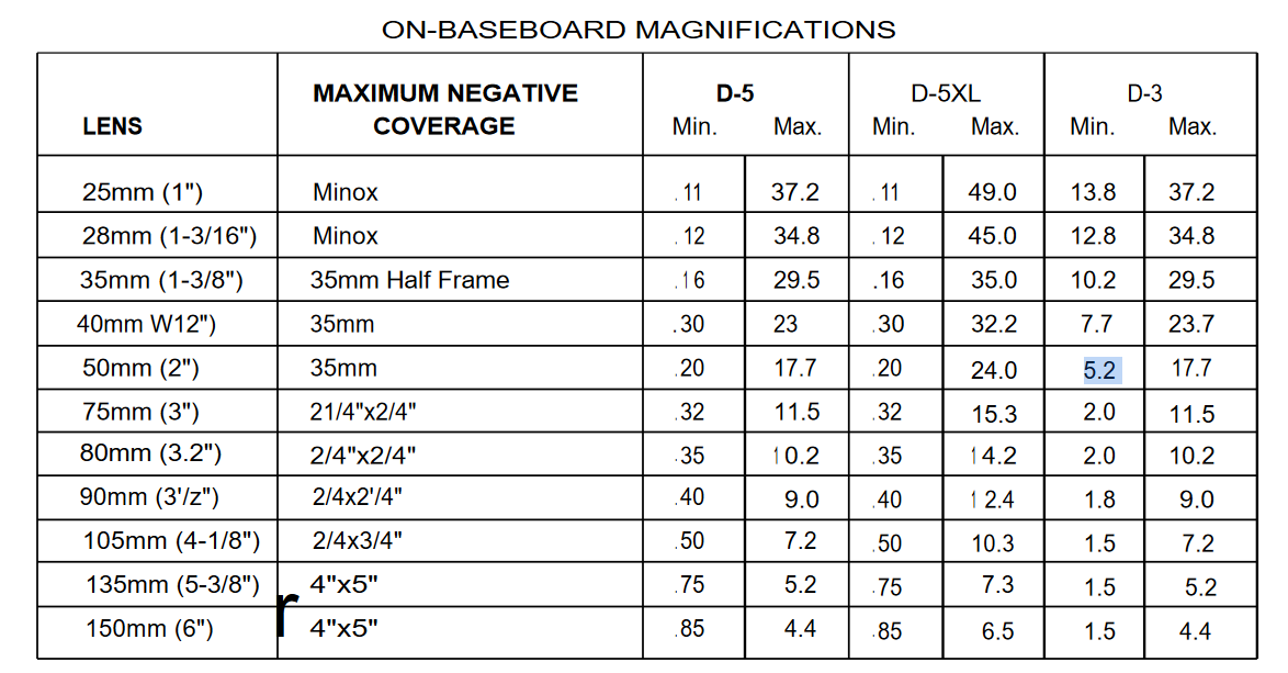

The minimum magnification for a 50mm lens in the flat mount on a D3 is 5.2x.

Using the Omega D2 as an example, the magnification range of an 50 mm lens mounted on the 421-100 flat lens disc is 5.2X. If you enlarged a 35 mm negative (24 mm x 36 mm) using a full-view glass carrier, the smallest projection is 124.8 mm x 187.2 mm = 4.9” x 7.3”.
This is given on page 6 of the D2 manual. Page 7 shows the four different condenser positions for the variable condenser unit in use with the range of focal lengths for which it’s intended.
The minimum projection with an 80 mm lens is given as 2X on a flat lens disc. That give a 35 mm negative projection of 48 mm x 72 mm. = 1.9” x 2.8”.
