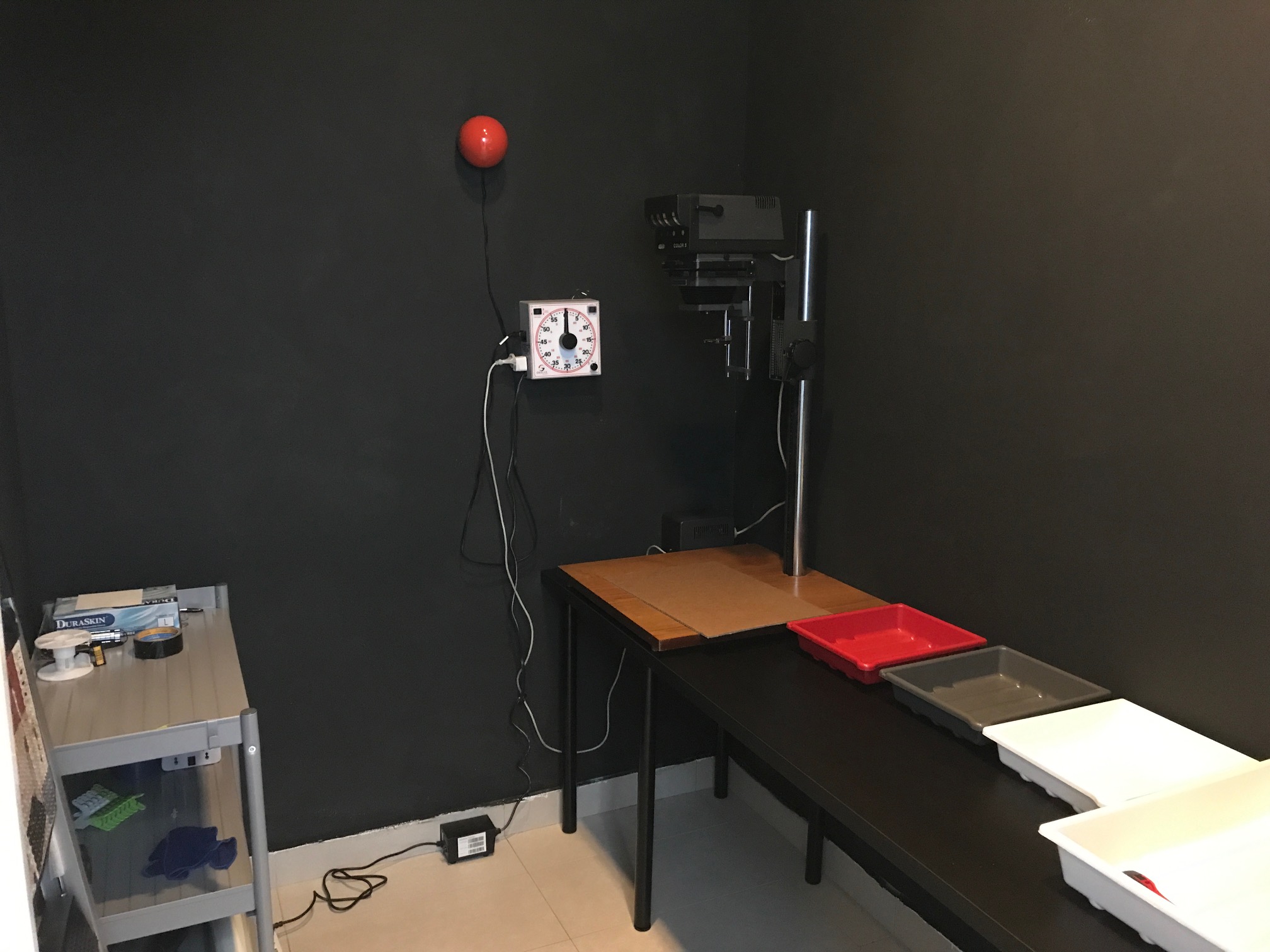

Wow what a day. This morning I went to see the Meopta enlarger........... it's in great working order but only comes with a 105 lens. I'm thinking I can use it for contact prints until such time as I can get an 80mm lens for printing 6x6 negs.
I got chatting with Mr Ng and I mentioned to him that eventually I want to get a 4x5 enlarger. He said come and see this. He had a fantastic looking Durst 4x5 enlarger with all the trimmings.......... I say that, Mr Ng said he needs to round Everything up to make sure all is there and if so I can have it for $1100 bucks.
The color Meopta has built in filters but I have no idea really how to use it but I will have fun trying it all out.

Why are you painting it dark? You want it light (beige is good), except possibly right behind the enlarger.
Opps thats a screw up then......I figured I needed the dark room matt black. The one i did my darkroom class in was Black??

You can use the 105mm lens for 6x6 negatives, you just will not be able to do maximum enlargements of any negative that the enlarger is capable of doing with the correct format lens.
My darkroom is white, it reflects as much safelight as possible. I have a white ceiling, one of the safelights faces the ceiling; this gives my darkroom a nice even light. I have two other safelights, one over the dry area, the other over the wet area. I can switch them on and off individually.

I also have a light (a shade of beige!) coloured darkroom with the safelight facing the roof.
