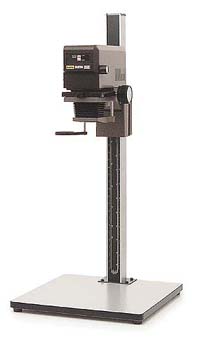

The two enlargers I have set-up are De Vere models which are extremely robust but probably rather over-the-top for 35mm work. In your situation I might be tempted to look at a 'Kaiser' model as these are still available new, have spares, and also a large range of accessories. Another enlarger I have, the Meopta Magnifax 4a, is also solid, but slightly agricultural in construction, and while Meopta were a popular make in the UK, spares and accessories don't seem to be available in over-abundance today.
https://www.kaiser-fototechnik.de/en/produkte/index.php?s=19
