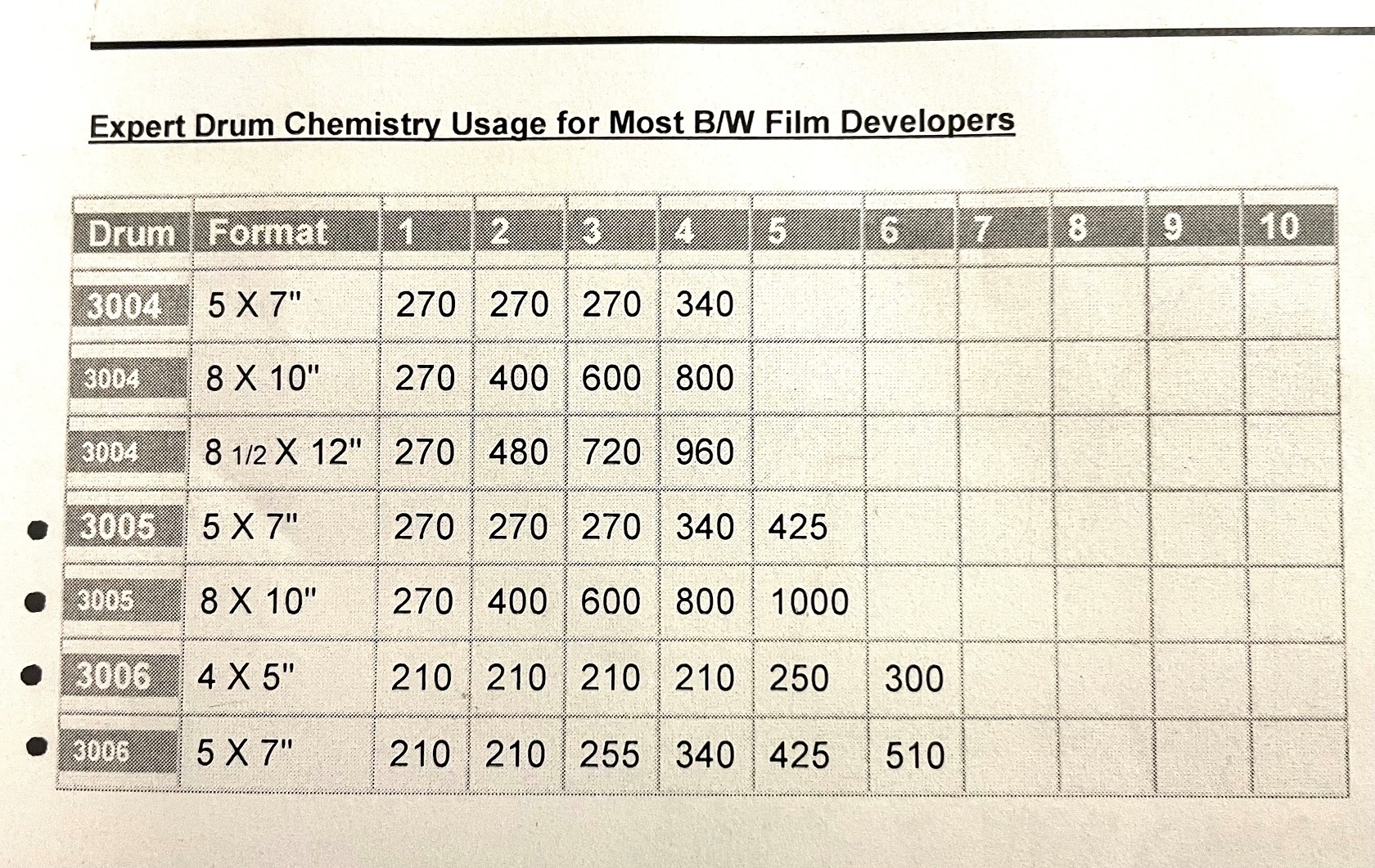

I plan on starting with either D76 Stock or D-23; haven't made up my mind.
As for volume, I will use the stated volumes in the Jobo manual for expert drum B&W developers.
Upon reflection, I probably won't push the results to smaller sheet film, as I will be developing that with another system.
I really do not plan on processing sacrificial sheets to maintain a full load each time, as I am not the caliber of John Sexton or Ansel Adams.

Ha, Kino - you'd be surprised just how often AA's negs were unevenly processed, and what kind of printing headaches that caused. Don't be intimidated by the reputations of those before us. They didn't do things perfectly either. But you do need to be patient and work through any of your own potential bellyflops. Experimentation is the name of the game. Start with your best shot. You'll improve with experience. But for me, tray processing of sheet film proved to be much simpler.
Sacrificial sheets do nothing worthwhile in a drum. But sufficient fluid volume does count. Sometimes you need more volume in the drum simply to keep the flow pattern consistent or prevent undue oxidation of the developer. Rotary processing is pretty aggressive, especially since Jobo units run at a somewhat higher RPM than I would prefer, even at the lower settings.
What you will probably discover is that D76 STOCK solution is probably too strong and fast-acting for rotary work. 1:1 makes more sense, especially if using it one shot. You also have to keep in mind, if you don't already know it, that D76 either needs to be standardized fresh, just mixed, or after a week or so - time needed to allow the developer to pH stabilize. It shifts.
