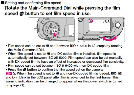

I have recently changed to film coming from digital, and think that films such as portra 400 have an iso of 400 already set on it?
There is an iso button on the Nikon f100, though are unsure of what i should do now if I am shooting in manual to get the correct exposure. I haven't been able to find much info out there
Thanks

At some time there was "DX-coding" installed on type 135 cassettes (most common 35mm cassettes).
Respective cameras could read various information from the cassette, in all cases though the film speed. With the more functional cameras there was an override to set film speed manually.

Your Portra has a DX code - a barcode system stating ISO, printed on the film canister, so the camera can identify it.
ISO setting will not affect the film - only the light meter reading and the exposure.
Manual ISO setting is used for films without DX barcode or to over - or underexpose your film.
For example : Setting your Porta 400 to ISO 100 and you follow the meters settings you will overexpose your film by two stops.

Use the box speed which is set by the DX code unless you have a really good reason to deviate such as using the Zone System. Do not blindly change the ISO.

I don’t know if it has been mentioned to the OP, but the camera is not going to use the dx code unless it is set to “dx”. If it is set on 100 and you insert a cassette with a 400 dx code, it will stay at 100.
At least, that is how my n90s works.

Do you mean if I’m using Portra 400, set and keep my iso at 400?

The camera has the option of automatically setting the ISO if your film cartridge has DX codes on it AND the camera speed selector is set to "DX".
If you DO NOT have the ISO setting on the camera set to "DX", and have it set to, say for sake of argument, 800 when you actually have 400 speed film in the camera, the camera WILL use 800 and override the DX cartridge. This is on purpose so more experienced users can manipulate the film speed for their purposes.
For the time being, just set it on "DX" unless you are using NON-DX coded film cassettes.

When you set the ISO to DX, the camera will automatically read the film cartridge and set your camera ISO to that setting. The ISO will not adjust until you put another roll of film in, because the film's ISO isn't changeable. The camera will meter and its automatic exposure will work accurately with the film you have in the camera.
Forgive me if I am being too simplistic. I'm not sure how much you know.

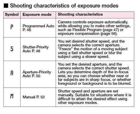

Personally, I suggest you study and use the Shutter Priority, Aperture Priority and Manual modes FIRST; leave the Program mode alone for the first roll, as that is just automatic.
Now it's time for you to go and read that manual.
macfred
Nov 6, 2014
3,839
Germany
Thank you I just found this. So by setting this to DX, The iso-adjusts accordingly to the shutter and aperture I set?...
Nope - it's the other way round ...
If you are in Manual-mode and you set the aperture, the exposure meter of the F100 will show you the adequate shutter speed you'll have to set to get a correct exposure (according to the ISO of your film).
Or you're going to set a shutter speed of -maybe- 1/250 sec, the meter will show you what aperture you have to chose (according to the ISO of your film).
In A-mode you set the aperture and the meter sets the adequate shutter speed automatically (according to the ISO of your film).
In S-mode you set the shutter speed and the meter sets the adequate aperture (according to the ISO of your film).
