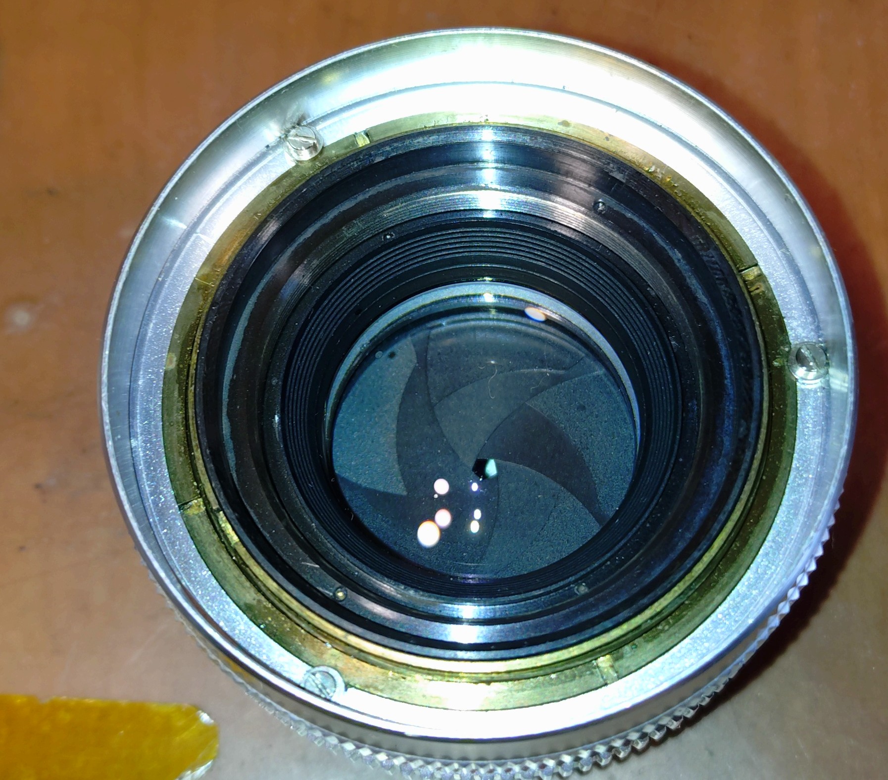

Opening the lens simple ,
-Unscrew the center of the holding ring ( aka the inner sliver ring)
-Lift up the outer Name Plate Right
Then you can see the design is almost same as the modern standard: 3 slotted screws with washer underneath to hold the main lens body.
Slightly loosen these 3 screws and turn the slotted brass to make the lens reach the correct infinity with distant object. You can work out this with a Kodak Retina Reflex (S/III/IV) or put a focusing screen at the back of IIIS with Shutter open at B (Bulb ) .

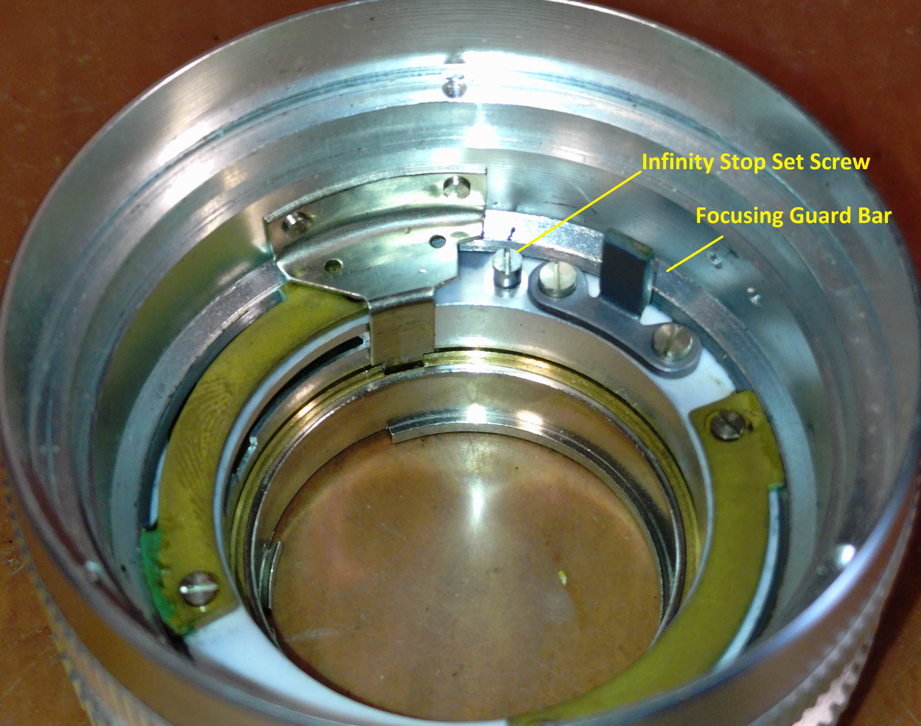

When these 3 screws/washers have been removed, you can take out the WHOLE brass lens unit from the focusing ring.
You will see a metal coupling bar that connects the focusing ring to the brass slope ring below.
When focused at infinity, the coupling bar will be stopped by a tall screw. This is the Infinity Stop Screw. You will find this screw can’t be takeout but rotated in an offset way.
Put this focusing unit back on IIIS camera, and set it at infinity, and turn this Infinity Stop Set Screw slowly until the RF image is right at infinity. This is the solution for (2) .
Reinstall the brass lens unit. Make sure the Focusing Guard Bar and the Aperture Bar have put into right place on the brass unit.
Reaffirm the image is sharp at infinity by checking with Retina Reflex (S/III/IV), or put a focusing screen at the back of the IIIS with opening the shutter at B using the method as mentioned for (1).

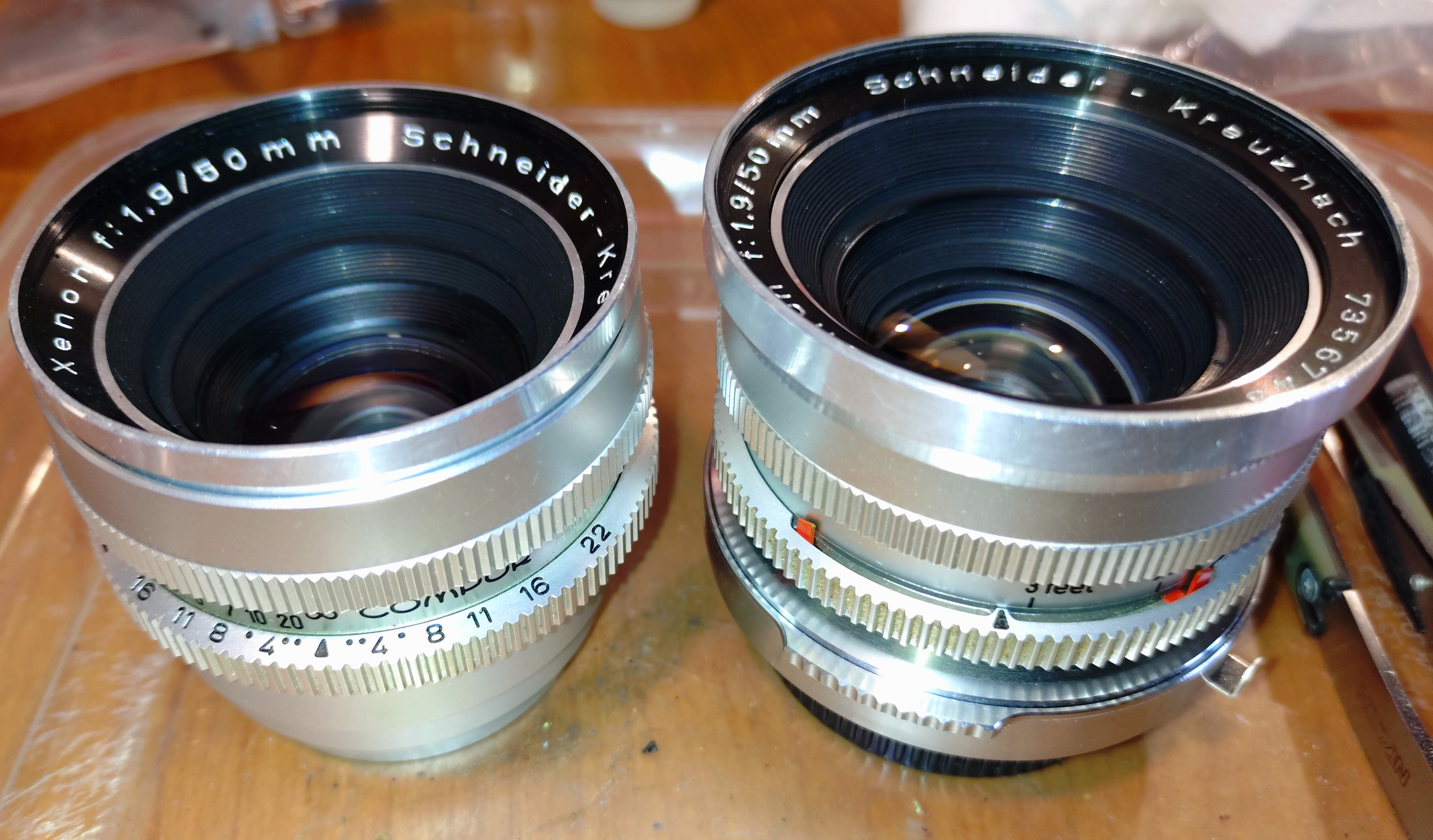

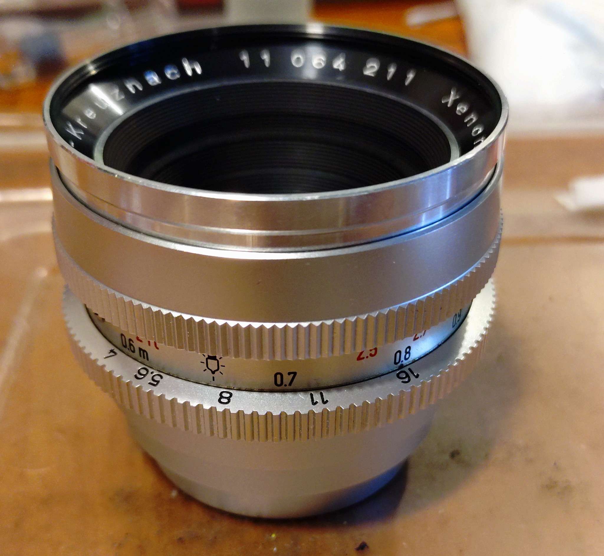

The thin and thick version of Xenon 50/1.9 . They are optically identical in glass design and arrangement.
The thin version is actually for the Kodak Instamatic camera that uses 126 film . At that time Kodak has decided to let their DKL lens last stand on their instamatic reflex only. This camera , the Instamatic Reflex could be with 45/2.8 or Xenon 50/1.9. The 45/2.8 is another story, which focused by moving the front group of glass for focusing.
As you can see from the here, this thin version has the mechanical DoF replaced by the marks on the mount. There is also an index for (now obsoleted) bulb flash below it :

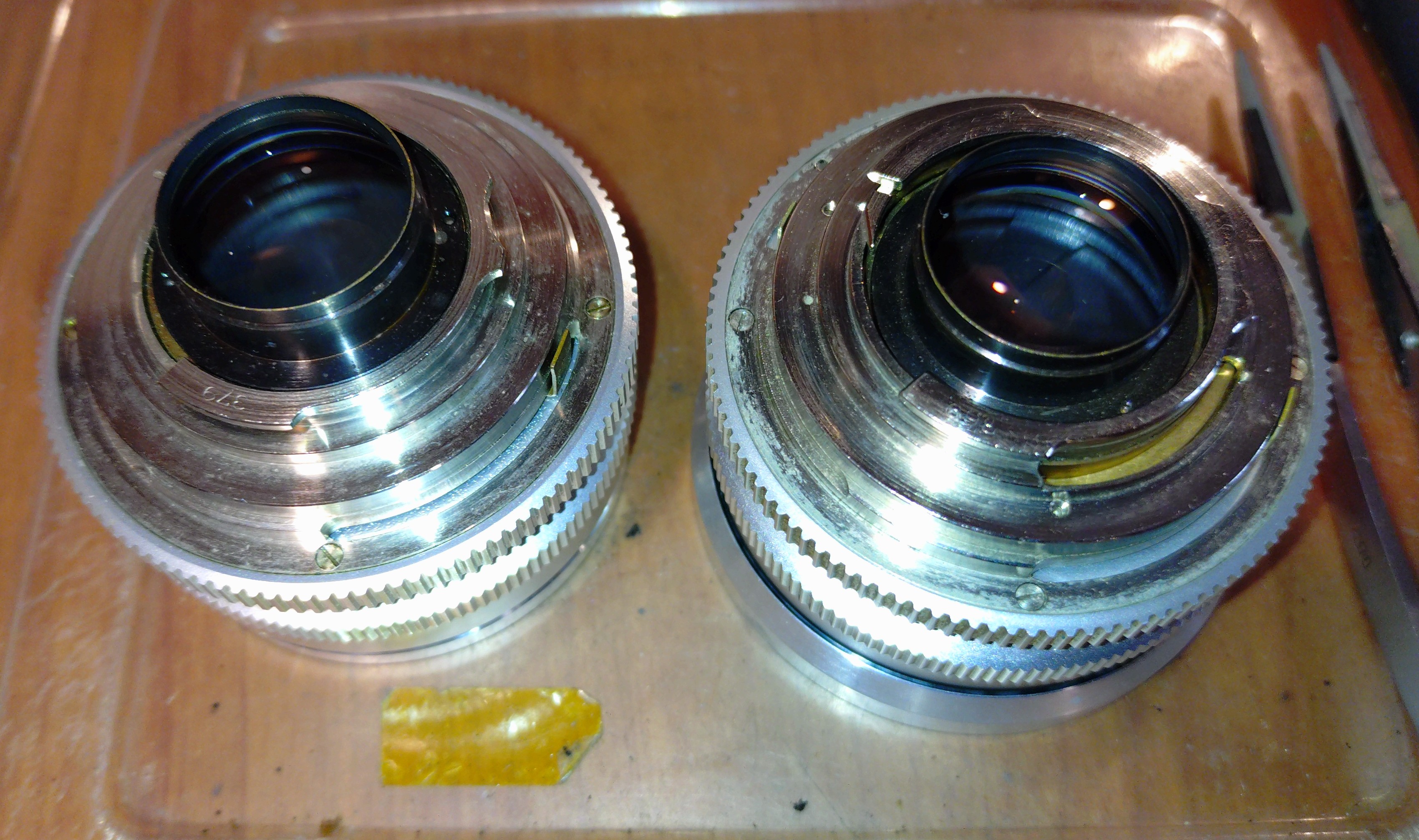

On the mounting side, the thin version has the RF coupling brass ring removed as well :
Both lenes can works on Retina Reflex SLR cameras (S/III/IV), but please don't put on the think Xenon 50/1.9 to any Retina IIIS . They simply don't wort and its possible to damage the coupling pin on the IIIs body (which works for focusing and frame selection)
