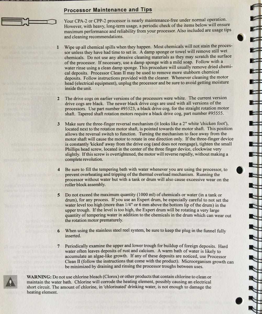

Does anyone have any documentation on proper (user administered) servicing and the interval(s) at which it should be administered for a Jobo CPP2? I have one, I love it, and I'd hate to lose it due to neglect/over-use if there is something I can/should do myself. Shipping it off to Boston for service is something I'd like to keep as a last resort.

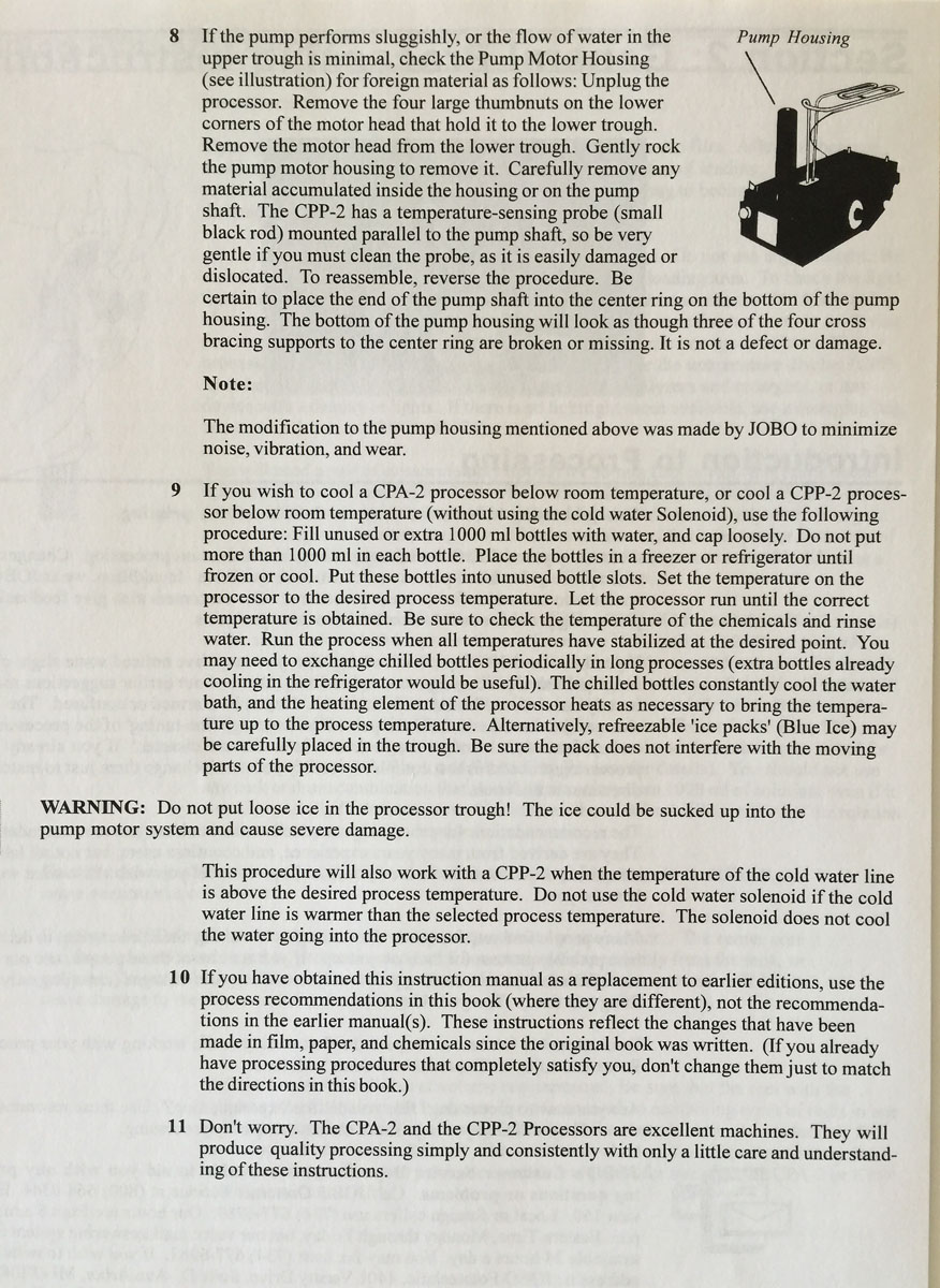

My instruction manual for the CPP2 contains two pages concerning Maintenance & Tips. According to Jobo, these units are relatively maintenance-free under normal operation. I've been running mine for 20 years and have never done anything to it; used it just yesterday. I have attached a couple of snaps of these pages. Hope you find it useful information.
