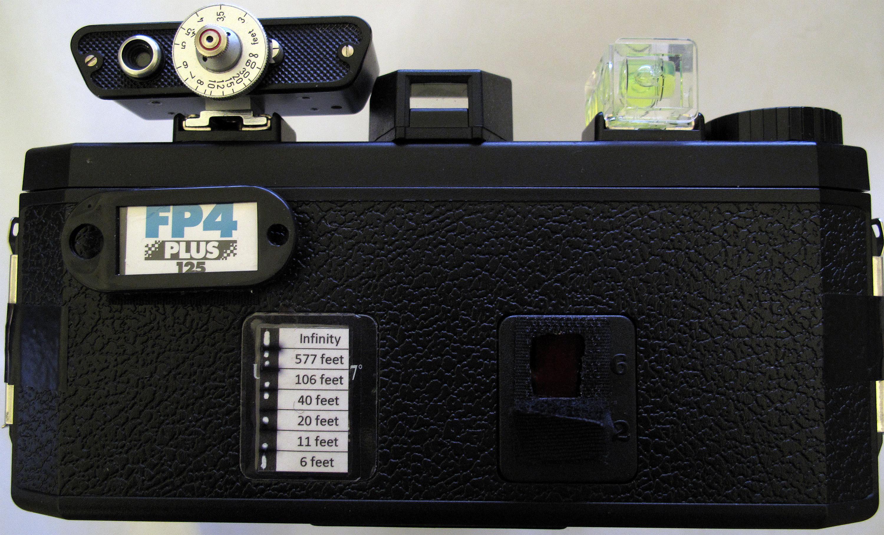

Guilty m'lud! I made and posted that pdf so folks could make their own. It is very easy to do this modification and nothing but hand tools are needed.
The hardest bit is setting up the focus with the helicoid. A spare Fresnel screen from a 6x6 camera makes the job a lot easier. Put the whole lot on a tripod and focus on a landmark that is several miles away for infinity. Then set the focus on various nearer landmarks and paint the helicoid with spots of paint making a note of each one. Then set the focus on things nearby that you can measure the distance with a tape and add some more paint spots to the helicoid. Then use Google Earth to get the distances of those nearer landmarks and make a sheet that lists all the distances against the spot codes and stick the list on the back of the camera.

I like that idea with that velcro cover.
That key-tag... well, holgaloid.
The key tag is held there by Velcro too. I have one for each film I use and just swap them over to suit.
