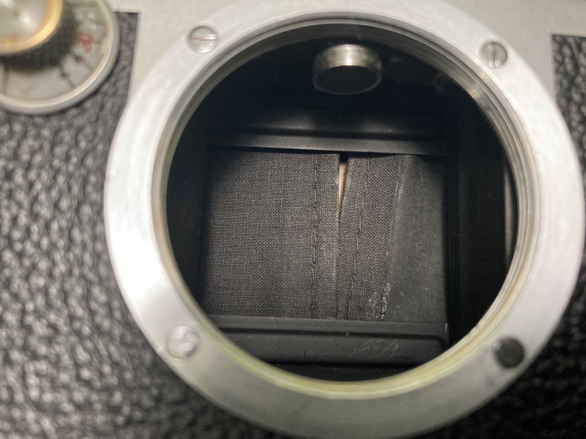

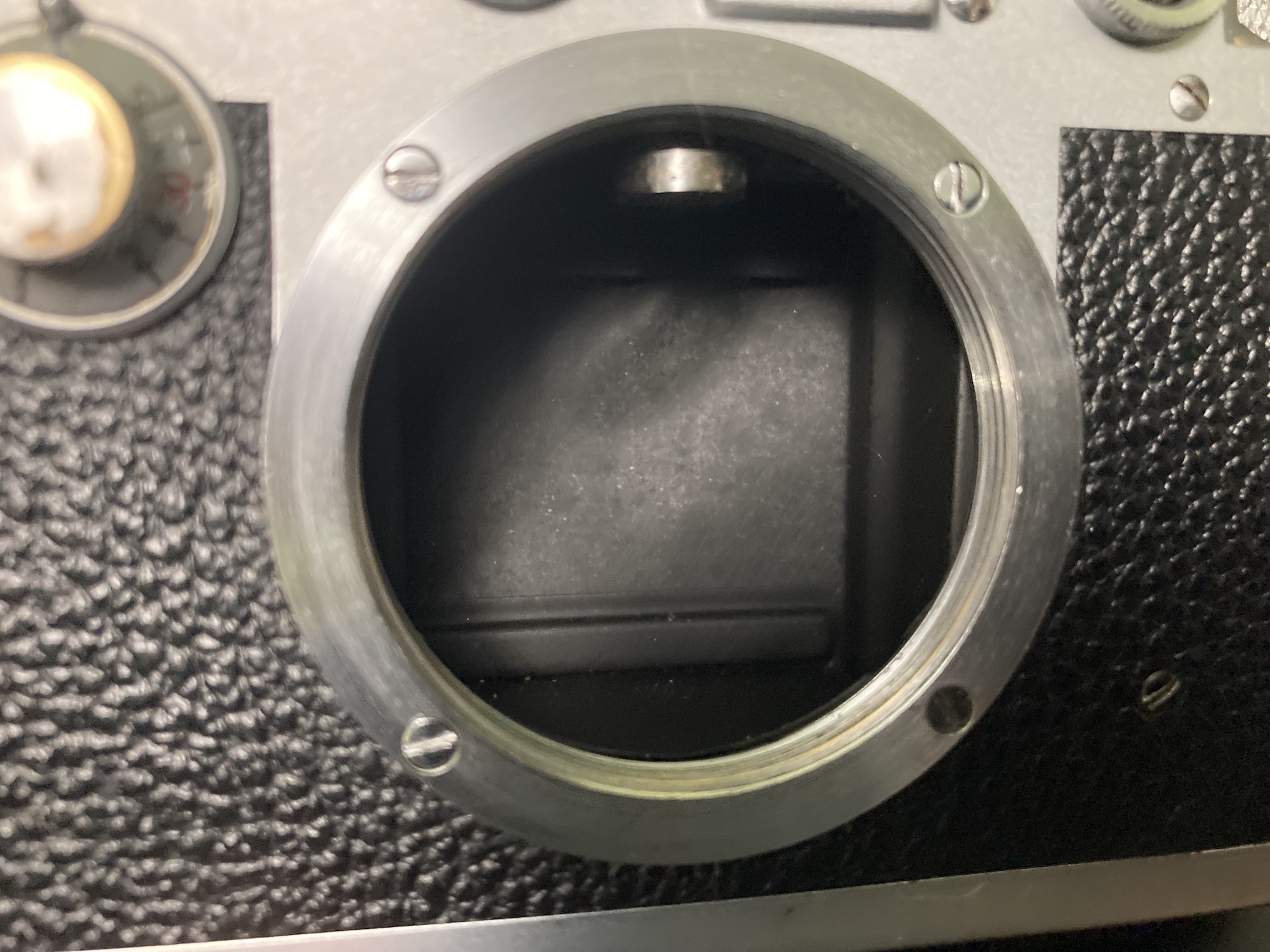

The camera was working fine about a week ago when I first got it. I worked it through all of the shutter speeds, including the slow ones, when I first got it home. Watching through the lens opening at that time, everything looked like it was working and moving properly. I loaded it with a test roll of film and followed the instructions for cutting the film leader and had taken around 15 pics without incident.
I took it out to do the infinity adjustment and decided to take more test pics. Problem was, after winding the film, I would press the shutter button, and nothing would happen. I tapped it a couple of times, and then tapped the shutter speed dial, and then the shutter triggered. I went home and kept trying to get it to work properly, but it wouldn't. I attached a couple of pics, and what I think I'm seeing is an issue with the rear curtain.
Now, I looked online, got brave, and took the outer casing off of the camera to have a look inside. I work on watches and clocks as a hobby, so this was only a little daunting. But I didn't see anything obviously amiss. But that's as far as I felt comfortable going today. I almost feel like I could fix this myself, but I don't want to be the cause of further problems. So, I put it back together and set it aside. No extra parts when I was done.
Is there someone, preferably in the US, who's doing CLA work on these cameras? I'll send it overseas if needed, but that adds time away from home.

I think, if you work on watches and successfully got that camera apart and back together, you can probably fix it. It's probably mostly a matter of cleaning the parts (particularly those under the speed dial and the gears attaching to the winder and the gears on the bottom). A watch is far more complicated than a Leica IIIC.
The shutter looks messed up but that may rectify itself once everything is cleaned.
Well, I appreciate the vote of confidence, but keep in mind that all I did was pull the camera's guts out of its case. That's nine screws and no risk of any springs or other things launching themselves up and out of the camera, never to be seen again. That's also removing the base plate, which is three or four screws and only one part that will try to sneak out and away. I ruined a FED 4 a few years ago. I knew less back then, but still feel cautious. The stakes here would be far higher.
I figured out what's up. One of the shutter tape strips has come unglued from the drum. Looks like a piece of film got caught in the works, which has me questioning whether or not I followed the film loading and cutting instructions as well as I thought. Anyway, I'm not going to tear it down any further, so I'll re-assemble it and maybe send it off to YYe.

The piece of film could have been in there for years. It won't hurt to have the rest of the camera cleaned out and verified working properly.
In my experience, Leica-II-type cameras are always full of film chips because the advance is not gentle. It needn'd have been from the film you loaded. Might have just been the shock of the shutter being worked after the camera had been sleeping in a drawer for 40 years that got the curtain tape loose.
