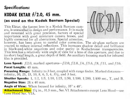

Disconnekt
Jul 24, 2017
531
Inland Empire, CA
Depends on the adapter size. Kodak Series adapter rings, even for the Series VI ones, came in a wiide range of sizes (31.5 to 42mm)
