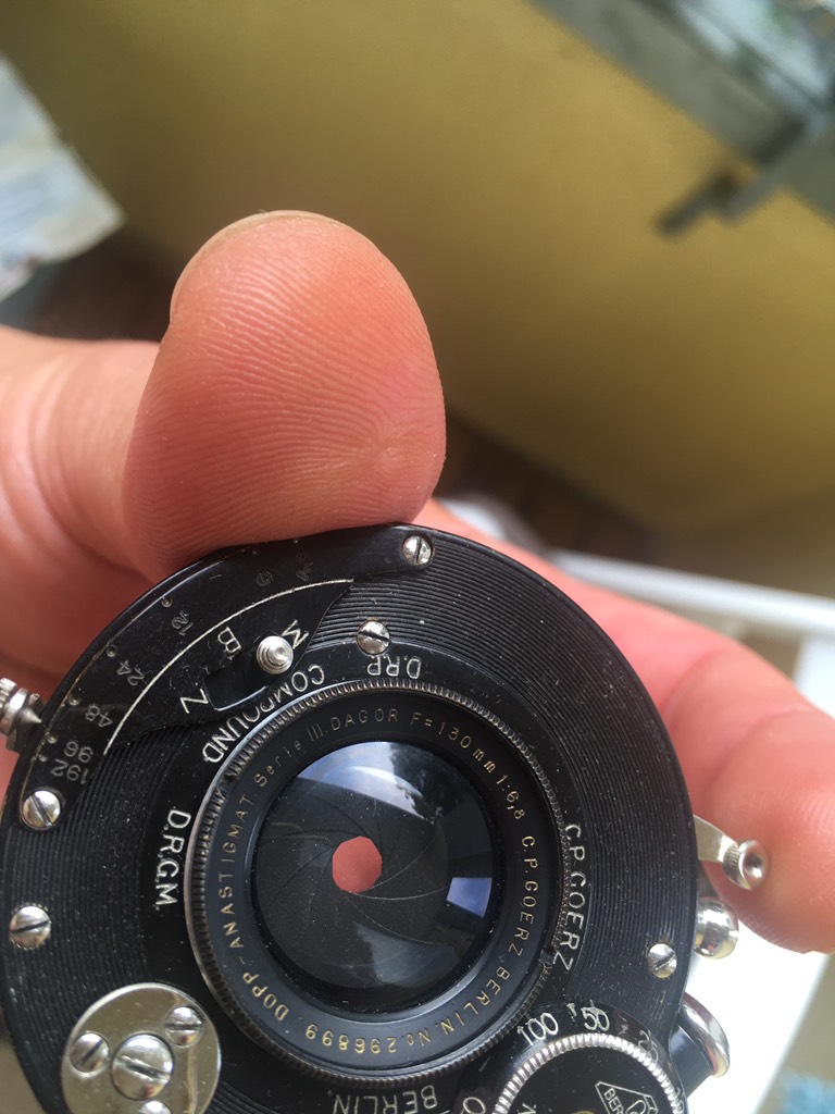

Is it normal that it the assembly comes with f/4.x ...
I got this lens yesterday and the shutter works but not the B and Z

No some German manufacturers used non standard f stops early on, I don't know when Goerz changed but my 1913 120mm f6.8 Dagor uses standard f stops,
That's possibly not the original shutter, the small Compounds were replaced by the Compur in 1912 but Goerz may have had stock, your Dagor is a slightly higher SN than mine (277,xxx). Mine#s also marke I, B & T for the UK market.

Here's the explanation. Not as simple as I first thought.
Still seems odd that the 4.5 is actually f6.8, and the 192 is actually f45, and that the lens itself is marked 1;6.8. I have German lenses with non standard f8 11, 16 etc numbers but they are just in-between the regular number like 6.8, 9, 12, 18, 25 & 36.
Ian
Ian Grant
Aug 2, 2004
23,273
West Midland
I suppose the "No" is a reply to my post just above. But look at the table you posted, first and third columns. Just what i wrote.
Goerz 6 = f/7.7 (f/8, give or take)
Goerz 12 = f/11.13 (f/11)
Goerz 24 = f/16
I meant no to the OP. The B & T don't work if the shutter is cocked
it's very odd that a Dagor from 1913/14 has this old style Goerz aperture scale and by then most Goerz lenses were in Compur shutters, I have a similar aged Dogmar and Goerz-Ihagee both in Compur shutters.as are the two similar aged Tessars. I guess Goerz were using old stock Compouns.
Goerz were selling lenses to other companies it's possible they requested the old style aperture scale. The Goerz system is similar to Dallmeyer's but they switched the modern one in the 1890's.
Ian
Thanks for the table and all the required data are there.

The scale appears to be the old "US" system....
http://throughavintagelens.com/2010/01/the-u-s-f-stop-system/
Except the US system has a different starting point and is based on a Ross British system :D
When you set it to B or Z you don't cock the shutter, but only use the release lever. Maybe you already know that. Interesting aperture settings. :smile:

The shutter may need a bit of service. I can't move the lever to Z and B is not working as it should work.

I have a very old 210mm Dagor with a similar serial number, 293nnn. It is in an odd barrel mount that would have originally been on a focal plane shutter camera (the experts at LFPF helped figure that out). It has similar aperture labeling. The f/6.8 number on the rim is a true f-stop of course. The key to understanding US and Goerz numbers is that both are proportional to 1/aperture area, and thus exposure time. But normalized differently: US 16 = f/16, while Goerz 9 = f/9. Why start at 9? Who knows! Probably they made some f/9 lens and labeled it that way, and the system persisted for a while.

The scale from the Compound in the picture of the OP seems to start at 4.6 which would resemble the f 6.8 according to the list shown above by Ian. To be able to compare the lens to lenses from different makers, it mentiones its biggest aperture as the ratio focal length/entrance pupil. But for practical reasons the scale was designed such that each incremental number would provide half the luminosity - in order to do so f6.8 was converted to 4.6 on the Goerz scale. I therefore guess that the lens from the OP came in its original Compound shutter.
Not sure whether this lens would fit the lenstube of a Compur #0 (which could be had in 4 different tubes: Compur normal 27, 28 and 30mm, Compur wide 25mm:
Here's a picture with my own compound and compur shutters with some measures: https://www.flickr.com/photos/zorki_2007/50244318642/
It should after all the Compur shutter is essentially a Compound with a gear train rather than pneumatic slow speed controller. My120mm Dagor in a Compound does fit a Compur I've just tried, both are the same tube length so spacing remains the same..
Of course we need to clarify that it's the dial set Compurs not later rimset which use different treads. and aren't cross compatible. The Compur #0 Wide has inside tube thread diameter of 28mm, Nornal is 27m m, and the #0 no 1 tube is 25mm. The Compur #1 is 30mm and #1s is 35mm
