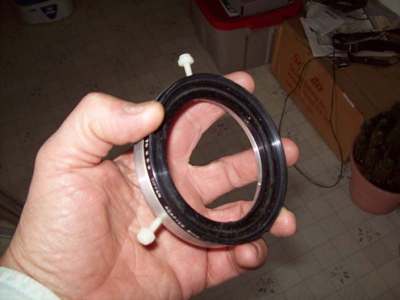

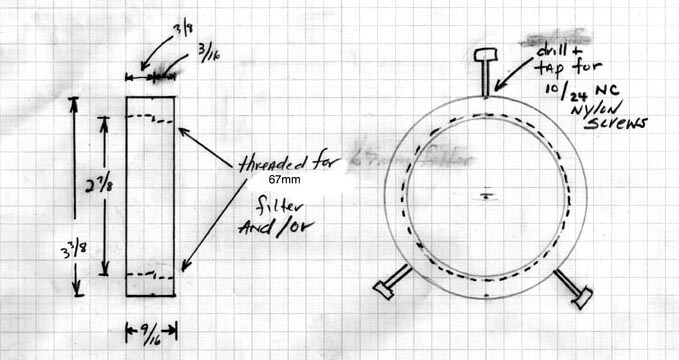

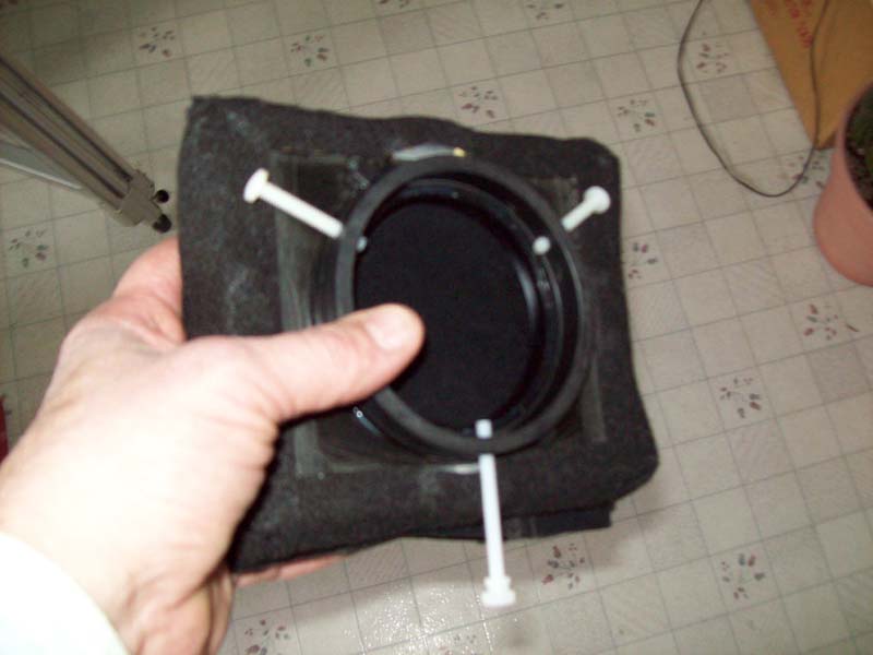

8x10 Format
see photo 7 an older series 9 adapter. I made one which would also use 67mm filters. 8 is the backside view of a series 9 made out of ABS plastic and is also a barn door shade. see 1.
