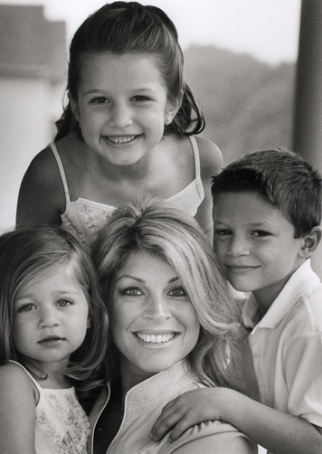

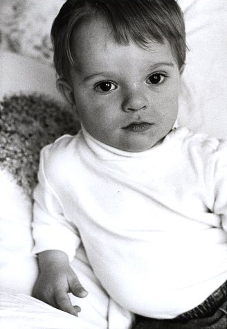

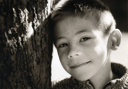

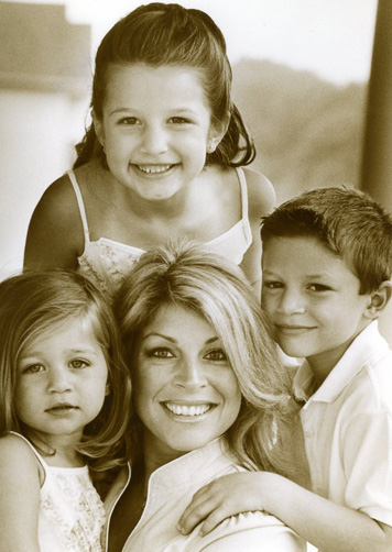

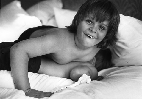

I recently started offering my clients sepia toning as part of my B&W printing business after making some tests with Ilford Multigrade Fiber paper and Forte Polywarmtone fiber paper. In my first test with Kodak Sepia Toner I found that complete bleaching of Ilford takes forever and toning produced a very slightly warmer tone. Forte Polywarmtone produced a very yellow-orange, much fainter look that I didn't like.
In my second test a few weeks later with a new batch of sepia bleach and toner I got what I expected from Ilford Multigrade fiber--beautiful yellowy-brown tones with a little less density and apparent contrast. I figured my first result to be an anomaly and took on my first paid toning job. The results were disatrous!
I fully bleached and toned a print on Ilford MG fiber and the resulting tone was somewhere between brown and PURPLE! I figured the toner was bad from having stored it improperly--maybe a dirty bottle or something--so I mixed up a new batch.
The new batch produced chocolate brown--not a bad look, but not what my client wants. Since then I have tried twice more. Once with the same batch of toner, once with a new batch mixed with distilled water and always get chocolate brown.
Is it a change in the paper? Did I get an old batch of chemicals? Are the planets aligning against me? I've never heard of anyone having such variability in sepia toning!
Take a look for yourself at the samples I'm attaching.
Brett

I can't speak to bleaching and sepia toning, as I don't do it, hopefully someone else can help with that. I did want to suggest you try toning the Polywarmtone right out of the wash in a strong selenium solution, and see if you like that.
